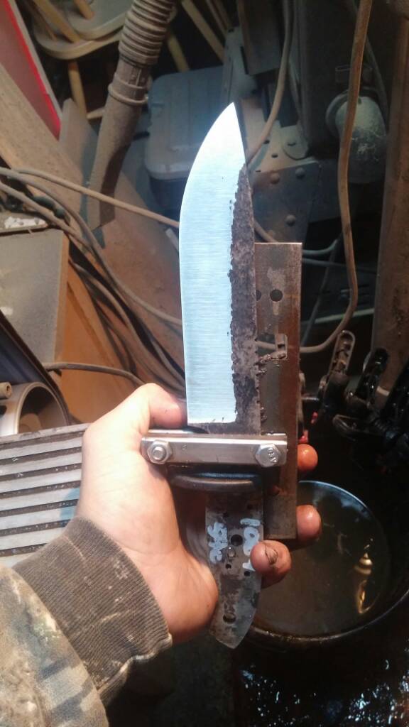

I'm not the best at free handing large blades so I made and use a jig. Basically I put two 1/2" slots in a piece of angle iron and made a clamp out of 1/2" square tubing. This way I can adjust the angle of my plunge lines.
Cleaning this one up this morning after heat treatment.
