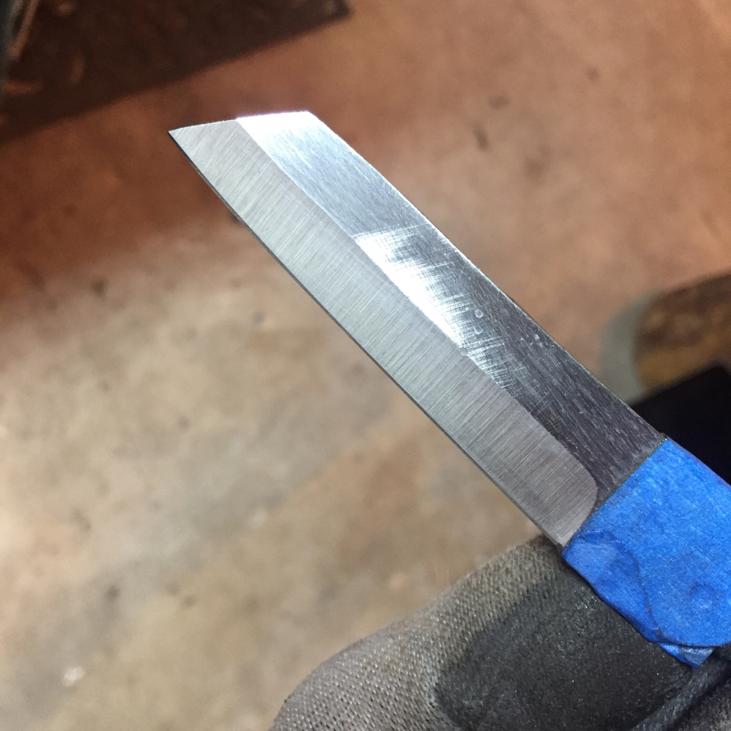

My best grinding starts freehand, Then I switch to a work rest and push stick.
Then I freehand as required. It's generally the fastest and most consistent grind for me.
If I had a consistent design and constant pattern I was making all the time, I would make a fixture for it.
Why not?, why struggle with inconsistencies and wasted time?
Here you go, this was just done in about 3 minutes with a 60 grit Hermes, yes on the work rest with a push stick.
Now I can goto a 120 and freehand consistently If I want since the bevel flat is already defined.
