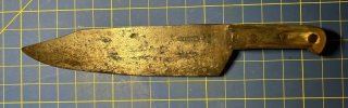

Your reliance on super steels may be overstated. 19th century steel was often very good. With industrialization steel production went to high volume production with a focus on railway tracks and structural steel. It is only recently that we see a return to cutlery steel. But, some of those earlier knives were made from excellent purpose made steel.

It doesn't seem to me that people are making any more "thick knives" now than they did historically. And we have more options today than ever before, for knives of every thickness to choose from. Not sure what the OP's question is really getting at.

and, That actually prove the whole argument better..... Knives were really good back then.
a thick knife, back then was a Hudson Bay.
It was thinner than what we commonly find today with bushcraft knives.
