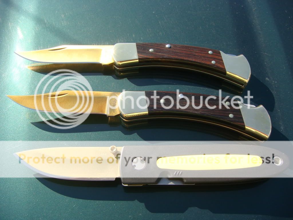

Emerson is not the only manufacturer to do this. My CRKT M16-14FK is a left side chisel grind. As well as others. I don't see the issue or why EQC has been pointed out?
All three of these Buck's are left side chisel grind.

PS the CRKT knives are not chisel round either.
