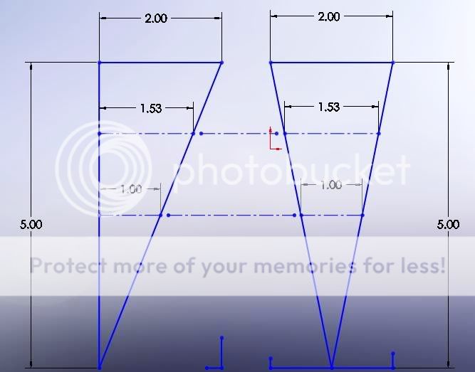

So, to check for myself, I did a rough cross section sketch of a chisel grind and double grind on Solid Works and added dimensions to check the thickness of the cross sections. This is what I came up with:
The cross-sectional thicknesses are the same. So far, to me, cost seems to be the most logical explanation for the chisel grind; one grind vs. two grinds.
Oh, I did check the angles of the grinds and yes, it does appear that the chisel grind really is more acute than the double grind.
Someone needs to learn some math if you think this diagram is correct.
I'm glad I'm not the only one who thinks it's wrong....
I wasn't going to comment because I don't have the geometry skills to explain it properly, but I'm sure the two measurements on the left side of the diagram should be greater than 1.00 and 1.53.
Uh, I was going through and deleting old bookmarks on my computer and found this one. I wouldn't have brought it up again, but I feel the need to defend myself when I'm told that I am wrong.
The diagram is correct. Period. They are two triangles of equal thickness and height that represent the chisel and double ground blades. Thickness measurements were taken at equal heights, and the thicknesses are the same! I did not just draw this up on paint brush. The diagrams were drawn up on a engineering solid modeling program. The program, not me, put all of the dimensions in. Whether or not anyone thinks the numbers should be different does not change that they are not different.
The one thing I did realize as I was looking over this thread is that if the edge bevels are ground at the same angles, the chisel one would have a total angle that is half that of the double bevel, thus making it slice better.
