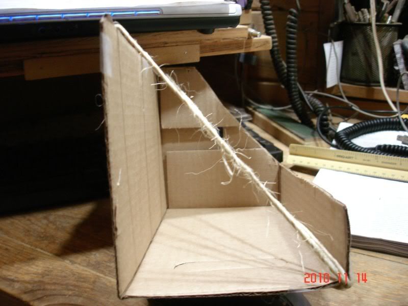

Clay and Frank Hillary are correct. You can model this yourself with string and a box (don't need no stinkin' cad program).
The left side of the box represents the vertical position of the knife. The front right corner represents the axis of the stone. The string shows the angles for three different stone placements on a long blade. When you tilt the box and look down the angles, you can see they are all the same. No matter how far you go down a straight edge, the sharpening angle remains the same. It doesn't change until the blade starts to curve.

BTW, the only thing I see with the string on cardboard model is that it doesn't cover the issue we face in sharpening a certain way. Applying force in the only direction we are allowed to move the stone on the guide rod (along the length of the arm) means you will remove steel from the blade at an angle. Sweeping it along the edge is fine, with movement only from the pivot - that is the force you would have from that picture lining up the string. But if you swing it out 45 degrees and then start scrubbing up and down on the rod you will not be applying force on the same plane, and then you are removing metal at a different angle, just like when working on the curve. The issue we have with doing stuff by hand.
I tried it myself, and you're right! It's only the width of the bevel that changes due to the increased length of the guide arm/stone, not the sharpening angle! Who'd a'thunk it?!? :eek:
The 3D factor had me completely buffaloed! Thanks for show me the light!

According to the visual trig, if a guided system is 1.5" from centerline of spine, and is cutting the edge at 4" away, then it is a 17*ish angle. If you are cutting 5" away from support, the angle is 12*ish. The increase would be even more drastic at lower edge angles.
At a certain point the stone will ride on the top of the sharpened edge due to it's lower angle, and will grind a much wider bevel.
This is why forethought in setup or particular knife designs minimize the problem, as keeping the length of the stone holder arm similar through the length of the blade will keep the angle similiar. Setting up in such a way that the stone holder arm is significantly longer while sharpening the tip will leave a much wider bevel/shallower angle at the tip.
On longer blades with smaller systems, you can watch the angles change at the extreme reach of the system, which is why they must be reset on the longer blades. I would expect the larger systems to have LESS of a problem, because the longer stone holder arm would require a much smaller percentage of change.

No parody, but I do think several of us are discussing different angles, and this could be where a lot of the confusions arises.
There is a difference in the width of the bevel caused by difference in the length from the pivot point to edge. I think this can be seen clearly on any larger blade sharpened without moving the blade in relation to the pivot.
This is why when using the EdgePro, it's advised to always sharpen over the table, turning the knife so the stone arm is at 90 degrees to the edge.
