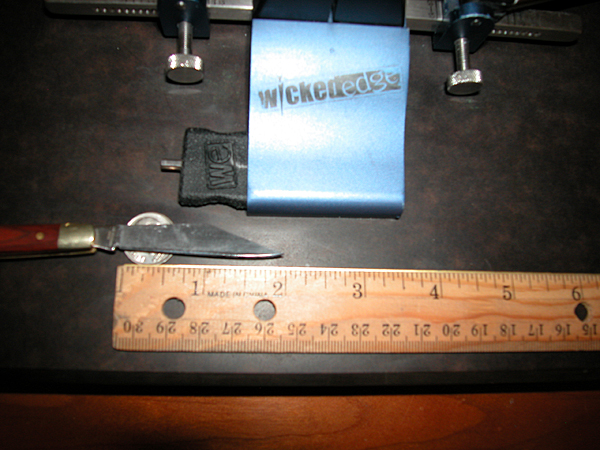

The smaller knives work well. There is some limitation to the angle because of the narrowness of the blades. These pics show a fairly small blade with a 17.2° angle:
Clay - that angle indicator is pretty cool, I can see a bunch of applications in other areas but it fits right in with your machine.
