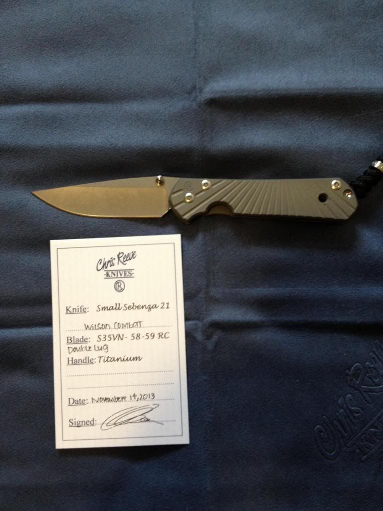

Wicked edge headed my way! Along with my small seb 21

I don't have a WE but do have an Edge Pro. For a small 21 I'd think it's much easier to sharpen on a WE since you can clamp it. On a EP the lug gives you fits as you can't get an exact hold on either side. A part of me almost thinks Sebenzas look better without a mirror edge. I like my mirror edges, but to me a medium grit non polished edge looks better than a half done mirrored edge with a lot of scratches left behind that really stand out.

I'm not the hugest fan of the convex edges that comes on Sebenzas, but I do like the mostly consistent bevel with a semi polish they put on from heel to tip whereas if I'm sharpening, that bevel is going to widen a decent bit as it approaches the tip. In some ways, widens more than I like since I don't like a huge secondary bevel, but I don't know if this issue is less prevalent using a WE. The polish CRK puts on reminds me of the same polish I used to get using a sharpmaker through the ultra fine rods and then a Knivesplus strop. I was once (and somewhat still am) big time into mirror edges, but somehow the factory polish and bevel width suits my fancy a little more on the Sebenza. However my tastes have been known to change.
