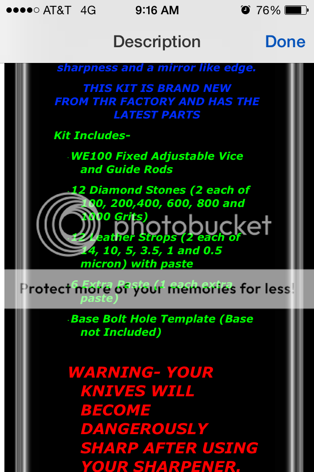

This is the kit I bought, I saved 30 bucks by making my own base at work today!
I bought the same kit last week and also ordered the ultra/extra coarse stones, a wicked edge case and the paper stone base. Debating about buying the upgrade arms and the ceramic stones. I just bought a few different blade shaped Smith and Wesson knives to practice on before I touch up my Sebenza's.

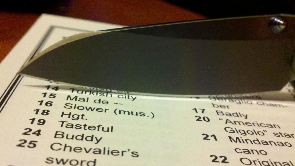

This was 20* angle. I only have up to 600 diamonds. I went up to 2000 with sandpaper rubberbanded to the stones. Then a piece of leather with green compound banded to the stone.

That's a beautiful bevel! What's your technique to keep it uniform and avoid a widening towards the tip if I might ask? It looks perfect on that picture.
