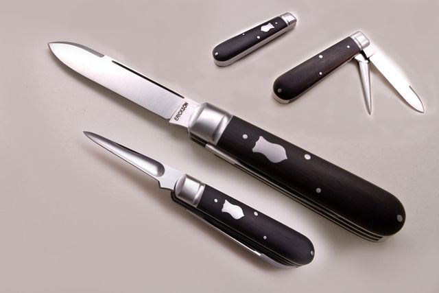

Ken..what is the real meaning of threaded Bolsters, and why are they so different to ...say an ordinary Bolster..Please forgive the very green nature of my question :o :o
When you file/score fine lines across the bolsters, parallel to the edge that meets the handle material, you are adding decorative thread (fine) lines; hence, "threaded" bolsters.
If you grab your rat-tail (round) file, and file in a big rounded convex groove across the bolster, you wind up with Rat-tail bolsters.
Both are decorative, although a rat-tail groove on a large knife can keep you from slipping onto the blade - maybe.
The Eureka Jack posted up above has threaded, rat-tail bolsters - both kinds of groove!
Threaded bolsters on this old Schrade;
Rat-tail bolsters on this Harness Jack.
Note, they are also "spooned"! (just to confuse you!):D That is where the tip is grooved or scooped, sort of resembling a spoon - a bit of a stretch sometimes.

Ken how did you scribe the shield on the bone? Did you use the dental file on the dremel?
