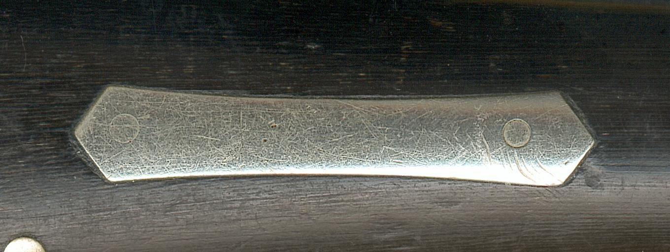

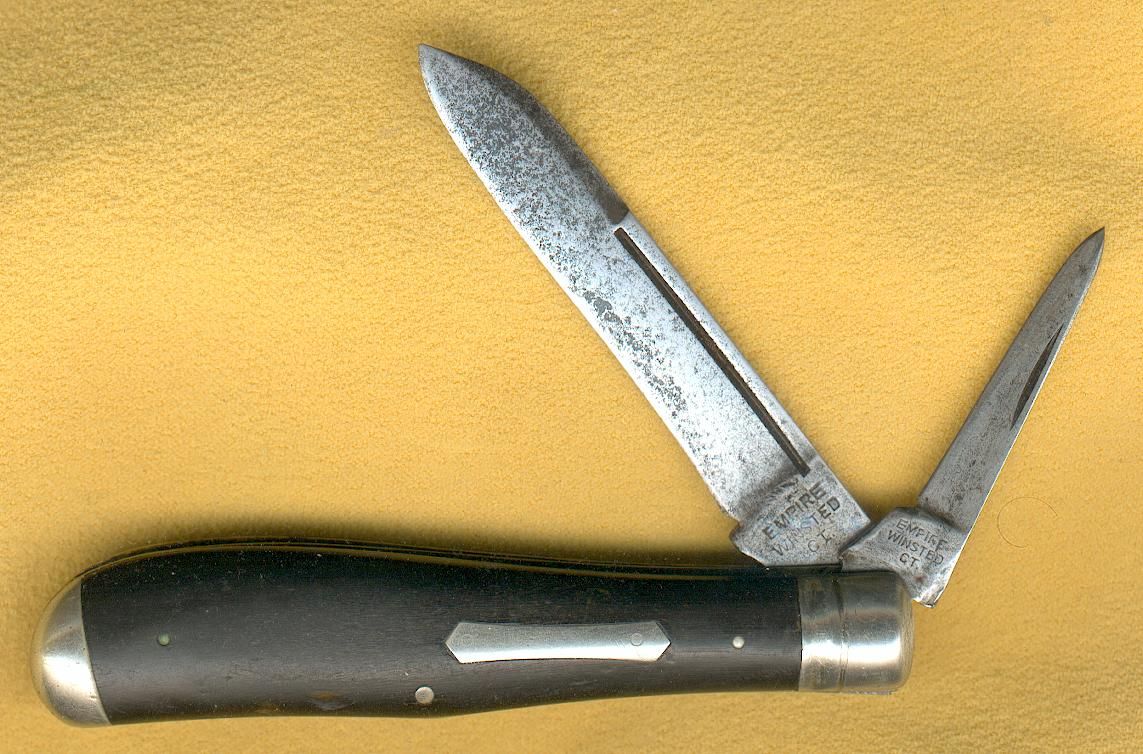

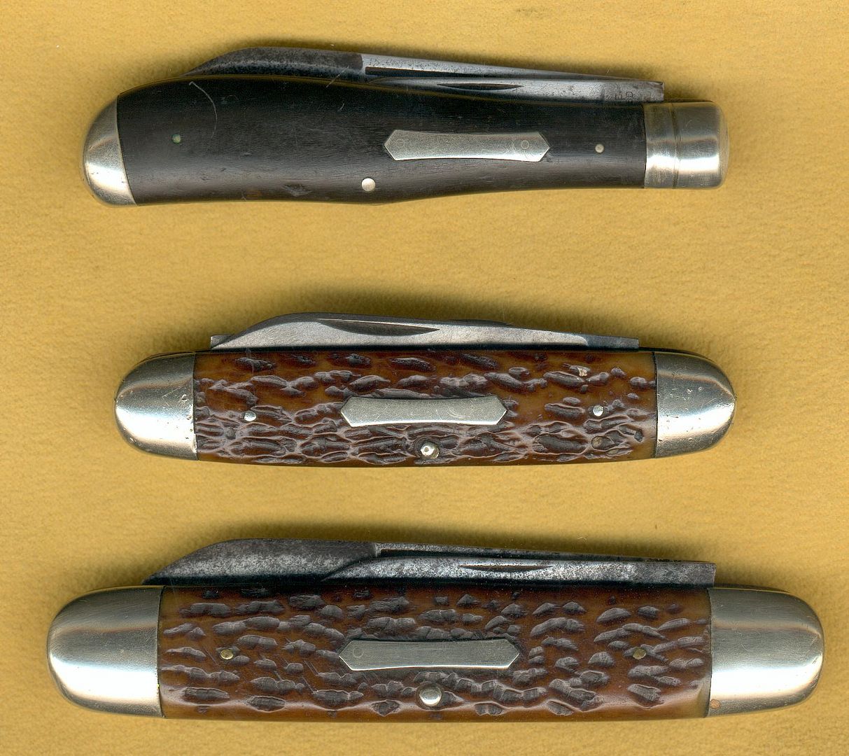

Here are the pics I sent to Ken for the shield. These knives are worn or flawed examples that didn't make it into my display, but I enjoy them for their educational value and character. The Eureka Jack's shield has particularly nice lines, and I believe that's the one that Ken used as a model. Like he says, a few thou makes a big difference!
The Eureka shield:
Charlie...they are still great looking knives-again..the jigged bone always looks great to me, BUT...what is the top knife...the shape is awesome...I like the lines of it...could you possibly display the blades?...and tell me about this knife?
Thank you,
Duncan
With apologies to Ken - a brief intermission:o!
Duncan, the knife you questioned is called a Eureka Jack. Not a common pattern, and this one has high mileage, but it snaps and functions perfectly.
A real pleasant, sculptural shape, and nice in the hand; just right at 3 1/2".
The bolsters are rat-tailed, AND threaded, however lots of pocket wear has softened them somewhat.
