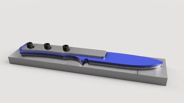

The idea was then to use the pin holes as locators for the next operation, cutting the outside of the blade blank. I can't hold the bar in the vise for the next operation because I need access to the edges of the stock, so I had to make a fixture to locate the bar using the pin holes and to hold it firmly in place using a clamp that's recessed so it doesn't get in the way. Here's the design I came up with for that purpose. The blue part is the blade blank, everything else is the fixture:
I then had to machine the base of the fixture. I made a mistake in the programming of this and tried to drill a 0.625" deep hole without pecking (it was late and I was tired). Ended up breaking my only #7 carbide drill:
https://instagram.com/p/29DEV5CKAF
Once I'd replaced the drill with a regular jobber length HSS #7 drill I drilled the holes like I was supposed to, with pecks! I then machined the ends of the steel bar square and relieved the top surface to the rough profile of the knife to provide clearance when the fixture is in use:
[video=youtube;FVcMKdxVF8U]https://www.youtube.com/watch?v=FVcMKdxVF8U[/video]
This was a bit scary because it was the first time I'd attempted a big cut on the machine. In this case I was using a 3/8" solid carbide endmill to take a cut 0.625" deep and 0.15" wide on the ends of the bar. It's taking me a while to adjust to the idea that the machine is actually fine with taking cuts of this size and even bigger!
I'm not using coolant or cutting oil because I'm used coated carbide tools that are designed to be run dry.

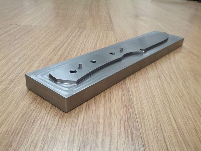

The fixture came out well! I had to sand down some 0.1255" dowel pins to 0.1249" to get them to fit snugly in my drilled holes, but that didn't take too long:
I then machined the clamp that goes at the top of the fixture. This took 3 separate setups because of it's shape, but it wasn't a particularly demanding part in terms of how close the tolerances had to be.
I then clamped everything together with my bar of steel in the middle of the fixture 'sandwich' and setup to start machining the profile of the blade! I was worried about chatter near the tip of the blank as it's relatively unsupported there, but it worked fine in the end! The blank came out well!
This is the first actual prototype for the Resolute 4.5, so it's exciting to finally have it in hand! Pleased with it so far!

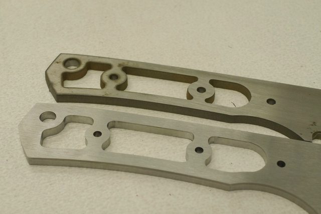

When I was getting blanks done by waterjet I was actually pretty disappointed with the edge finish and the rather loose tolerances. All the pin holes had to be waterjet undersize and then drilled out if I wanted snug fits, same with the lanyard hole. The edges all had to be cleaned up on the belt grinder because they were tapered and because the finish wasn't so great. The choil in particular was a total pain to finish after waterjet.
I actually had a waterjet blank sitting around at the shop (I used to use it as a template) so I shot a side-by-side photo showing the edge finish of waterjet versus milled (waterjet is the top one):
If you click on the images and have a look at them full size, especially near the butt of the blanks you'll see one of the other big differences: no tabs. Grinding off all the tabs left on a waterjet blank was always a pain!
If I had to use either waterjet or laser for cutting blanks I think I would likely choose laser, my experience with waterjet overall was not terribly positive.

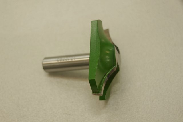

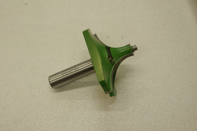

One thing I did get done was to modify the tool that I'm planning to use to put the rounded contour on my handle scales:
This is a 1" radius round-over bit from Lee Valley. It's got carbide cutting edges which should make it hold up pretty well when cutting G10, but makes it a bit of a pain to modify. I went through 2x 36 grit Blaze belts in order to grind enough off the end to get the clearance I need:

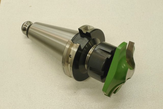

I ground about 1/2" off the end so it won't interfere with my fixture that will hold the handle scales. Here's it is in the toolholder for the machine:
Will be a little interesting to program the toolpaths for that beast as it's not a standard shape, probably a bit of trial and error will be required.
-Aaron
I agree. Waterjet is really more a roughing process. There is no comparison to the accuracy and finish of a fine milled surface. And your mill appears to be working well.
