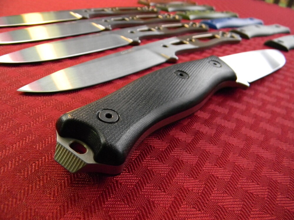

WIP: Designing and building the new Resolute with the help of CNC.
Why don't you put some kind of torque or Allen bolt with a male and female end that threads together similar to Corbys that can be recessed in the g10, then you could just throw the scales on when someone makes an order. Something like this
This one is by Nathanthemachinist. That dude does some sick knives and I believe he uses a lot of cnc. I dunno maybe I am missing something that makes that option not viable.
It has been really fun and educational watching you progress here, on YouTube and Instagram. Keep up the updates and God bless!
I think another idea would be to put a flat along the sides of the handles so that you could machine the corbies flush without worrying about the curve of the handle, but I think that might be a looks/ergonomics compromise you're not willing to make.
That would work for sure, as you guessed though I really don't want to change the look or feel of the handle!
I could certainly do that... The reason I don't is that my knives were designed with the flush pins in mind, and I really like the look overall. Perhaps a future model will use torx bolts, but for the Resolute I really want to stick with flush pins.
I see I see. I do like the look as well, what part of Canada are you in? I lived in Vancouver for a couple years.
Just because this thread seems to be conducive to sketches :D here's to clarify my other idea. Handle contouring would be left until after the scale slabs are glued up. Main problem I see would be the carbide router bit having to cut the Corbies, which could maybe be mitigated by trimming them with an end mill before hitting out with the router bit.
I'd be fine to contour the handles with a ballnose rather than the big radus cutter to avoid the issue with cutting the corby bolts...
It's definitely something I would like to pursue further!
