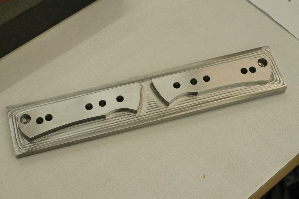

Today I worked on the fixturing and toolpaths for my handle scales! The fixture making went well, I used it as an opportunity to run some more aggressive toolpaths, and boy did they ever make a mess of the shop!

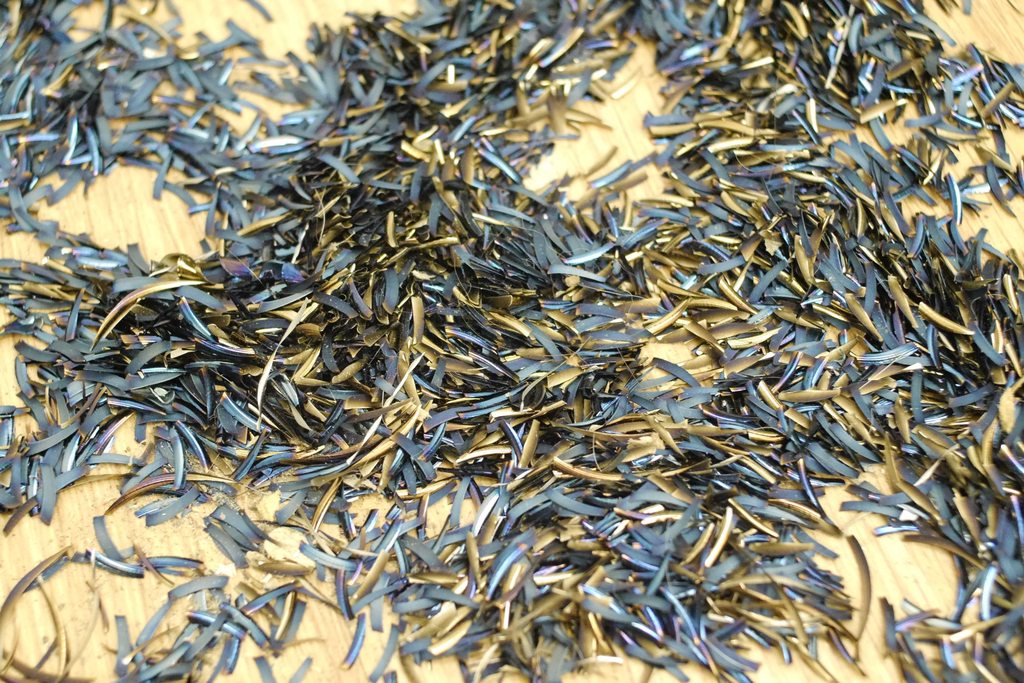

I was cutting some 1018 bar stock for the fixture using a 3/8" variable flute endmill running at 6,787RPM. The cut was 0.625" deep and 0.1" wide at 60 inches per minute. It fired a rooster tail of chips clear across my shop! The High Speed Machining toolpaths are very quick and effective (and easy on tools) but if I'm going to keep using them I'm going to need an enclosure for the machine ASAP!
At least it made very pretty chips:
The fixture itself is fairly simple in this case, just a relieved top surface and some bolt holes:

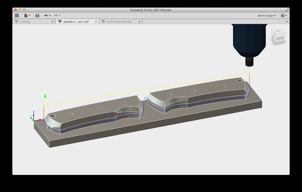

The toolpath for the handle scales is turning out to be a bit trickier than I anticipated. Fusion's CAM didn't want to treat any of the large angled cuts as chamfers. After battling it for a bit I ended up programming them as 2D contours with my chamfer mill pretending to be an endmill. This should give me nice clean chamfer all cut in a single pass that will look exactly like the ones I do by hand on the grinder (which is very important to me). Here's what the model looked like that I used for the chamfering program:
Next I'll be programming a 3D roughing toolpath over the top of the handle scales, then finally a pass with the big 1" radius cutter to get the exact handle shape I want. When they're done they should look exactly like the ones I make by hand, which is the primary goal!

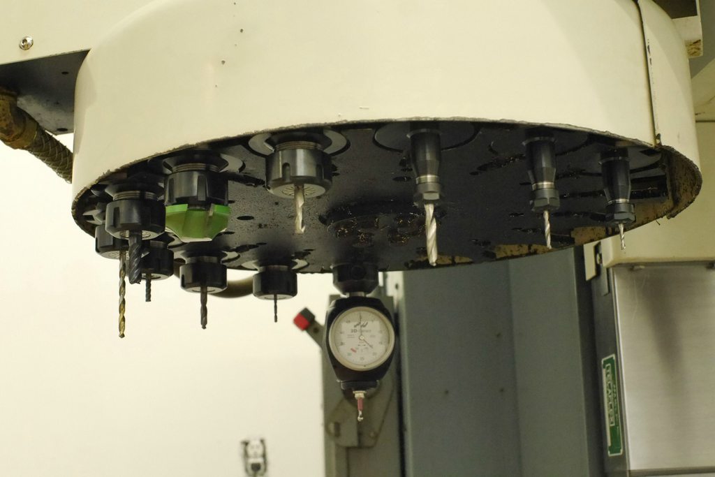

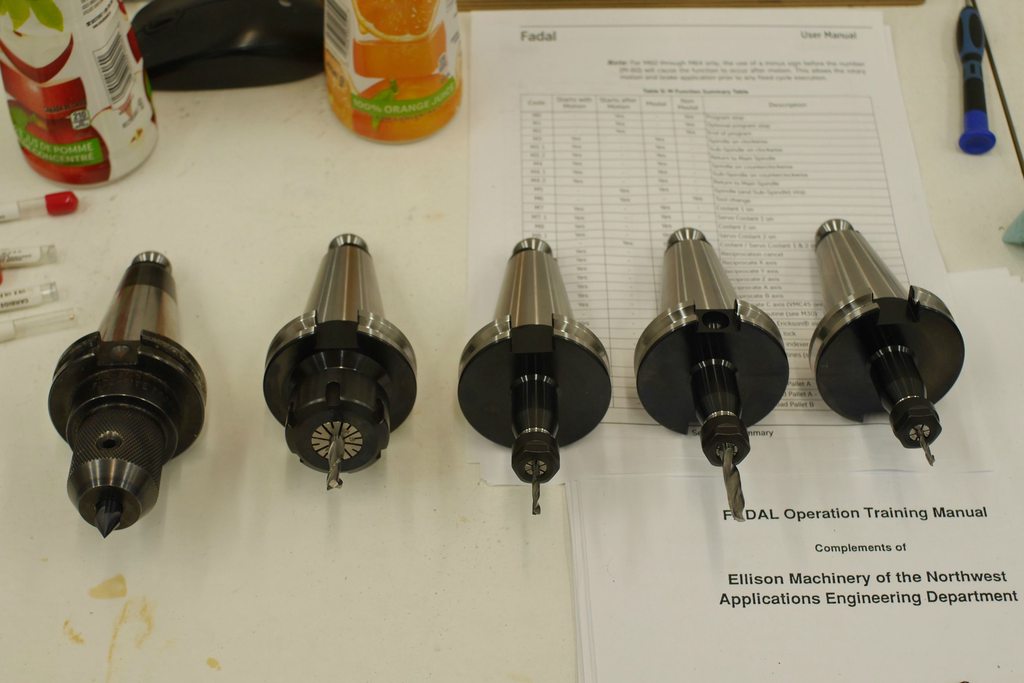

I had to load a bunch more tools into the machine today, I need to keep all my tools for G10 separated from my steel cutting tools as G10 dulls tools very quickly. My toolchanger is nearly full at this point! 12 out of 16 spots full of tools:
