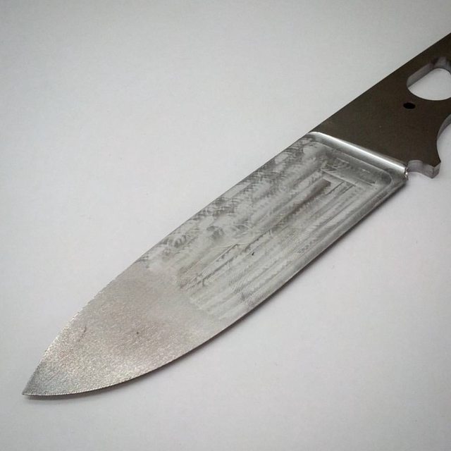

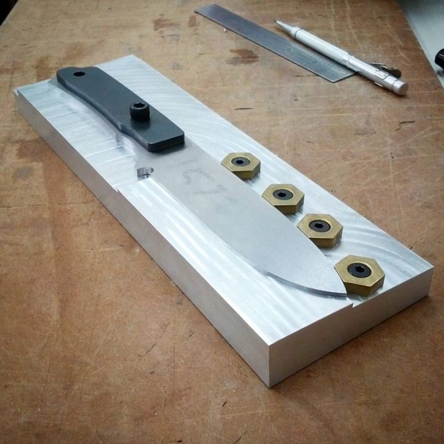

The CNC side of this still has a long way to go.. The new fixtures that I'm using for surfacing the blade bevel are working, but need some further tweaking and refinement.
The fixture:
The result:
I'm getting close enough now with the surfacing that just a little bit of hand sanding is enough to clean things up! Really nice to be able to approach it that way and to be able to avoid the belt grinder for that task as it greatly reduces the chance of mistakes.

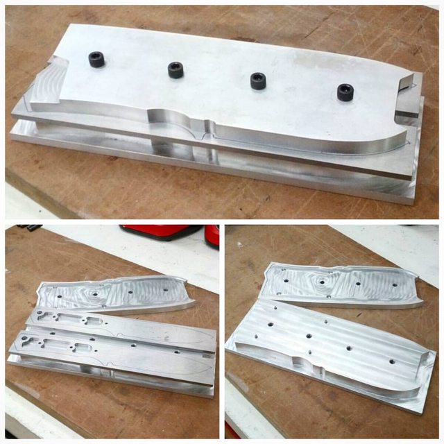

I've also come up with a design for a fixture plate that will let me load all my operations for the blade onto the machine in one shot... I think that getting a completed blade off the machine every cycle will really make the process nicer, as opposed to doing single operations in batches. Much less standing in front of the machine, and I will also be finishing a part by hand every cycle as well, which will mean that problems will get picked up much quicker!
