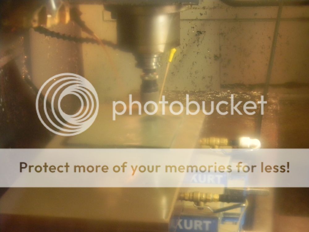

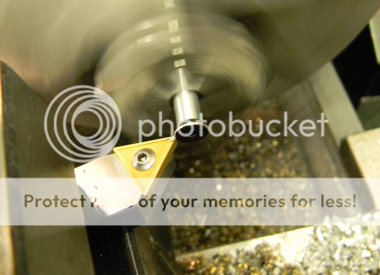

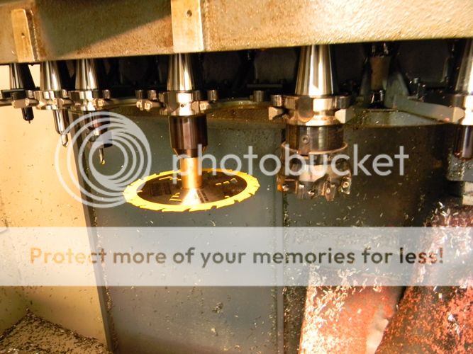

Here's something you don't see in a machine shop very often:
101.jpg~original
A wood cutting saw blade in the carousel.

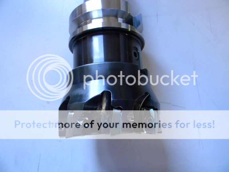

The cutter next to it is this guy:
102.jpg~original
I used to use a chisel ground fly cutter for flattening wood but I found these and they're the best. The cutting edge is very acute, there is a lot of clearance and the edge is quite sharp and the whole insert is coated with "diamond like carbon" so it stays sharp in abrasive woods like ironwood. This setup cuts clean without tearing the wood or burnishing it where it won't take epoxy as well.
103.jpg~original
104.jpg~original

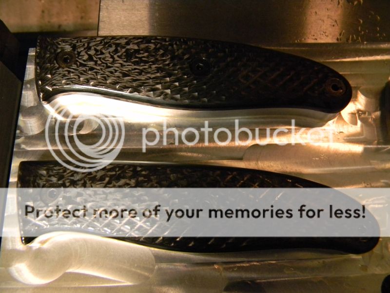

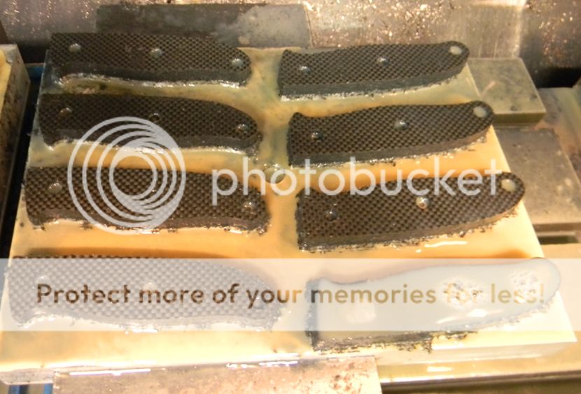

Then a vacuum fixture to start processing the G10.
105.jpg~original
That sheet looks like it's just sitting there, but it would take a team of horses to move it.

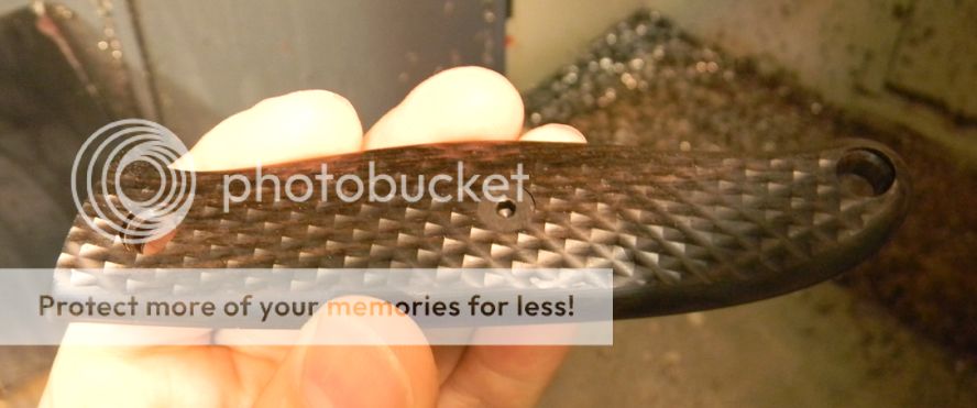

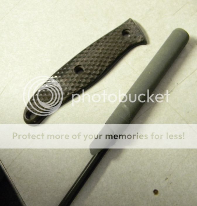

Some carbon fiber. I hate carbon fiber.
106.jpg~original
pretty interesting stuff though
107.jpg~original

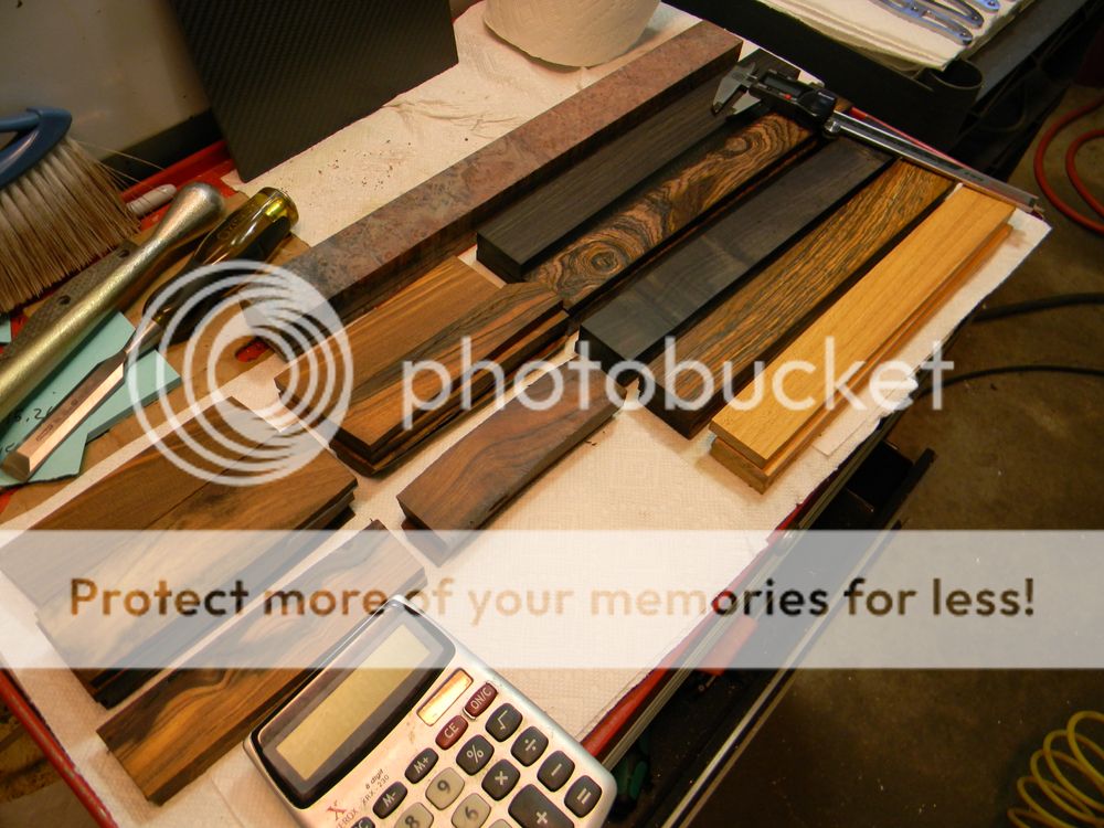

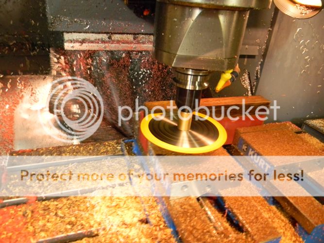

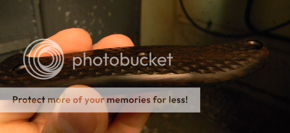

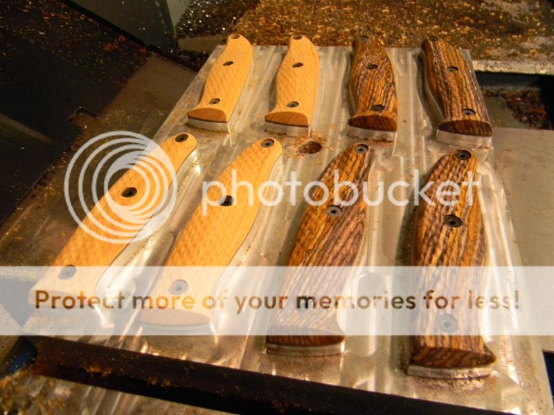

Wood, which has its own challenges, is rewarding to work with. Every piece is unique.
108.jpg~original
109.jpg~original
So interesting Nathan! I'm really enjoying this thread and also being let in on your processes and talents. Thank you for the update. Mike
Learning to do a good job machining wood was a learning curve for me but with the right cutters and the right approach it's pretty reliable now.

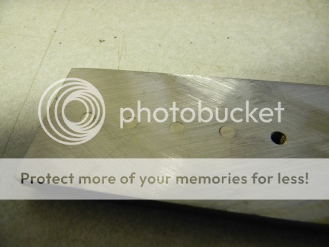

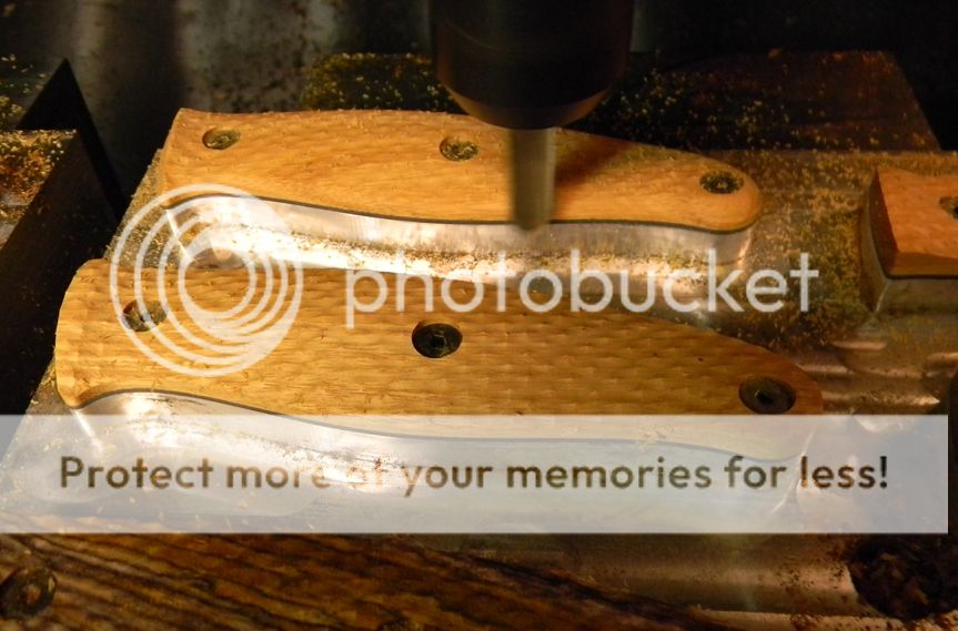

I wouldn't go through the trouble for just one or two sets of scales, but when you're doing a batch there is a tendency to simplify the design of the scales. This approach gives me the design I envisioned on every set, but it is time consuming so it ties up a machine for quite a while.

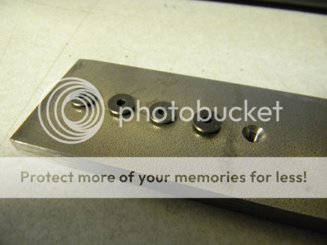

The scales are held on pins with fasteners. Everything is a tight fit so they can go on and off and fall into the same spot without a lot a slop. Most people using this attachment technique use a countersunk hole and a flat head screw. Of course the screw can't fill the countersink completely so you get what I consider to be a little bit of a sloppy transition so what I do is make a counterbore rather than a countersink and then mill the 82 degree included angle for the countersink at the bottom of that bore with a special little V mill.
114b.jpg~original
It's a little cleaner but it requires more accuracy in the fastener than you get out of the box so I turn all the screw heads down a few thou to .310 so they'll be the same head diameter.
115.jpg~original
This, in my opinion, gives it a little bit cleaner more buttoned up appearance.

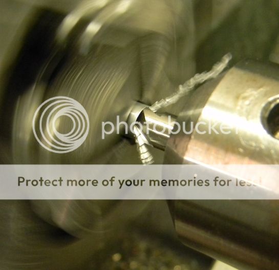

I like to use black screws on my tactical knives but regular black oxide screws rust with a little bit of hand sweat. I've found black oxide stainless screws but the length selection is not very good so most of the time I have to grind them down to size with a fixture like this:
118.jpg~original
119.jpg~original
There you go, more detail about screws that any sane person could possibly care about.

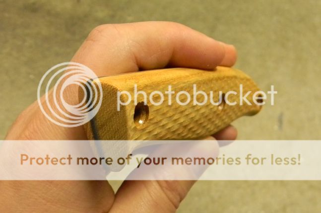

After tumble some of the fancier knives get a nice hand grind to dress them up a bit.
The wooden scales get nitpicked over and then buffed
122.jpg~original

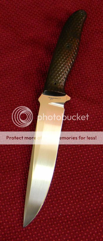

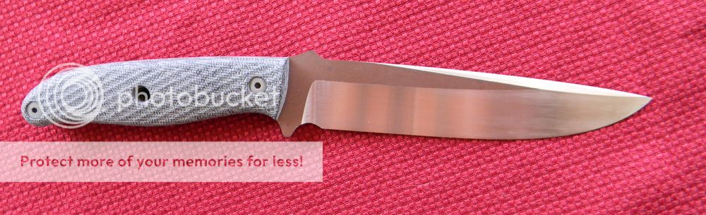

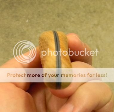

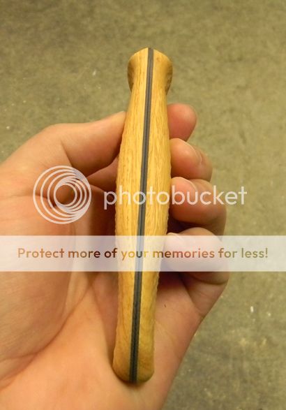

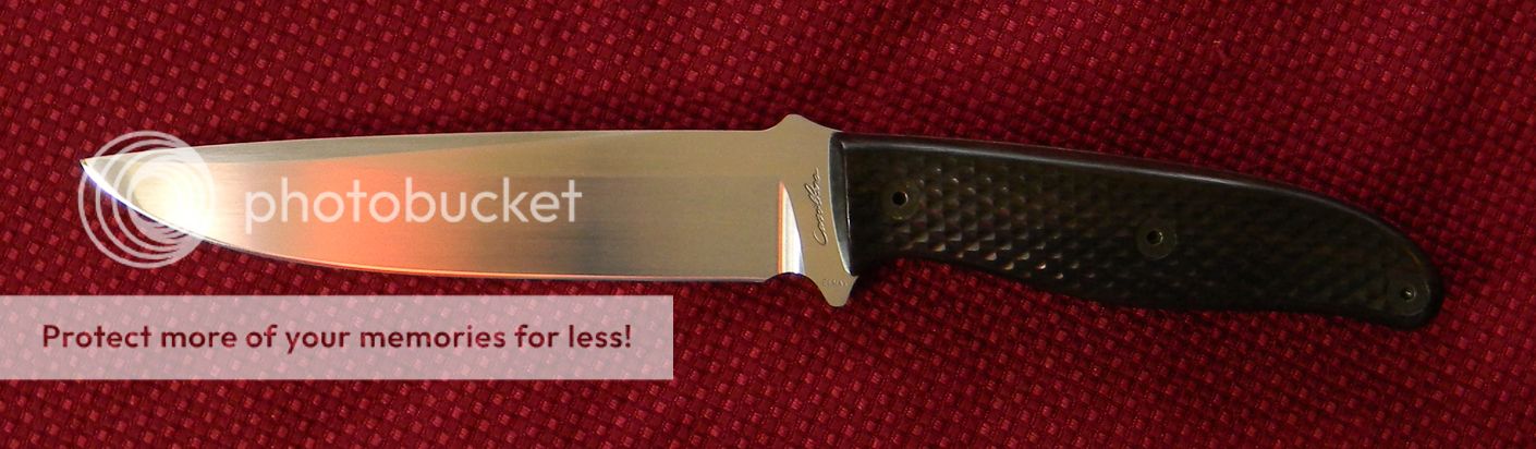

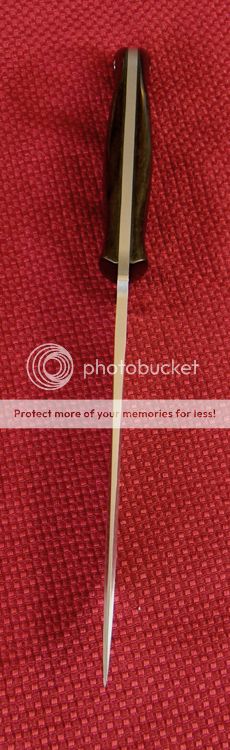

Which leads me to the finished, final knife.
money shot:
2.jpg~original
3.jpg~original
And this is where this WIP started. It is interesting to me to compare the two
1.jpg~original
