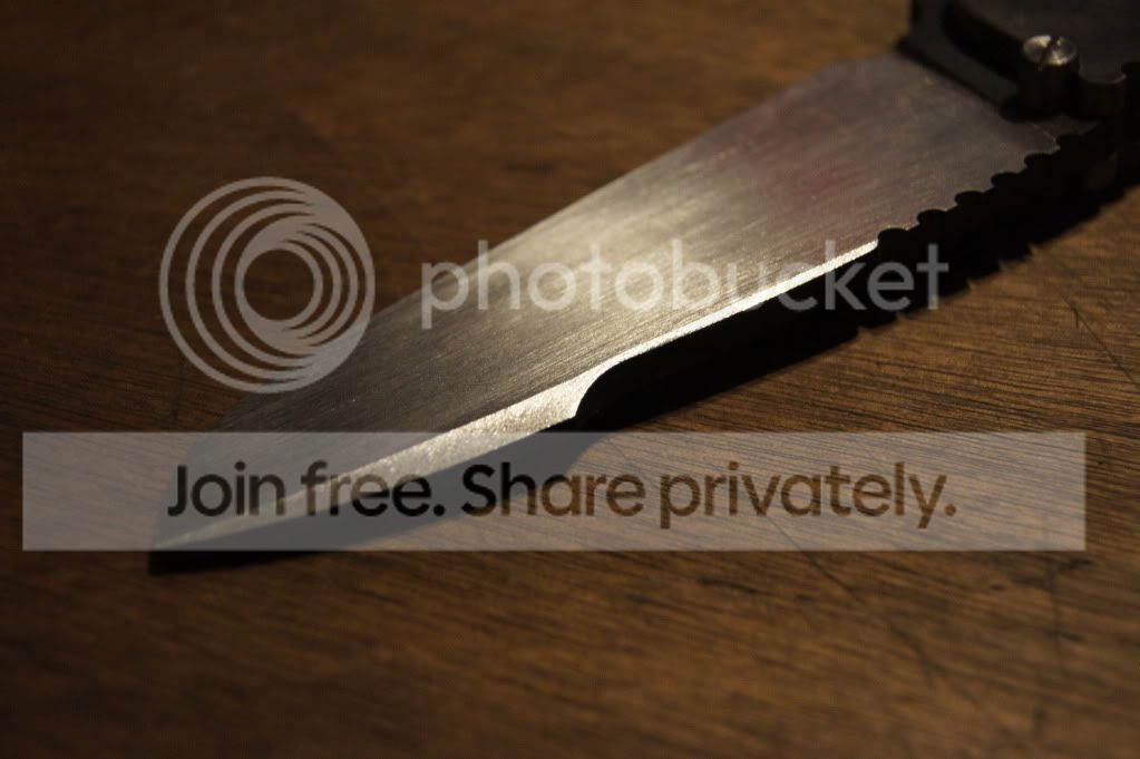

William, I've been following along, and I wish you good fortune on your venture. Just a thought though, I think your blade would look a lot better if your bevel didn't break the spine. Bring it up, leave 1/8th to 1/16th space to the spine. Gives a clean, professional look in my opinion. As I said, just a thought...
Thanks for the advice! Right now I'm experimenting with the swedge and will consider your advice.
I think you are on track. A swedge is needed on a blade that think. Some examples to consider are classic sheffield bowies, where the swedge and the grind meet at the tip, or a Randall blade, same thing. A bit difficult to do, but when done right they are a beautiful sight.
EXACTLY it does take some practice but makes a world of differnce and shows you know what your doing.

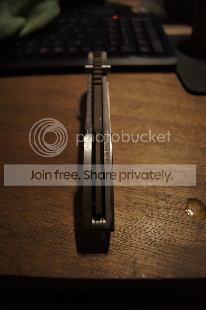

Slapped the blade in my vice and did some draw filing on the main bevels to get them true flat and work out any "chatter" in the rough grind. Next I went back to the grinder with a 120 grit ceramic and roughed out the swedge. I liked the look but couldn't help myself and ran the false edge all the way up the spine to the gimping. I really like the 1/32" line it carves on the spine. What do you guys think?
