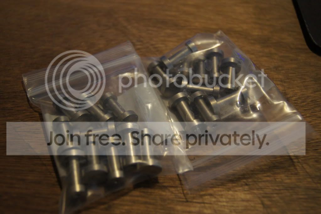

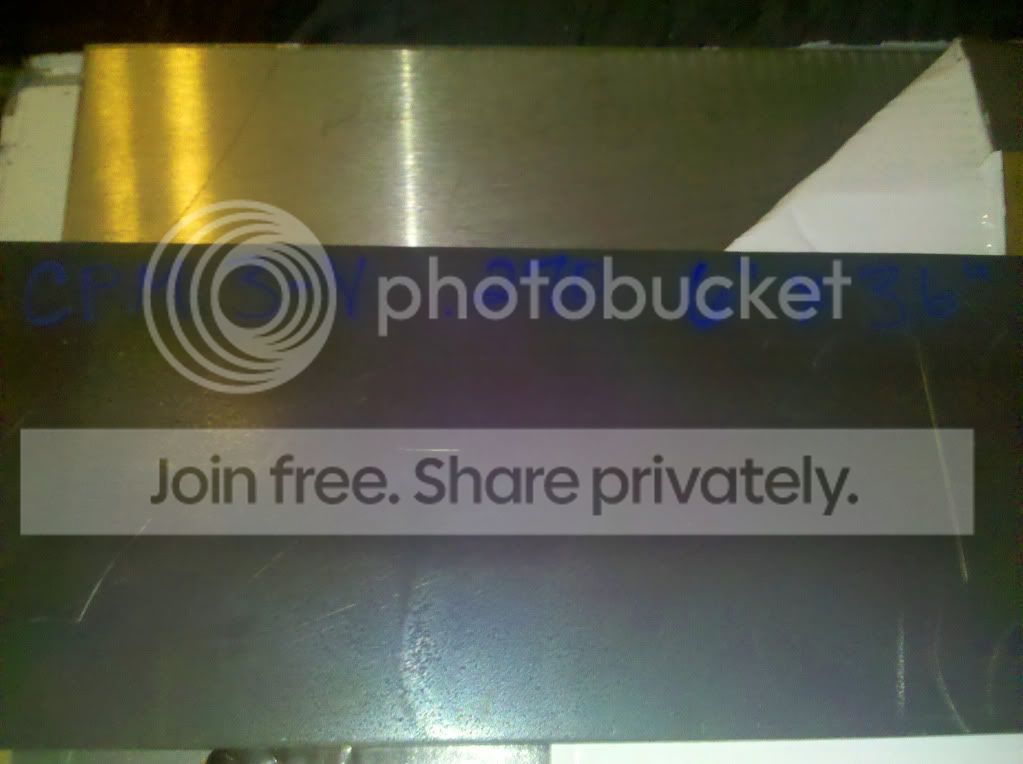

Thank you everyone for being patient! I will have pictures up of my grinds after I get my camera back tomorrow. I have received the CPM-3V from Aldo in .270"x6"x36" AND I got the titanium from American Metal Xchange in .187"x12"x36 so the supplies are finally coming together! The hardware from AKS should be here any day now...

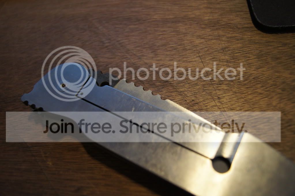

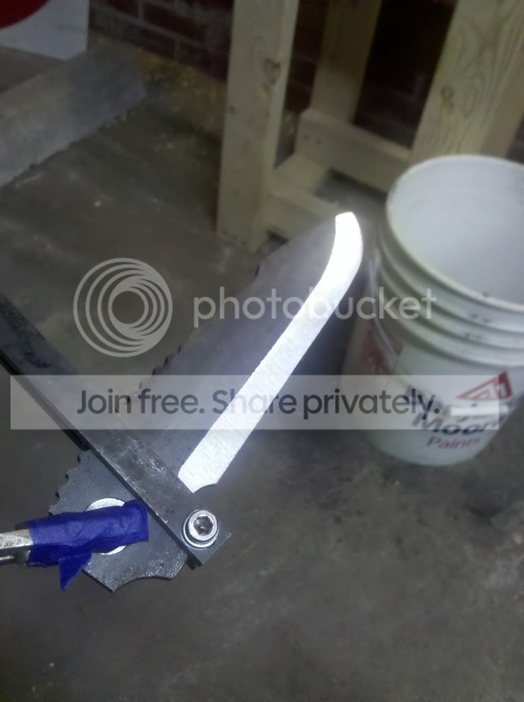

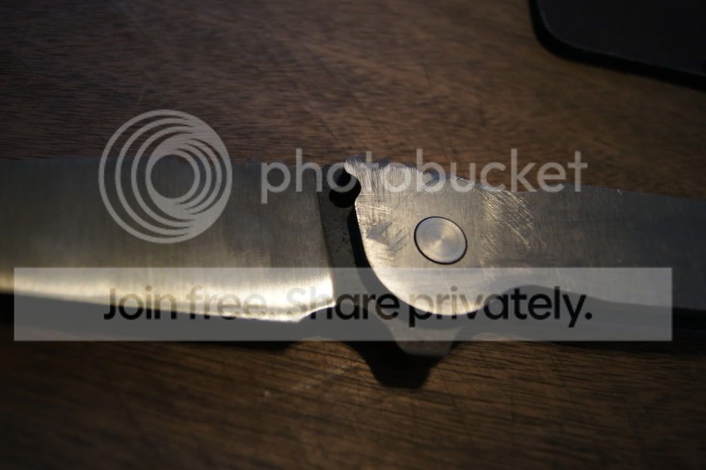

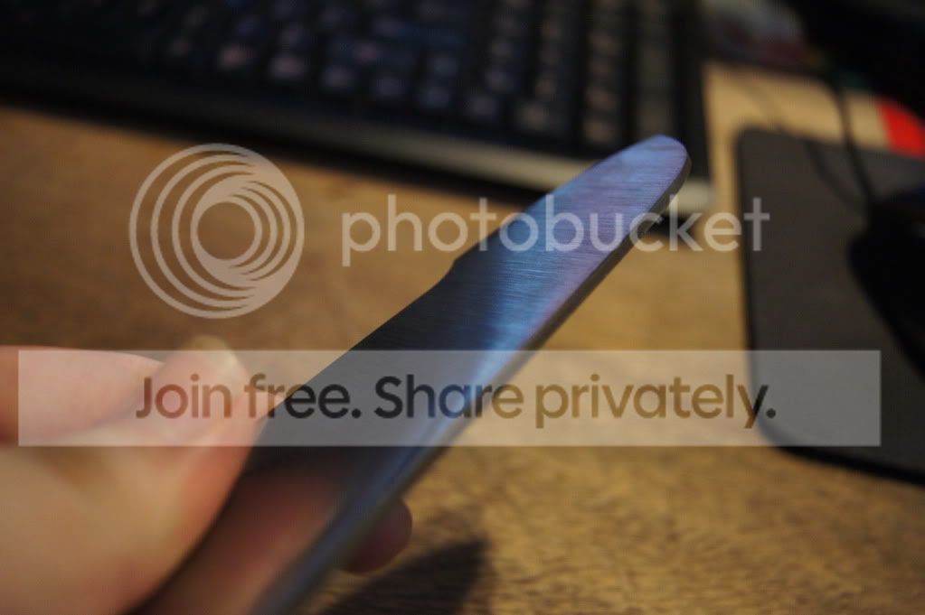

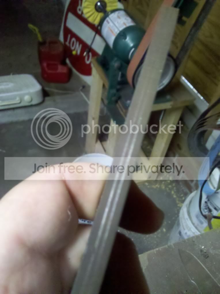

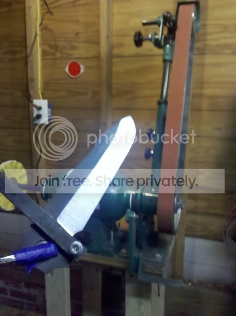

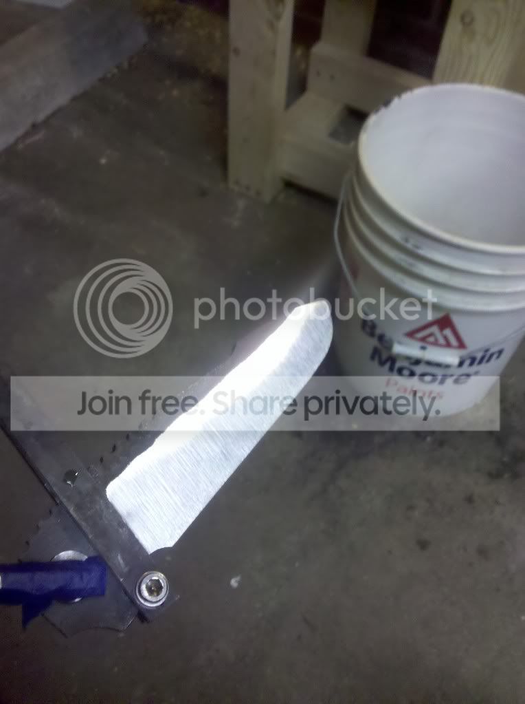

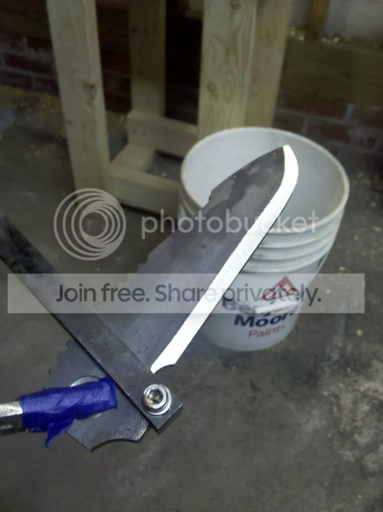

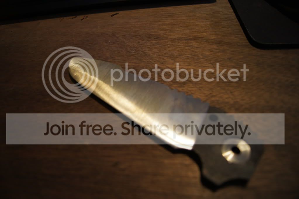

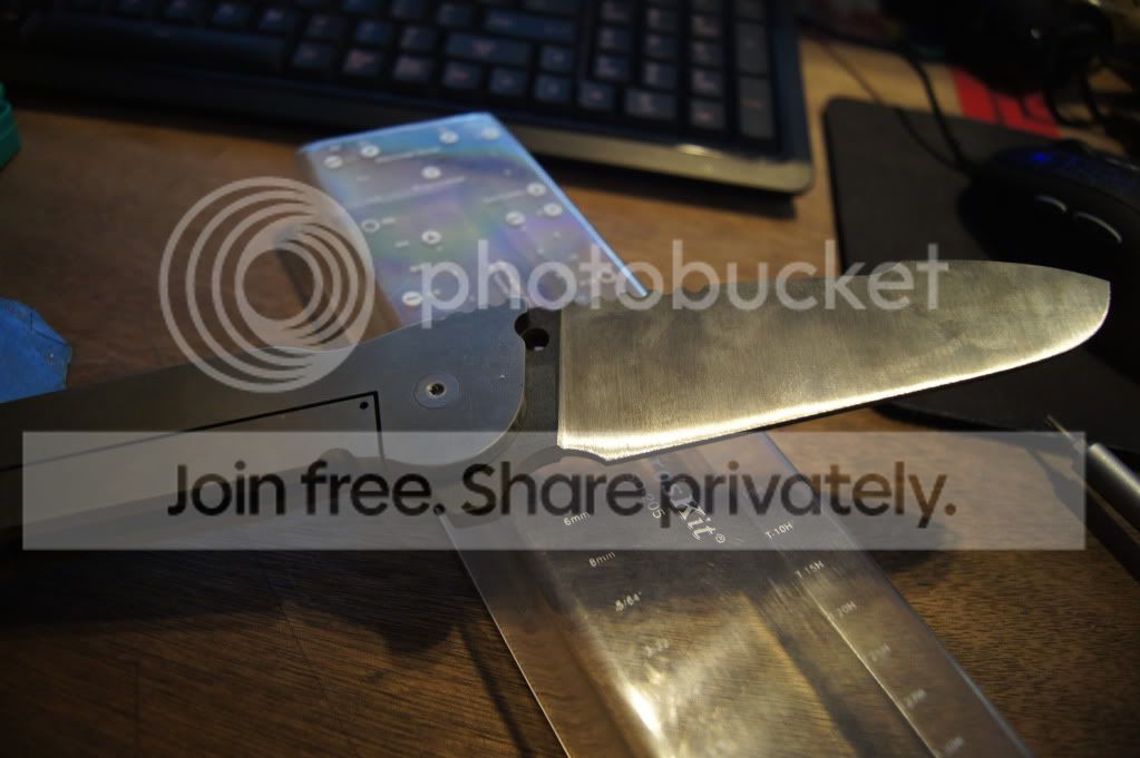

I guess the forum server was PMSing last night with the forum upgrades...so this is a day late. Wednesday I fired up my trusty griz and went to town on the blank with a new 40grit ceramic belt on my newly mounted glass platen. Started with scribing a .075 inch "nickle width" edge. First I worked to my scribe lines at 10 deg. Then I worked my way up the blade to 7 then 5 and finally 4 deg. Once I was close to the spine I swapped to a 120 grit ceramic and ground to a true 4 degree bevel. Using a guide is ALL the difference in keeping the ricassos even plus it provides leverage for my thumb to "feel" the flat and adjust my grind accordingly.
Overall I'm happy with the result. Bevels are dead nuts even and the ricasso area is 80% there. A little file work and it will be perfect. Total grind time was 75 minutes. Way too slow but I have a feeling that i will pick up speed when I do 15 back to back. Also the pivots from AKS are here!
Next I'm going to experiment with a false edge/swedge.
Looking amazing man. Exactly as in your diagrams. Nice full flat ground, perfect for a large folder like this imo.
Heh when I saw the second and third pic I was like wtf... scandi? Guess i'm not too used to watching WIP threads and don't know how a grind is done, really. Cool to see the intermediate pics though!

William, I've been following along, and I wish you good fortune on your venture. Just a thought though, I think your blade would look a lot better if your bevel didn't break the spine. Bring it up, leave 1/8th to 1/16th space to the spine. Gives a clean, professional look in my opinion. As I said, just a thought...
