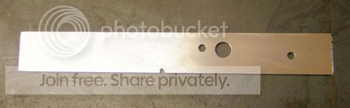

The first thing I do for this knife is saw off bar stock and pop it in the small mill for a few holes. This goes pretty fast, the mill and saw keep pace with each other while I crank out a few blanks. The features here are all created in the same setup, so they are accurate relative to each other, but not necessarily to the rest of the work piece. Remember, the ends are just saw cut etc. I'll deal with that in the next operation
I'm making this:
This is the beginnings of a knife. You have your two pin holes, which will eventually hold the scales and will also be used as locating features for fixturing, and a larger clearance hole, also used during fixturing later.

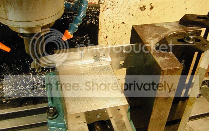

The next operation (profiling) is going to go faster on a heavier machine

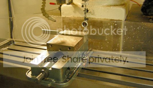

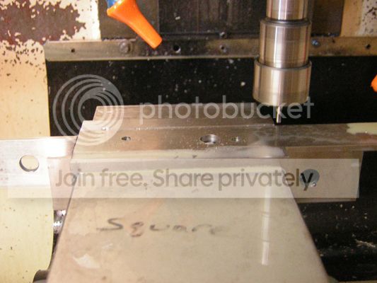

The first thing I do is square up a vise. TIP: I don't directly indicate a vice jaw because things can move around a little bit when you clamp down, so I find it better to clamp onto something and indicate off that, hence the ground flat stock. Notice I'm sweeping the side touching the stationary jaw, that is in case the flat stock has any taper it won't affect the setup. Then I tighten it down to the table and double check square one more time.

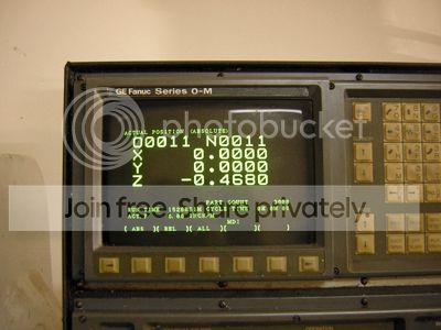

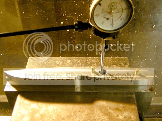

Next I put my fixture in the vice and indicate zero. I'm using a coaxial indicator to sweep a hole that was bored into the fixture at program zero when the fixture was made. In my opinion this is one of the fastest and easiest ways to zero a fixture accurately. Very robust and fool proof way to get in under a thou. In comparison I think using an edge finder on planes is slower and fraught with more opportunities for errors to accumulate.
Zero out the X and Y axis:
The Z axis will get zeroed with the cutter. I do this differently if I'm using multiple tools or using a machine with a tool changer, but for this I literally just run the cutter down to the part and use G92 Z.010 (to get under the part a tad).

With the fixture and cutter zeroed out and the part in the fixture I cut the profile of the edge. I don't do this all in one pass, but I start on the outside and work in. I don't start at the top and work down and cut a drop, but instead reduce everything to chips for slug control. These are some fairly heavy cuts (for D2) so you can feel it through your feet. The larger mill weighs nearly three tons but you can definitely tell it is working. The small mill could do it too, but would require more cuts to get there.
I also take a skim cut to "zero" off the back and end of the blank for accuracy in the next setup. So now those surfaces are accurate relative to the internal features I fixtured from. Tip: I've fed the cutter deeper (into air) so these cuts are made with a fresh bit of the endmill for better accuracy.

That Plexiglas at the back of the table is so simple and such a nice solution.

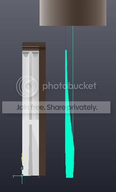

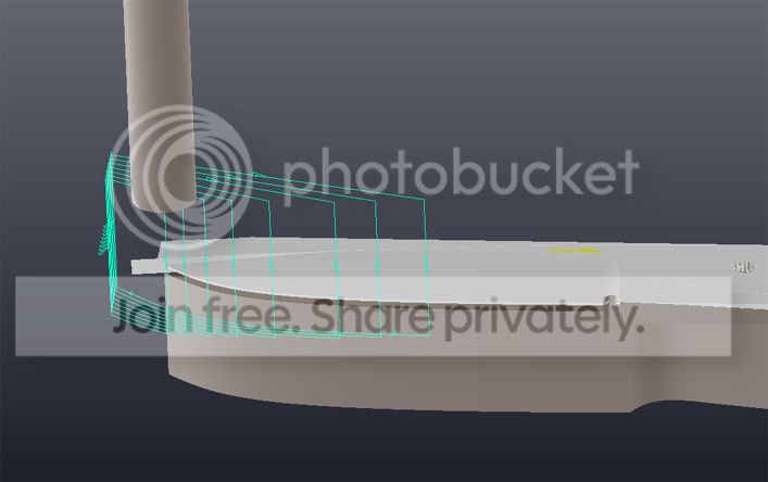

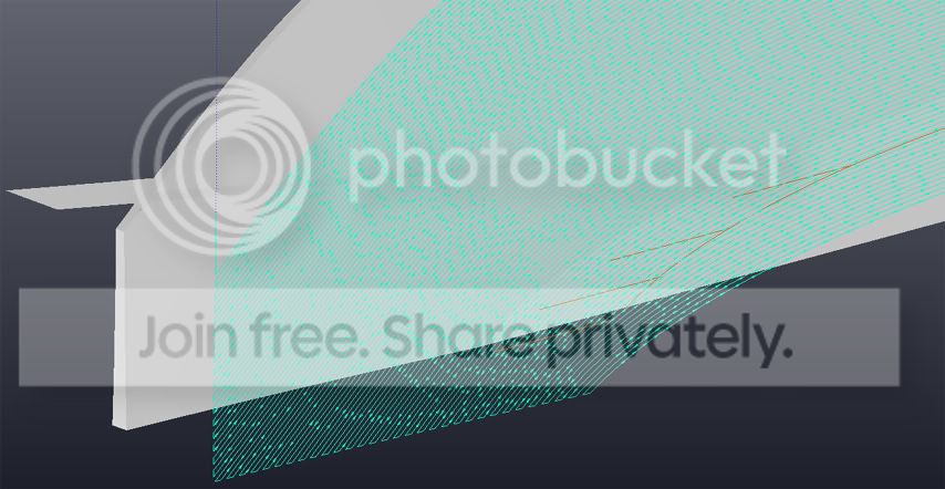

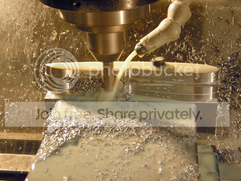

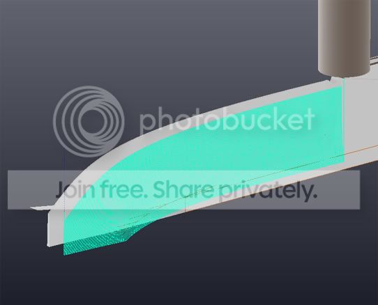

This might be everybody's favorite part here, I'm milling the bevel. I've gone over this a couple times before, but people have a hard time understanding what I'm talking about, so I'll try to explain better.
I'm milling a 10" hollow "grind" into the blade on a CNC mill. The "grind" remains *perpendicular* to the edge as it wraps around the belly, which is not something you could do with a "form tool" or by angling the vise unless you’re cutting something with a straight edge, no curvature or belly...

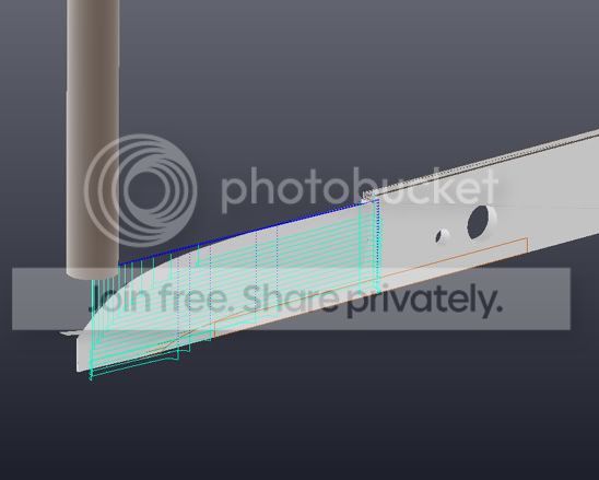

I'm "surface milling", or using a cutter to follow the desired part shape back and forth in a series of fine cuts. In this case I roughed out the bevel with basic "profile" cuts, leaving .005" rough stock allowance, then I surface milled following the surface iso lines when developing the tool paths.
Roughing:
Surfacing:
Detail:
End view:

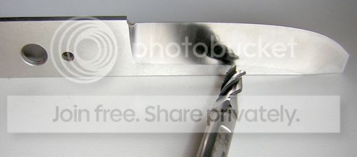

This cuts in three axis simultaneously, leaving a more natural surface finish which speeds up polishing out tool marks later. It also leaves a set distance between cuts (.008 step over) as measured in the cut, it would otherwise vary as the curvature of the "grind" comes close to approaching vertical at the edge. I have the surface accuracy tolerance set to .0002" to reduce tessellation, this increases the program length to thousands of lines, which on a PCNC is moot.
I'm using a square end cutter, rather than the more commonly used ball endmill generally used for surface milling for a couple reasons. 1: It requires less clearance between the cut and the vice. 2: it minimizes the amount of the cutter in the cut and the cutting forces required, reducing chatter and deflection on a fairly tall thin unsupported cut. I could use a corner radius cutter to split the difference for a better finish, but it is not necessary for this.
I mill bevels rather than grind them for a couple reasons:
1: it generates chips, not dust, so it is cleaner, cheaper, faster, cooler and safer.
2: The bevels are perfectly symmetrical and the edge is perfectly straight and a specific thickness. I tinker around with this cut in the computer until it is exactly the "grind" I want. I can get "under the hood" in the computer simulation and look at cross sections, and the grind height and make choices based upon what I think will look and cut the best. If I wanted to blend from a hollow grind to a convex grind I could. If I wanted to use a parabolic or conic shaped grind profile rather than a true radius I could. I can vary the edge thickness or grind height with perfect control with this approach.
So for me, milling my grind, or at least roughing the bevels on the mill, is faster and better than grinding them. The end result is higher quality (for me, I can't grind like Bruce Bump). For those here using CNC (at least three of you come to mind), I think you should try this, at least in some form.

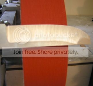

And... The next step is:
Grinding the bevels anyway
A milled surface finish doesn't look right on a blade, milled tool marks will never be as nice as a good grind. If I was going to hand rub these, I'd probably just do that from here, but I want a ground finish, so the grinder is still necessary after machining to remove cutter marks. I start with 120 grit and I take it up to 400, a fairly good finish. Takes me about 15 minutes. Someone better at offhand grinding could probably do it in half that. It will get tumbled before HT and scotchbrite after.
You'll notice I don't give much attention to the "tip". Many here will recall that I don't like grinding tips. Stresses me out. I used to botch it about half the time. I've gotten a lot better, but this approach makes it a non-issue. I order my operations to do away with it all together. That bit gets removed later. You'll see, Ta-Da!, perfect tips...

I don't think you'd like this finish very much. Compaired to a ground finish it is kind of rough.
