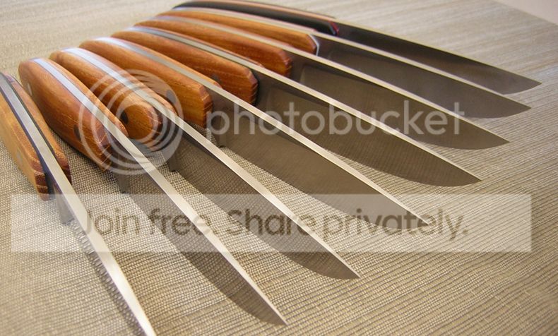

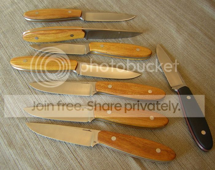

The purpose of this WIP was to illustrate my different approaches to knife making from the perspective of a jobbing shop and a jack machinist and not to show off knives (when Bruce Bump etc is in the room, I feel silly showing off my stuff). But, since I've never actually shown a finished knife on this forum before, this is probably the time to do that.
The finished knife is a very basic drop point skinner. A few are ground down to .010, most were left at .020. Most were hardened to HRC 60-62. One is .030 and HRC 58 and will be going to a non-knife friend of mine where ease of sharpening and ability to withstand abuse were more important than edge holding and cutting performance. It is interesting because that one took more of a mat finish from the scotchbrite and tumbling. I also put black canvas micarta on one.

Matthew, for the record, I made the scales a few thou over and sanded to flush after installation.Your eye can see, and your hand can feel a mismatch down to .001". With tolerance stackups and Murphy, I'm not that good, so I still have to sand to fit.
