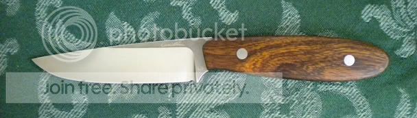

Nathan, beautiful work, sir! Can you expand a little bit on how you're milling the main bevels. If I understand you it appears you're not tilting the blade or mill, right? You're basically stepping the end mill in small bites or.....?
Splat,
Yeah, that's right, I'm cutting the bevels in descending steps. I then do the final finish on a grinder. There are other approaches, including the tilting the blade, using a cutter with side angle and laying the blade over on its side and using a big facemill or a CBN wheel. There are pros and cons to each approach.

To load a fixture, touch off tooling, open the manufacturing file in CAM, post fresh code and start making chips takes between 10 and 20 minutes. So, setup for a particular operation isn't too bad. Overall there are a few different operations. Make the blank, profile the edge, mill the bevels, finish the profile, machine the scales etc. I also have to saw the wood, glue the liners, turn the shoulder pins etc. Then heat treat, fit up and finishing is done conventionally.

I still make this pattern regularly, though I've stopped using osage orange as much as I once did. While I like the wood quite a bit because it works so well, I've found that more upscale wood sells better. Here is what this pattern looks like today:
