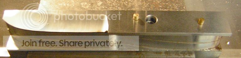

Back to the profiling fixture
Let me go into a bit more detail what I'm doing here. This is a fixture where I can sandwich a blade blank between two chunks of steel to hold it while it is being profile cut. If you're cutting more than a few, it is worth makeing one. The top piece is thick like that for stiffness, it is pretty long, the ends are cantilevered pretty far away from that one bolt, thus it needed to be thick to work right. TIP: flexibility and play are your enemy, especially when cutting with carbide.
Also, the entire fixture stands up pretty high. Or higher than you might think it needs to. The reason for this is so I can run the cutter much deeper than just the tip of the cutter. BIG TIP: This allows me to use old dull cutters that are still sharp 1/4" up from the tip. Or 1/2" up. Or 3/4"... You get the idea. This reduces my hard costs for profile cutting to about nothing. Otherwise, carbide endmills aren't cheep, and D2 can be pretty brutal on cutters. Most of us have a lot of old used cutters laying around, this is a good use for them.

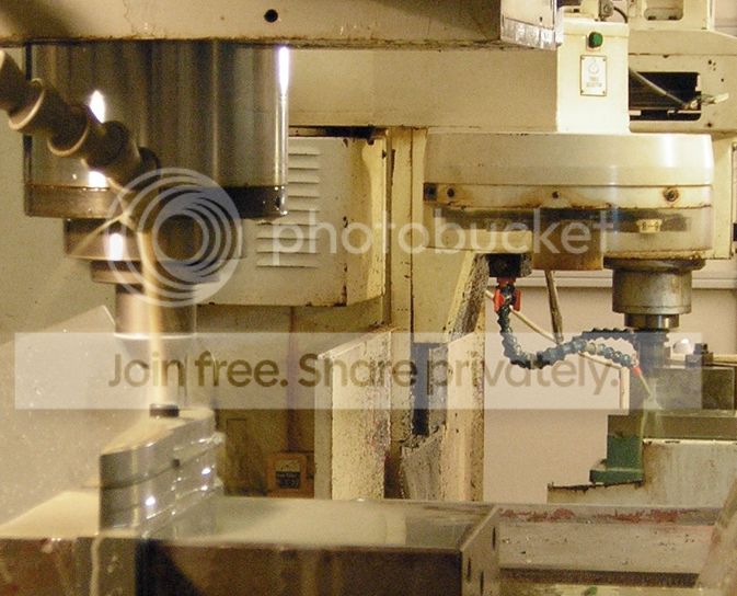

I love this next pict:
I've got two mills working for me at the same time. *GRIN*. The work flow is efficient. I'm in one room grinding a roughed out blank to go onto the big mill to be profiled while the little mill is roughing out the bevels on the next blank for me.

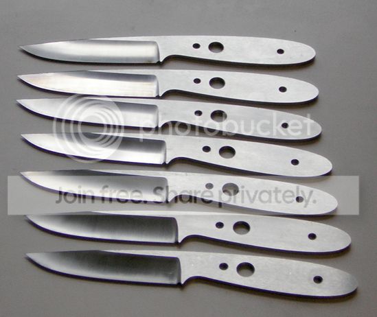

A blade that has been profiled, fresh off the mill:
A day's work:

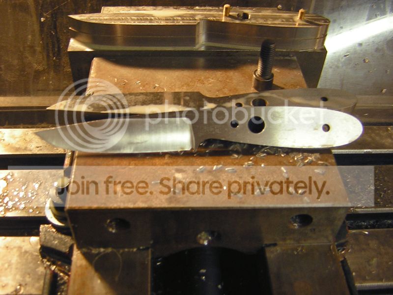

A part needs a way to be fixtured. Being a fixed blade I took advantage of the fact that you can put holes in the handle under the scale. I considered adding more to reduce weight.
Other one-off stuff, or parts that shouldn't have a hole in them require a different approach. This is the way most of the blades I've made get born and a good approach for you and your mill:
I've described this once before, but I have a hell of a time being understood by folks, so picts help.
In this case I profiled most of the way through, leaving a skin on the bottom that the finished part can be popped through. A variation I do now is leaving a finishing cut allowance and stopping shy on the edge part of the knife. Then I put a finishing cut that goes all the way through on most of the blade, the rest of it supported by the land left between the stock and the edge. That way everything gets a good finish. Then I cut the edge part of the blade most of the way through and pop the blade out by hand (I never intentionally cut a part free - good way to break stuff). The nasty burr that is left on the blade is in an area that gets removed when the bevels (and in this case, swedge) get ground. Do that make any sense?
That approach is much slower than using a fixture, and it uses up cutters where a fixture does not.

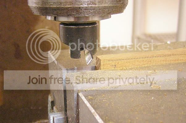

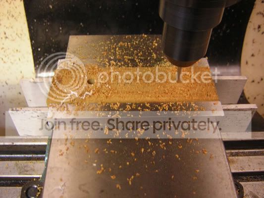

Before moving on to the next step on the blade, it was time to start thinking about scales. The epoxy I use takes a long time to cure, so I needed to cut scales and get them glued to a liner so they can sit a day before more work can be done on them.

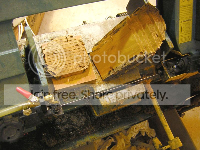

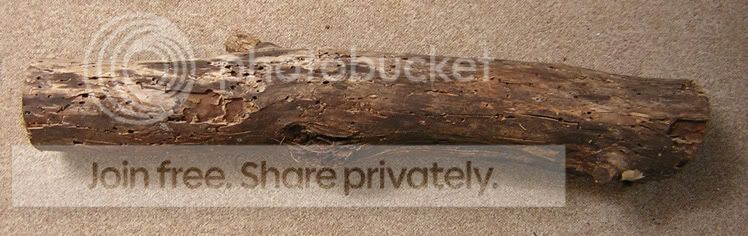

I'm using osage orange for these knives. This ugly old log contains some pretty nice wood inside:

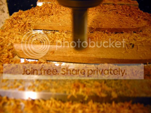

I had sawn off a chunk and epoxyied it to a 2X6. TIP: The 2X6 holds the work piece in place so I can feed it through and slice it up like a loaf of bread in a horizontal bandsaw. I’ve even used this technique for 6-6-4 titanium (6-4’s big brother)
I set the feed to cut fairly slow. The finished result is fairly smooth and very flat and straight. Next I trimmed them into rectilinear slabs on the worlds most clapped out radial arm saw (which has cut a lot more aluminum and plastic than wood). I then match them up to mates and epoxy some of them to some liner stock.
Some of the grain in the osage orange will turn a little bit more of a chocolate brown with age, but for now the color clashes with the liner colors I have except white and black. In fact I'm not convinced it wouldn't look better without a liner, so I'm doing a couple in white (which I'll probably regret because anything white is a PITA in this dusty old shop) and black, and I'll attach the rest directly to the blade without a liner.

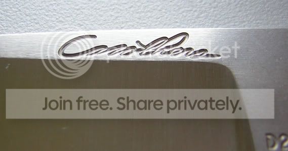

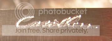

Okay, today’s post was going to be engraving. That didn’t turn out so well.
The engraving cutter I chose didn’t leave a good finish. I’ll have to order something different.
So here is a pict of an older blade (slightly different design) where I simply used a very small endmill
I forgo a stamp for a couple reasons. A: this is *generally* more fool proof. B: I can set the size and location exactly how I want it in the computer and see what I'm going to get before committing it to the steel. Stamping would be simpler, but (when it works right) I feel this is a nice touch and is worth the extra effort.
I milled that with a .031" ball endmill. I had to squint to be sure the cutter I picked out was actually a ball end. I used a high speed air spindle attachment to get the RPM up there, otherwise I'd be limited to a 5,000 RPM spindle, which would reduce my feed per minute to a painfully slow 1.5 IPM.

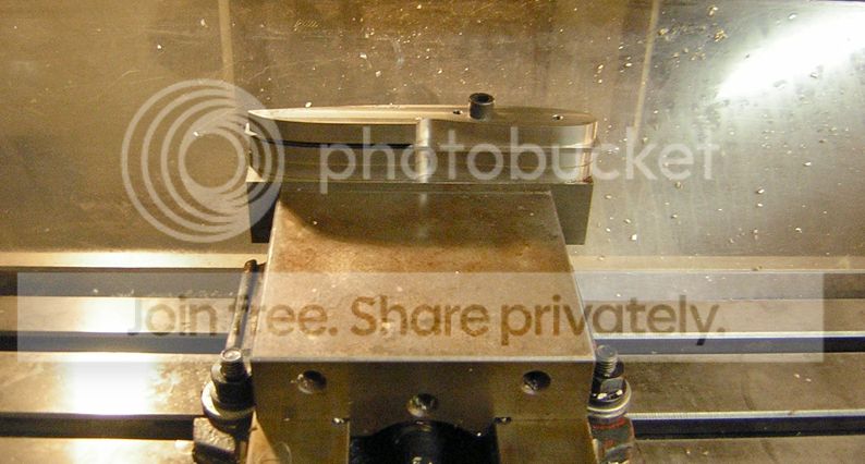

Since I didn’t work on engraving I went ahead and cut scales.
Osage orange is dense, stable, and fine grained. You just about can’t mark it with your fingernail, and a well seasoned piece like this doesn’t move around after you cut it. Other than wearing HSS cutters quickly, it machines well.

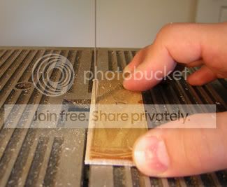

The first thing I do is cut the blocks from the liner stock
Then I square up any blocks that are not reasonably parallel so they’ll fit well in a vice. I'm using a fly cutter with a bit ground to cut wood. It is literally shaving sharp and ground almost like a chisel to prevent the wood from tearing.

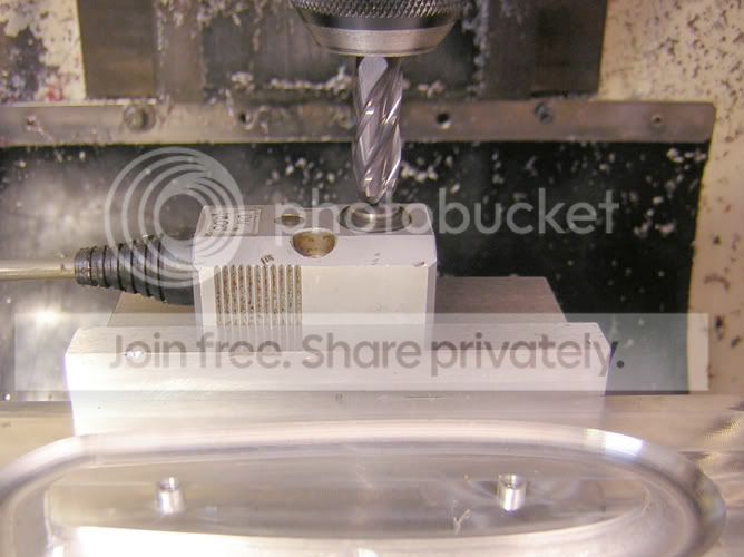

The next thing I do is cut my pin holes. This is not a straight hole, it has a step in it. I am using an Onsrud o-flute router bit, again to reduce risk of wood tearing. Note: the carbide used in good router bits does not need to be as tough as metal cutting tools, so they can use less cobalt binder (thus higher tungsten carbide content). This leads to a harder, longer lasting, carbide that would chip in metal, but cuts abrasive wood like this without dulling quickly. You run it at the highest speed you have and feed fast enough to prevent burning. Ideally 25,000 RPM and 100 IPM, but I'm going a *lot* slower than that.
The difference is subtle, but there is a left and a right here. I mated up matching pairs earlier, and I'm being careful about which side and which direction these will go on the finished knife.

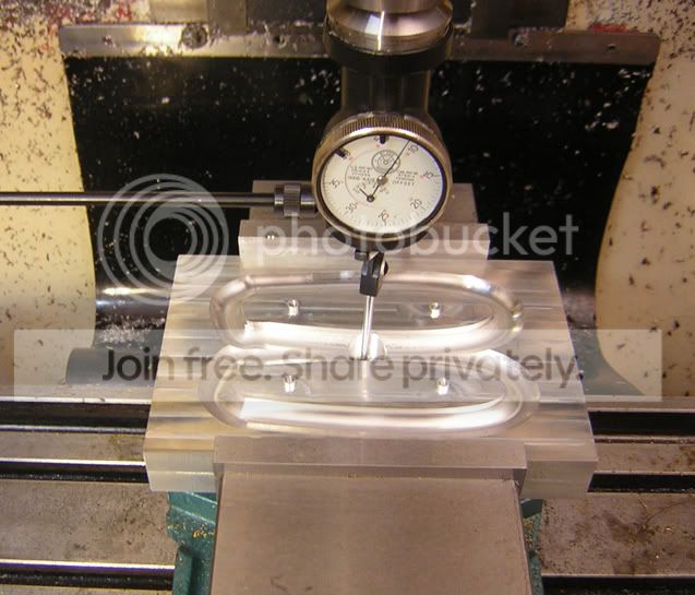

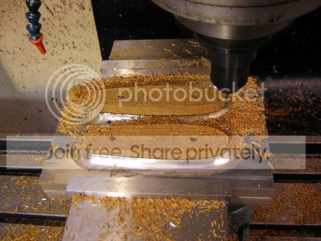

The next step is to load my fixture and zero it out. Similar to the other fixture earlier
The program is going to require a tool change, so I need to zero my cutters out in a way where I can call out a cutter length offset compensation. If anybody is interested in how this is done, I’ll describe the process, otherwise I’ll try to keep focus.
With my tools and fixture zeroed out I'm ready to cut scales. The blanks fit tightly into place over the posts on the fixture and are held in down with a couple 4-40 BHCS.
Cutter one cuts the profile.
Cutter two is a larger ball end that roughs then finished the scales

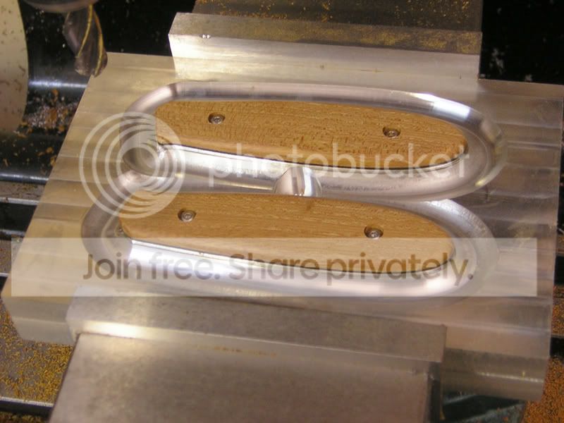

Scales are done.

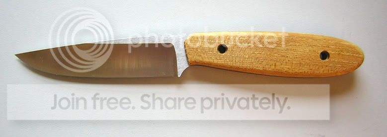

The finished scales are not flat sided slabs but are subtly contoured and rounded (without being blob like). There is some palm swell and it necks down for a pinch grip before widening up again at the “guard”.
Here is a pict of an "as machined" scale set on an "as machined" blade.
They’ll both need some hand finishing touches, the blade needs engraving, tumbling and HT, but you get the general idea of the basic look.
