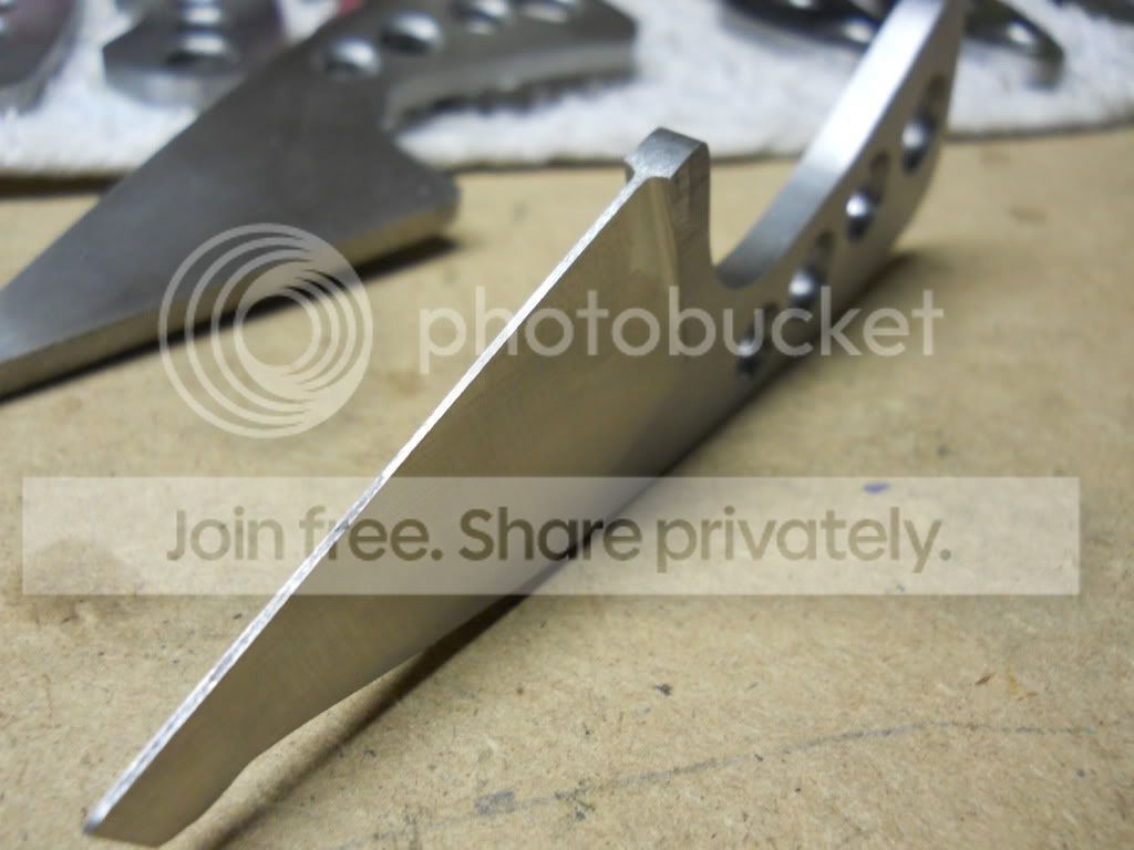

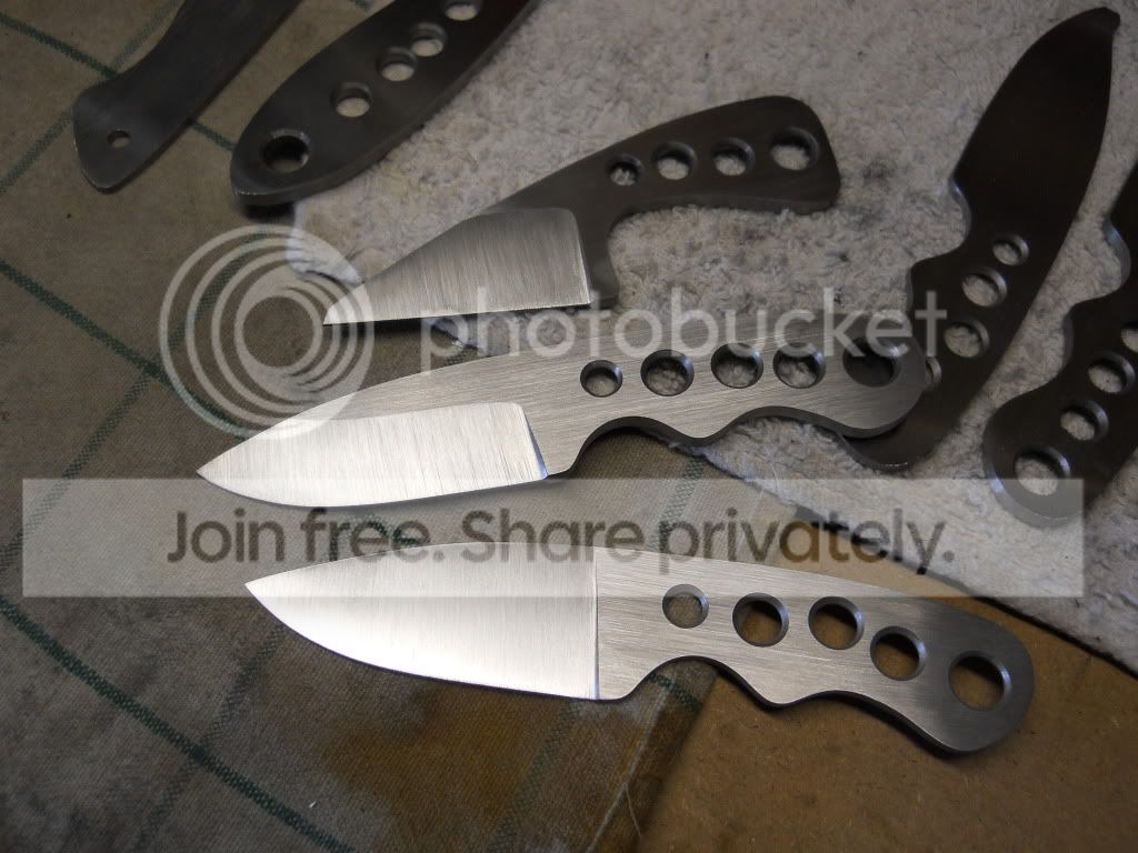

Spent most of my shop time last night after work doing some design work that needed to get done, so I didn't get much grinding in, but tonight after work I was able to finish up bevel grinding on one of the Two Finger Wharnies so here are a couple progress pics. If I can get enough time to complete one bevel every two days or so it won't be long before I'm ready for heat treat:thumbup: I'll try to keep up the pace.

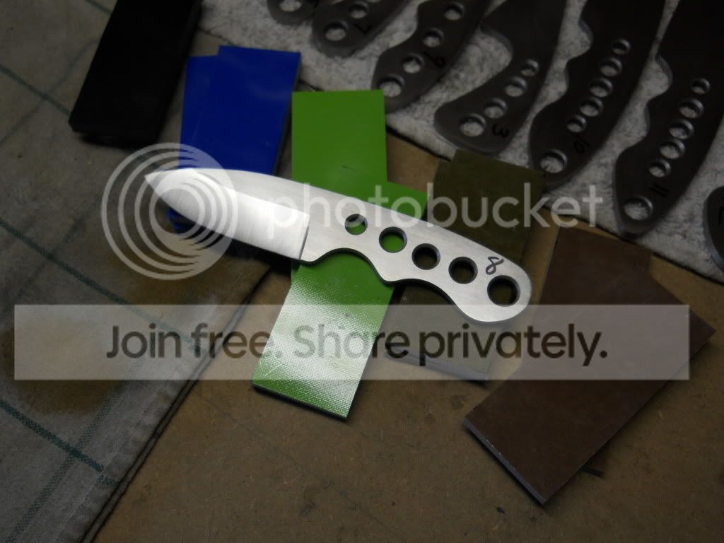

Well, I got some shop time today. Not as much as I would have liked, but still productive. I got a couple more blades profiled so I'm now about a third of the way through my pre heat treat grinding.
Here are some pics:

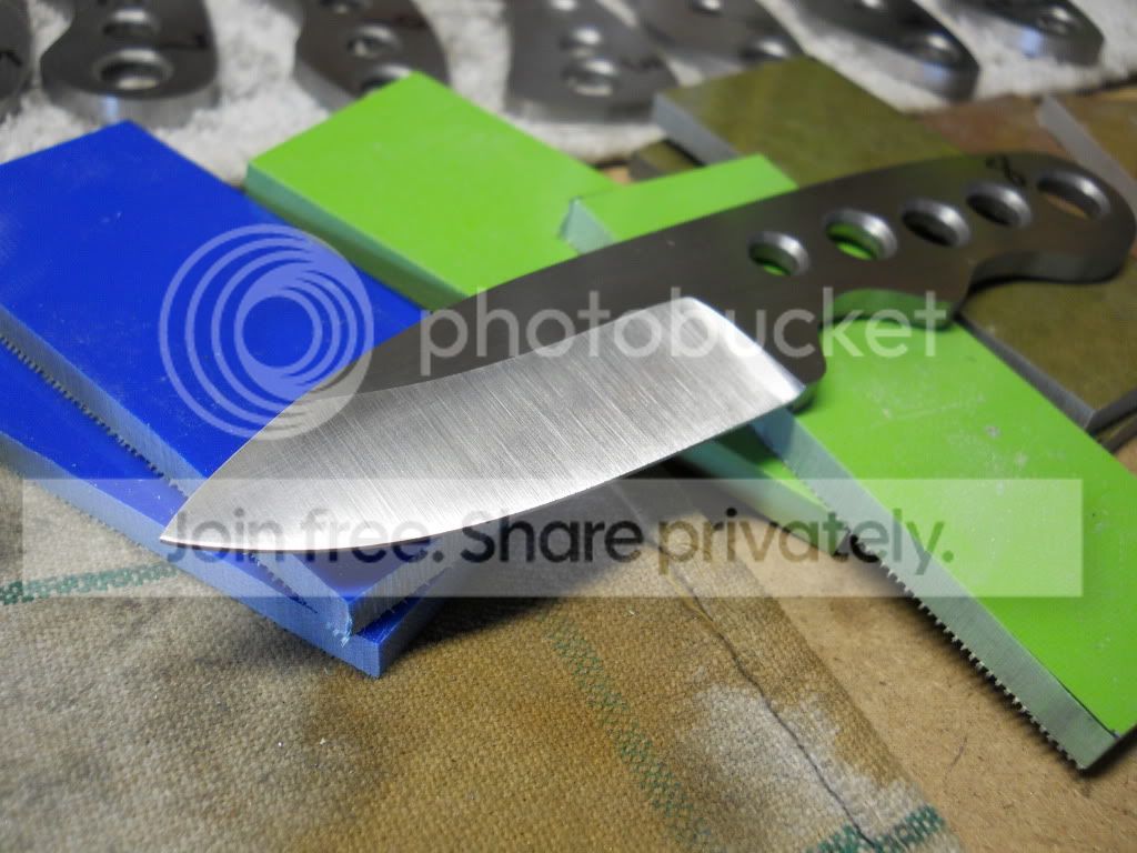

Bevel grinding done from today. The thicker of the two Mini Drop Points will be getting a swedge. The other is one of the two thinner .118" thick blades and I decided to take it all the way to the spine. Going to see how good of a slicer I can make out of it.

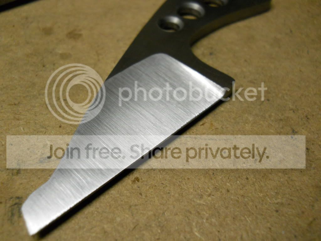

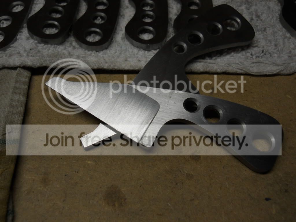

I also took the extra meat from the tip area of the Two Finger Wharnie today to give it it's final shape. I decided to square off the tip on this one to give it some more strength, unlike my previous Two Finger Wharnies where I left a super sharp needle point that could easily snap off. It looked wicked but I wanted to try something more functional this time around.

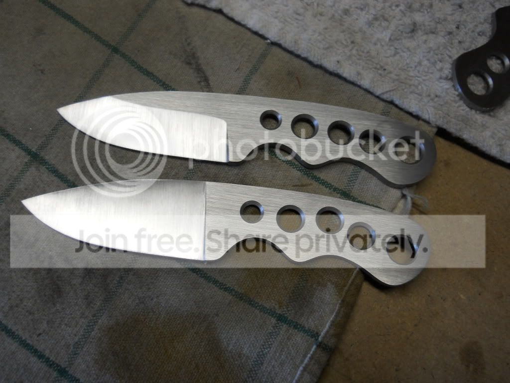

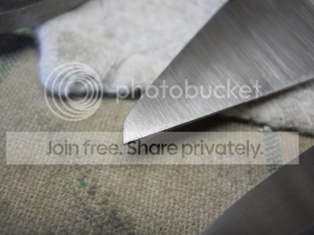

Today I got a little more bevel grinding done on another Mini Drop Point. This bevel has been finished to 65x grit with a Norton Norax belt, about 400.

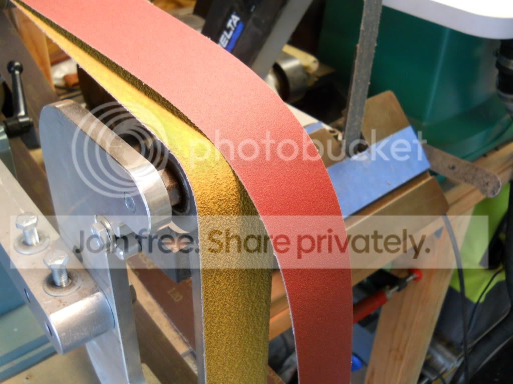

My current favorite belts for grinding bevels. 3M Cubitron gold 60's and 3M Regal 120's, both ceramic. They wear really well and allow for good control.

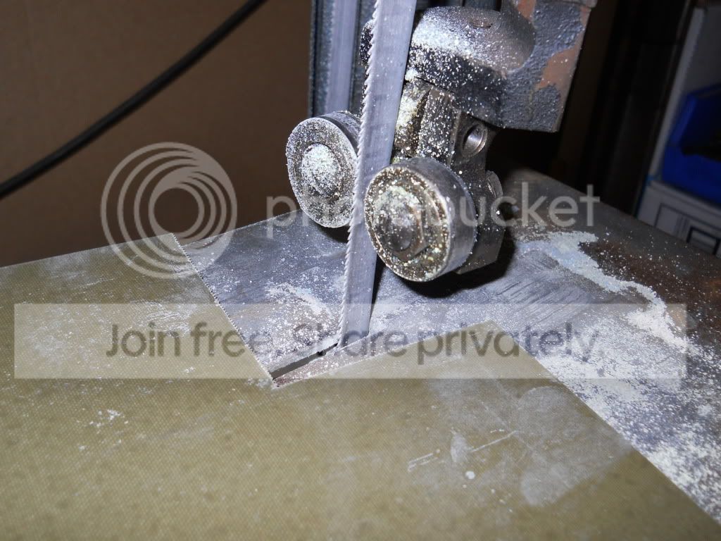

Cutting out handle material on the band saw. I try to do it in decent size batches so I can clean up all the dust at the same time.
Awesome wip Jonny! You are moving right along, I've been meaning to try one of those 3m 120 ceramic belts, now I definitely will have to order some in :D
