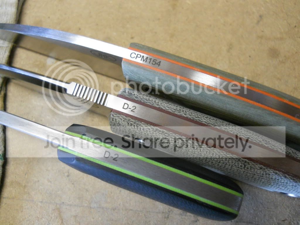

WIP - Starting a new batch, all D2 Updated 4/25/11 New Progress

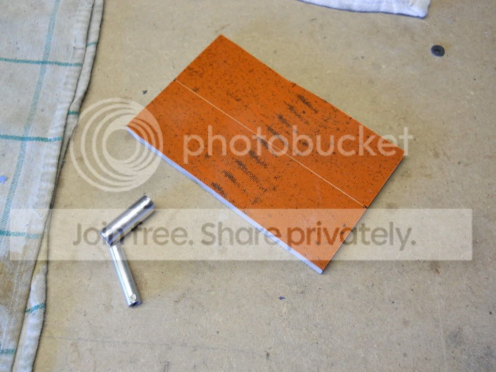

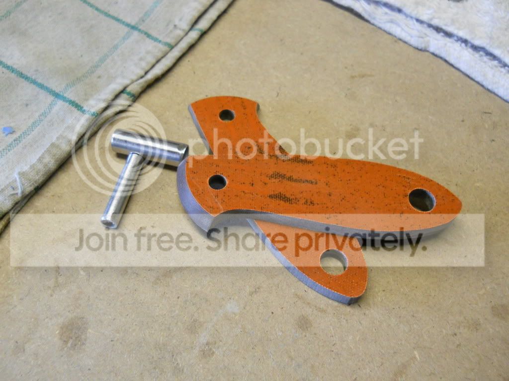

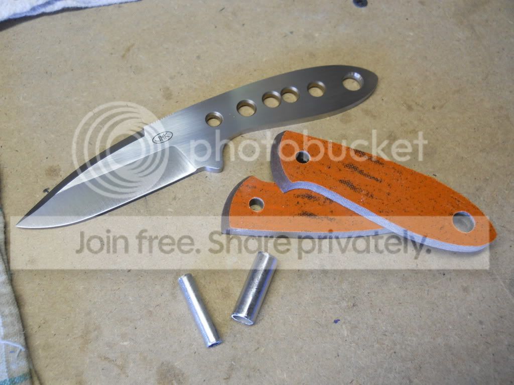

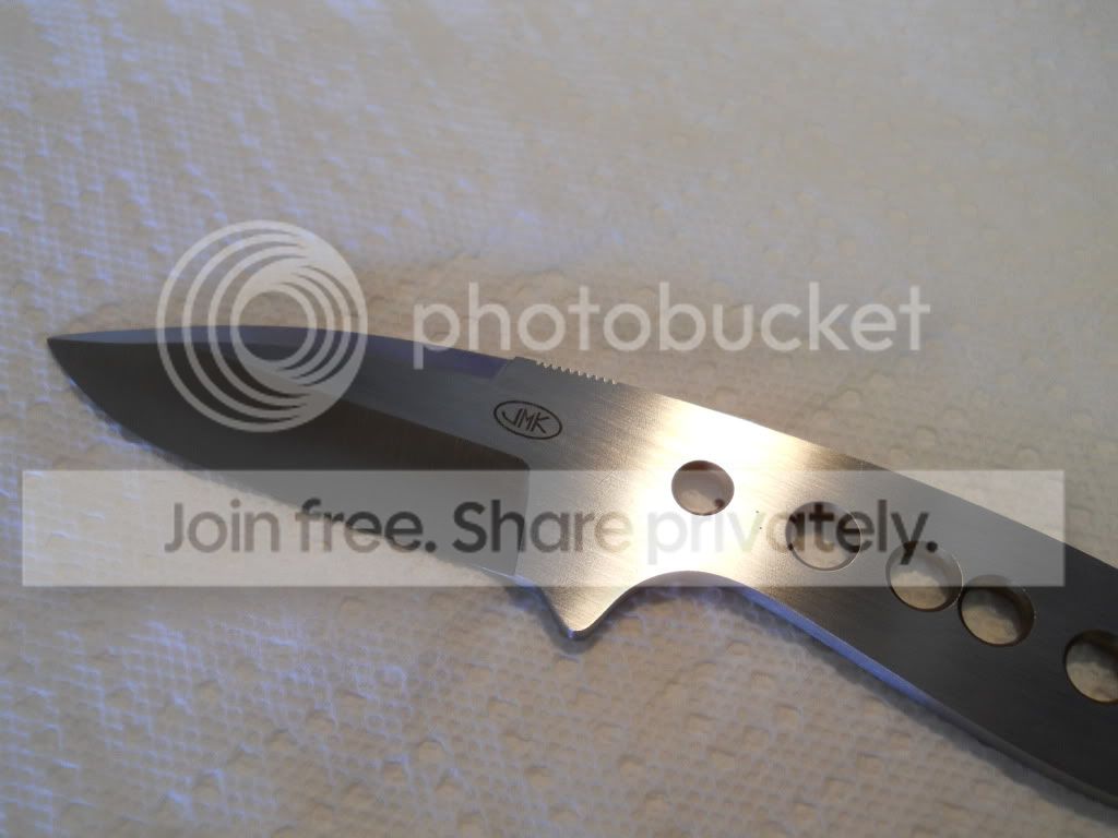

Well, I am still working on CPM 154 blades for customers but I got a chance to spend some time on the D2 batch today. First I got the finish done on the Model 1 EDC that is for a BF member. Then I finished roughing out the handle scales and etched my mark on the blade. It's all ready for glue up now.
Handle material, black and orange G-10, stainless tubes

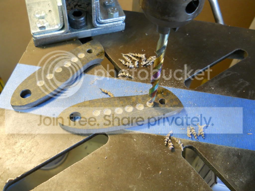

Scales rough shaped, holes drilled
Dimples drilled for epoxy

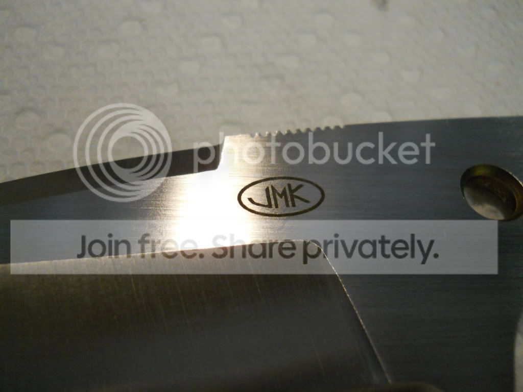

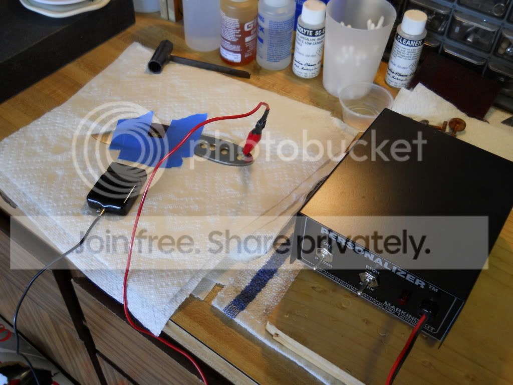

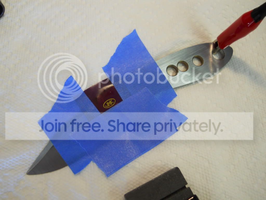

Set up for etching with the personalizer

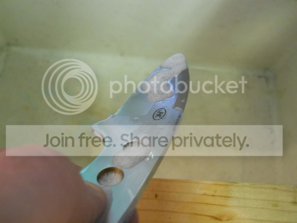

Be sure to give it a good rinse immediately after etching with some ammonia/windex/etc.
Maker's mark is on

Great WIP Jonny, Im also a newbie to this, so obviously i have a question. What is your process using the etcher to get such clean marks? Mine always end up deep but not near as black as i'd like. Yours look great. Thanks.

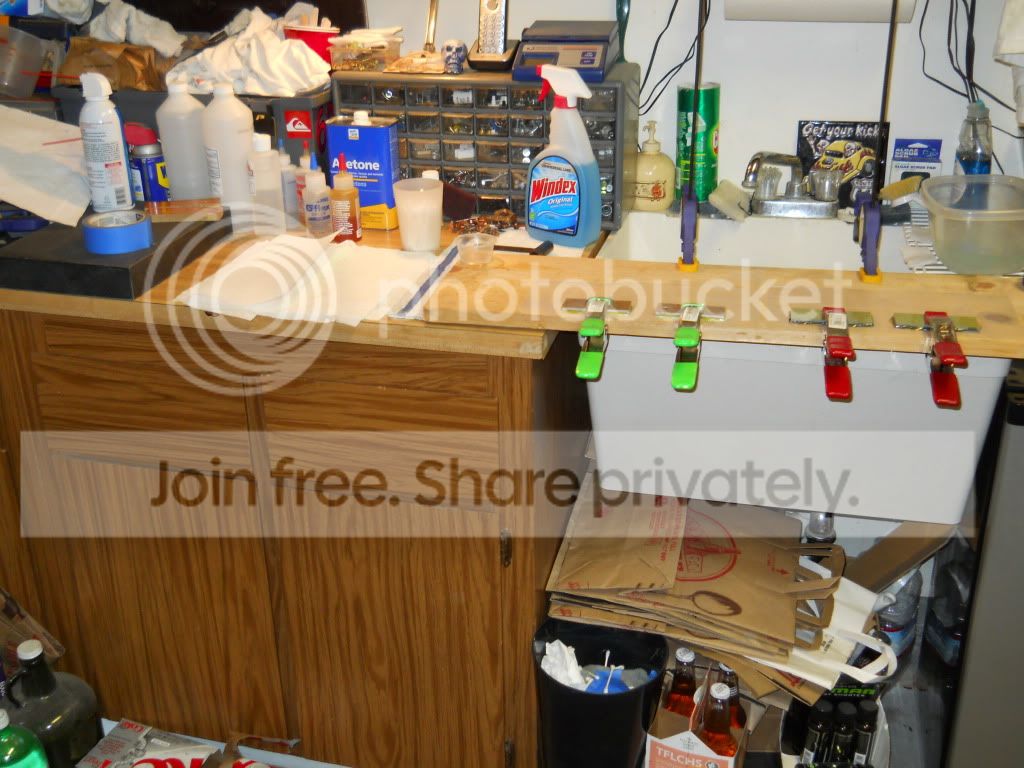

Been away from this thread for a while, but am still making good progress on this batch. Spent some time yesterday doing etches and cutting handle material/gluing up liners, etc. Not the most exciting day but made good progress
My handle/sheath/etching work station. I know, I know.....totally cutting edge:D
