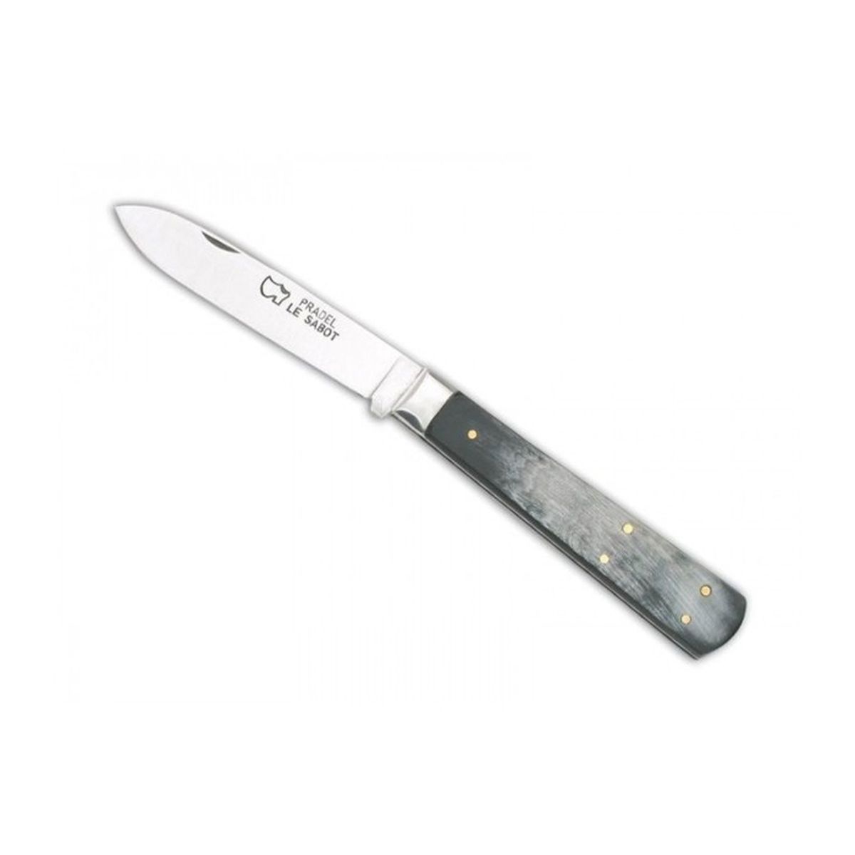

And this model I don't know what to call but I want to keep it light, handy and not to large.
Pradel ? 🙂

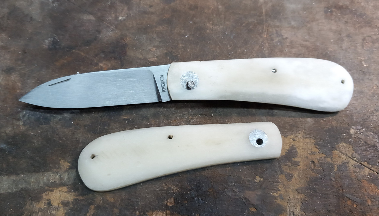

Tony Bose always freely shared his patterns. This one is based on his zulu spear and has unbleached cattle bone scales.
I think they looked good as they where, but I also like jigged bone and at the moment it is more about learning how to make these knives.
Jigged white bone looked good as wel but I coloured them twice with potasium permanganate and I like the classic look it gives.
