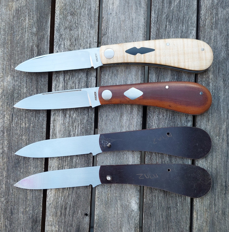

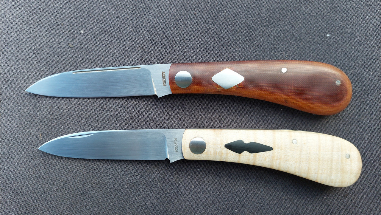

I like to work in small batches and I started a new batch. I made some progress on these three, it'll be a batch of five with two zulu's as well.
Two barlows and a trapper (I have a question on the trapper)

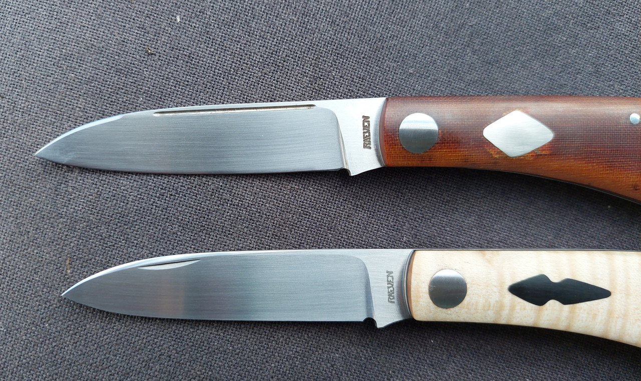

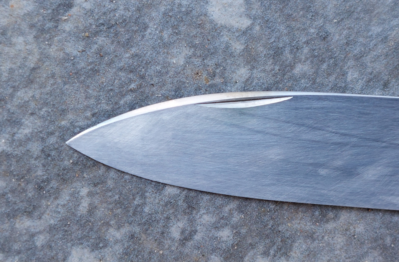

I haven't decided on the sheepfoot, Either a nail pull with cut swedges or pulled swedges with an extra large nail nick. What yo you guys think?

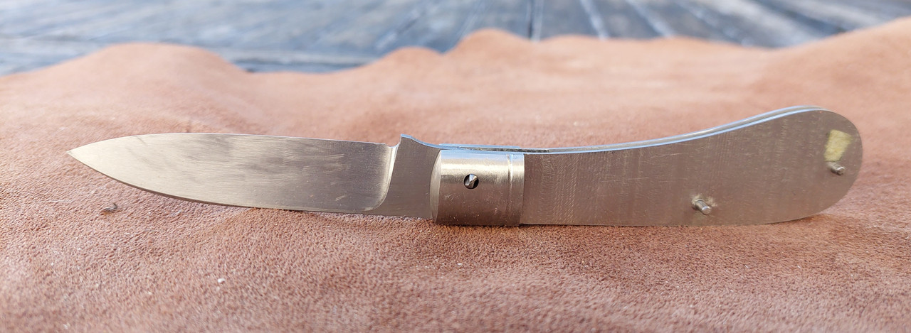

I'm experimenting with the shape of the kick as well. I like to be able to let the shape fit the handle and have one flowing line.

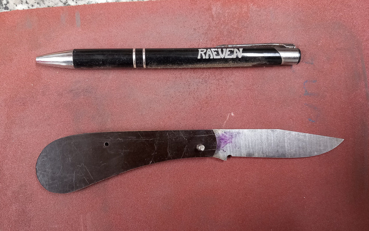

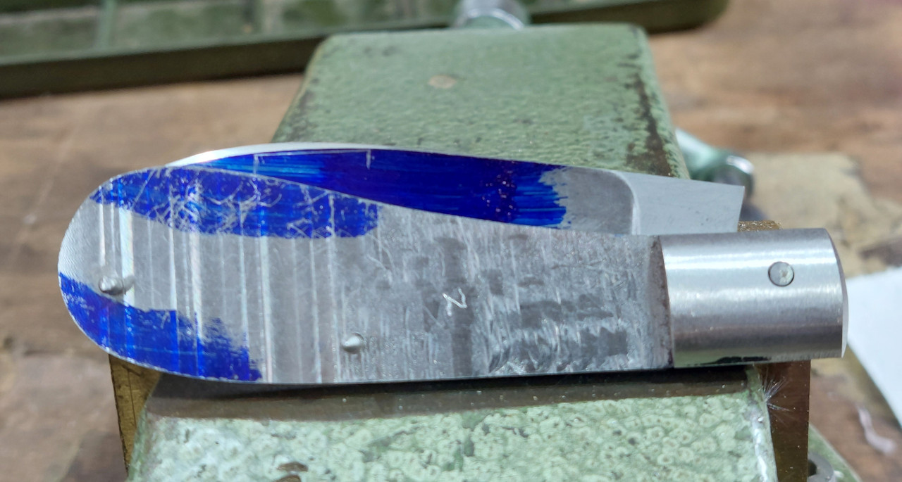

And the third knife, would you call it a trapper or should it be a bit slimmer to be a true trapper?
Anyhow it will get a nail nick, fluted bolsters and there is a good chance the covers will be desert ironwood. If you make a classic, might as well go classic all the way :)

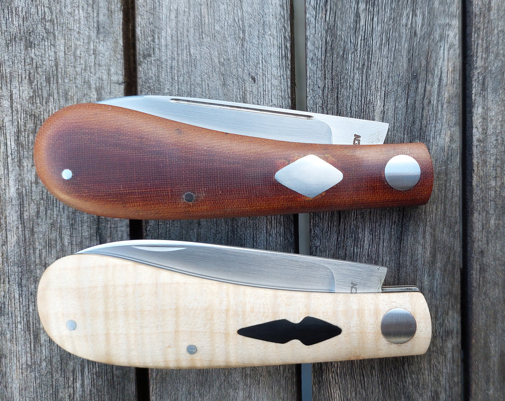

So is it a trapper of "just" a clippoint?
I would call the bottom knife in the photo with the pen more of a saddlehorn pattern. It makes a very comfortable handle.
And I made two zulu's as well making a total of five knives that are almost ready to send off for HT.
The zulu(spear) is one of my favorite models. I also have two that are almost finished.
They are the same shape, it's the nick or pull and swedge shape that makes all the difference. To me they look very different.
A nick makes it look more elegant and the pull gives it more of an utilitarian look.. I do like them both.
The two zulu's that will be send off for HT will get nail nicks.
I cut nail nicks post HT and pulls before HT.

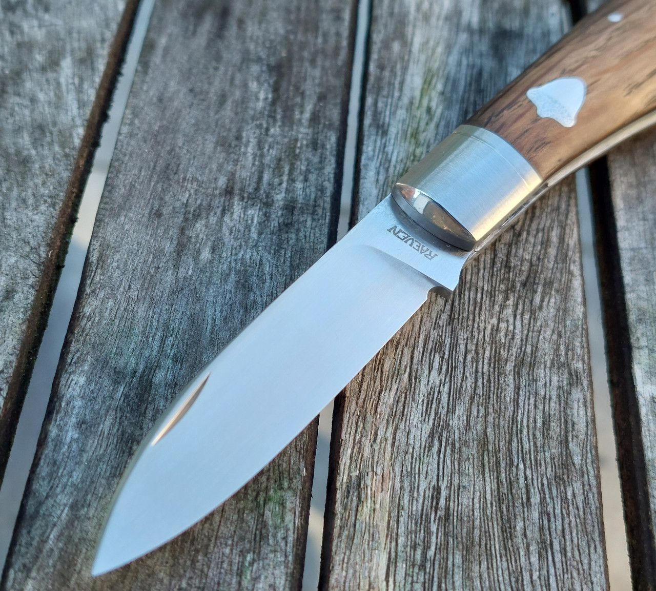

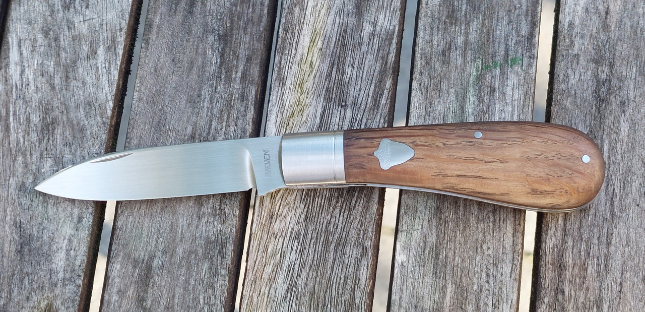

I've been honored to have been asked to make a zulu to a collector's taste.
This one has a nailnick and integral liners/bolster.
I love it when you can put all parts together and have the knife 'walk&talk'. It is almost as if it comes to life!

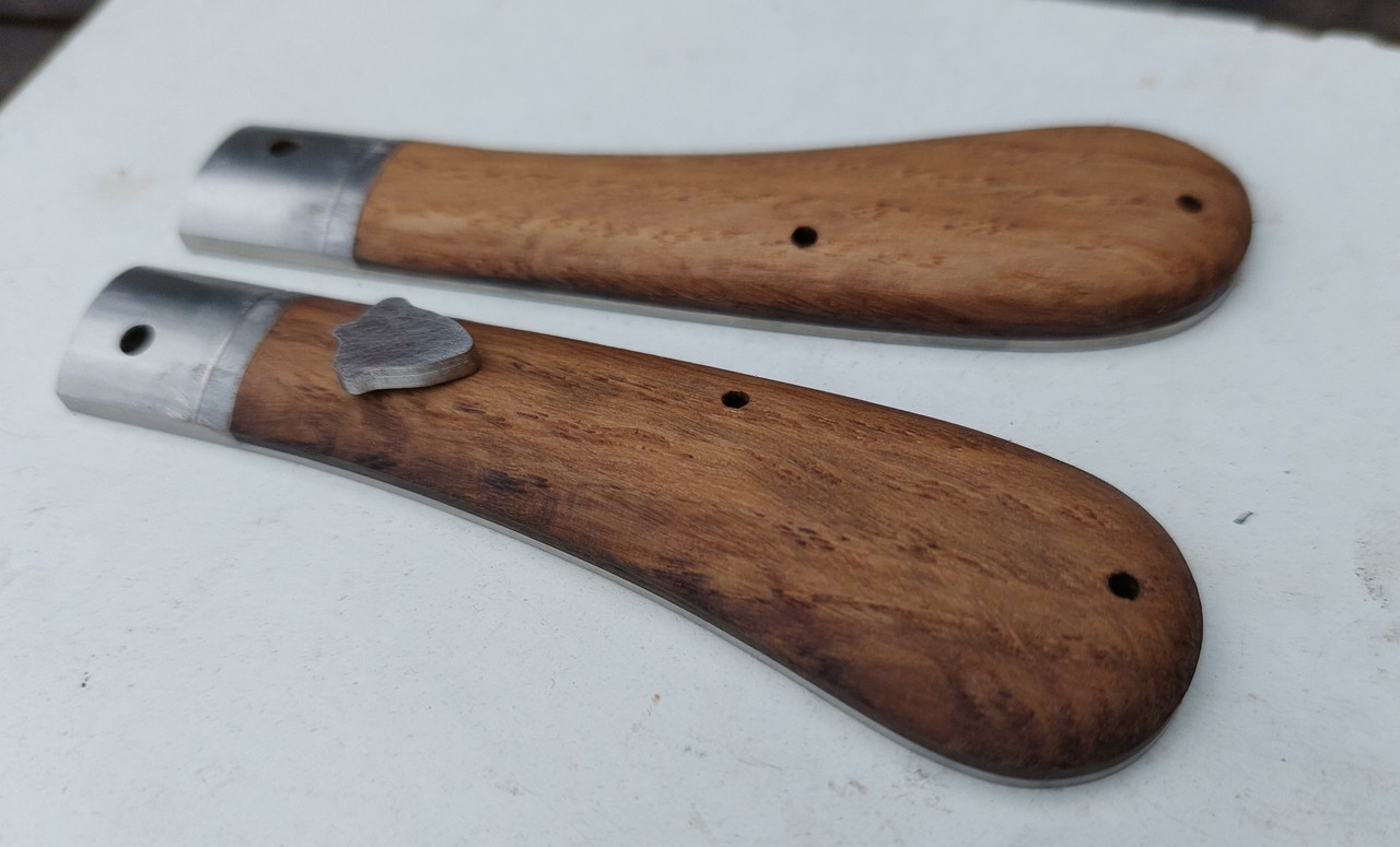

I've been asked to use oak as cover material. To me that is an underappreciated material.
(north) European oak is different then American oak.
I've set up my workshop in an old barn and I've saved old oak boards from it. The barn is at least 120 y/o but wood like this got reused a lot. So nobody knows how old this wood is but it does look good imho.

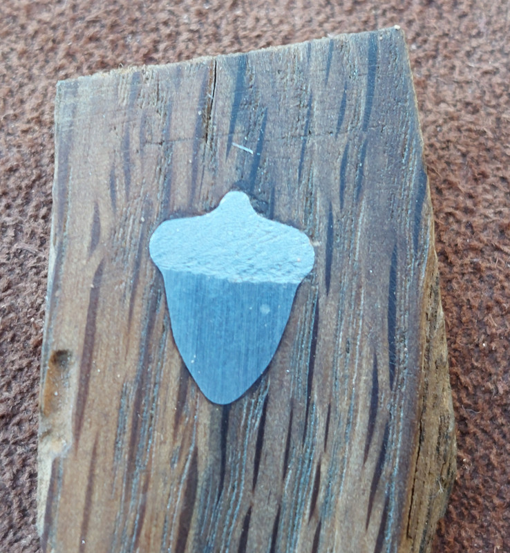

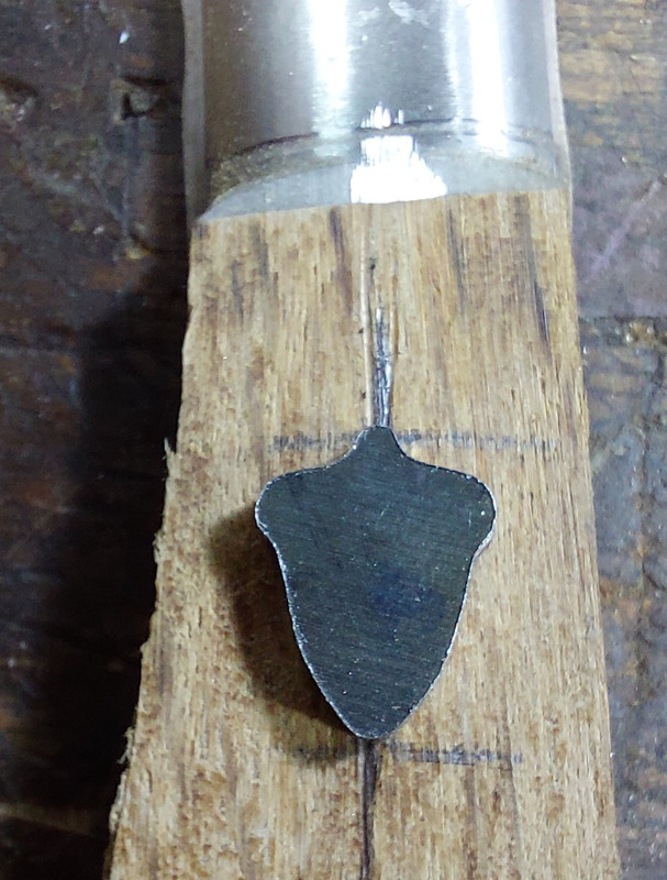

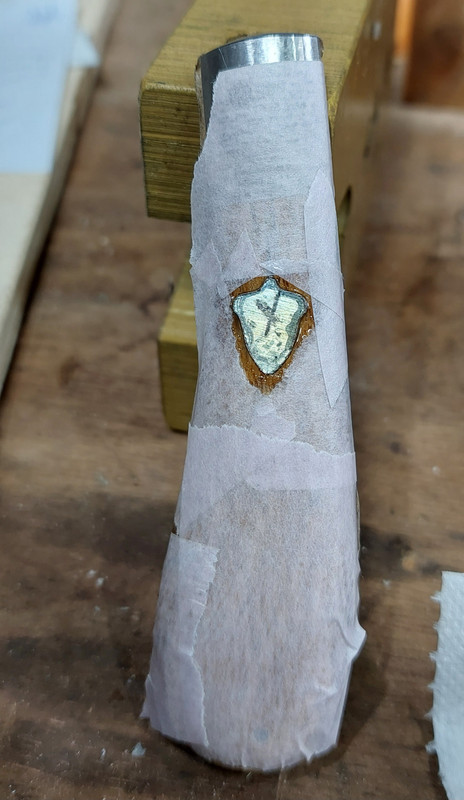

The acorn shield fits the theme I think.
I have to make a template for every shield shape I use. I like this one, I'll be using it more :)

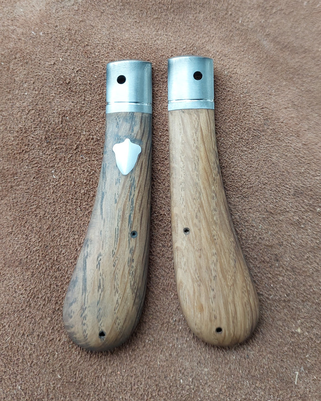

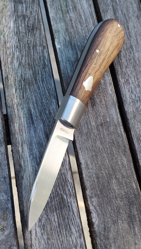

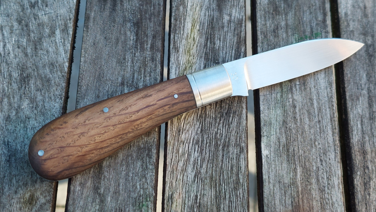

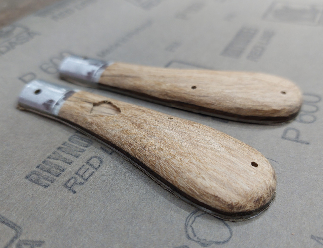

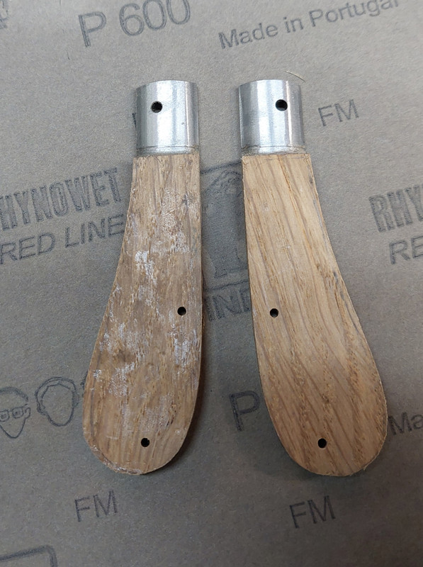

A bit further with the oak handle.
Oak is known for large open pores. If you oil the wood and sand it with the oil still wet, you can fill those pores with an oil/wooddust slurry.
It does take time but imho the result is worth it.

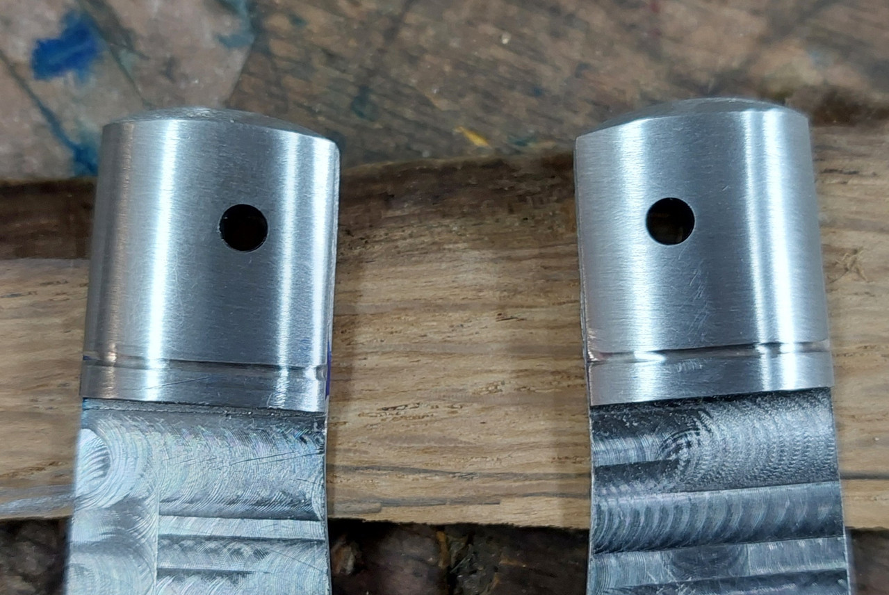

I like the front of the bolster to be shiny and it also has a shiny fluting. Working on details like this is what I enjoy the most.

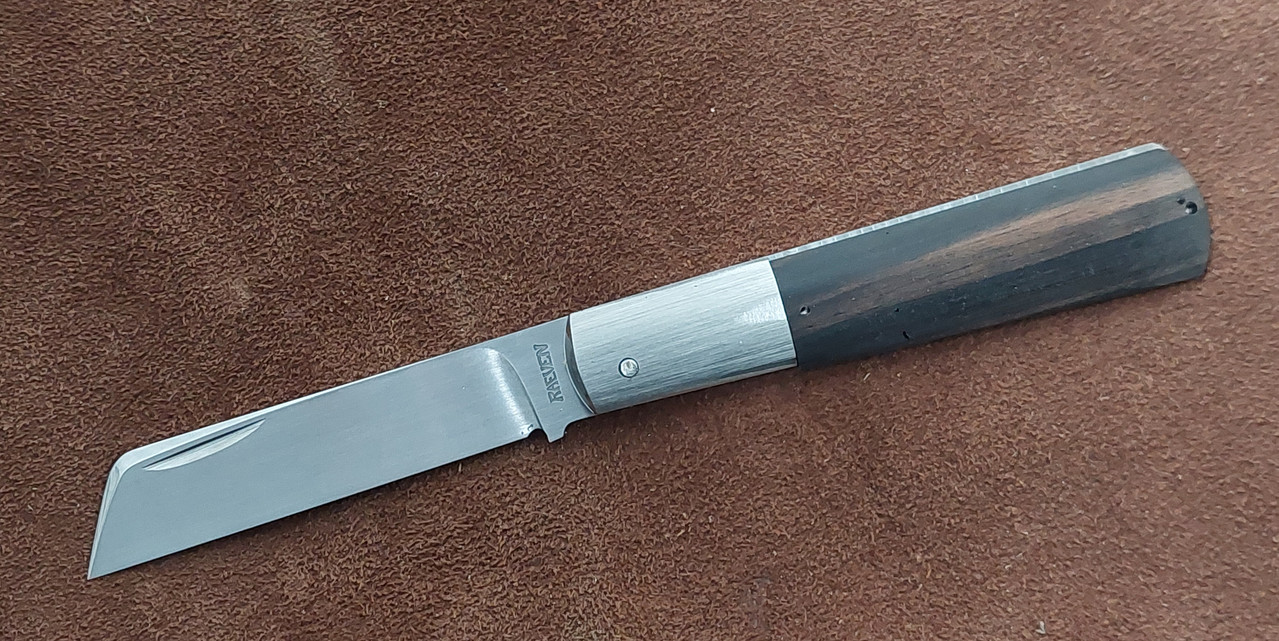

And what is better then a zulu? Another zulu!
African blackwood with a wharthog tusk shield.

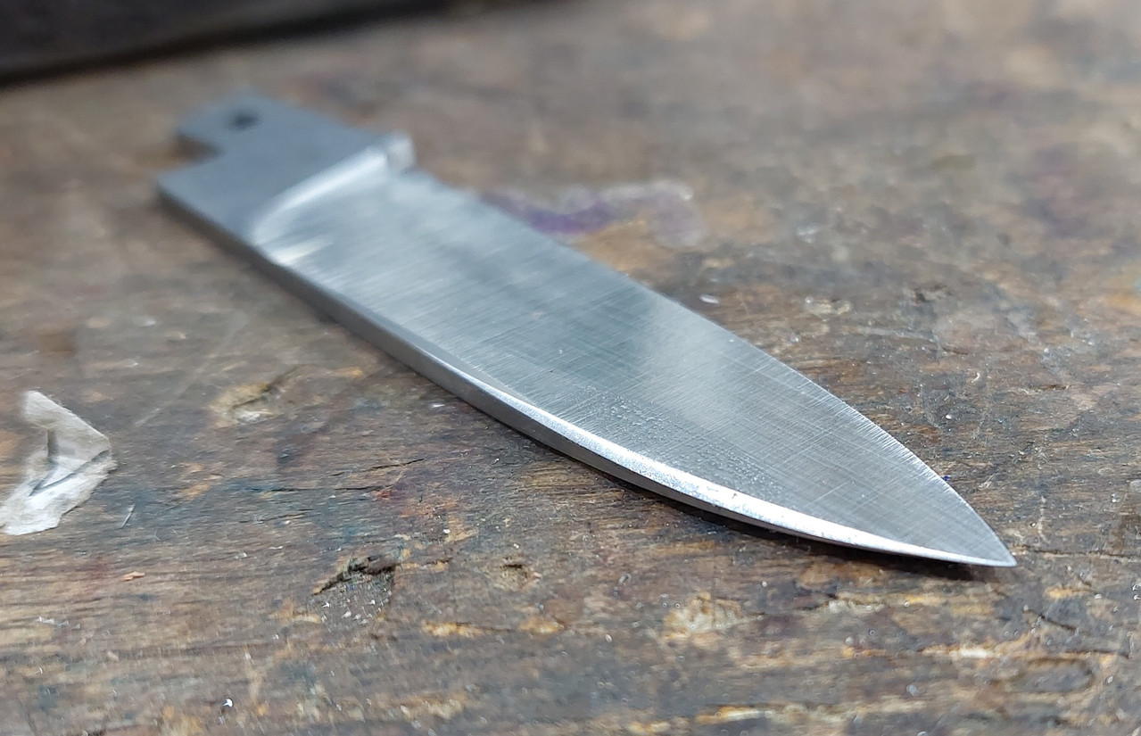

Lets grind!
I'm getting better at grinding bevels I think. Not good enough for a belt finish yet, but I am making progress.

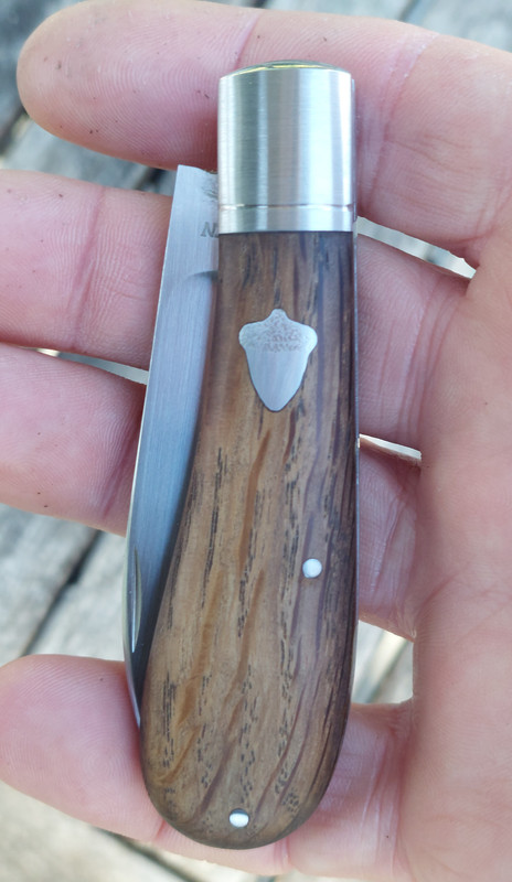

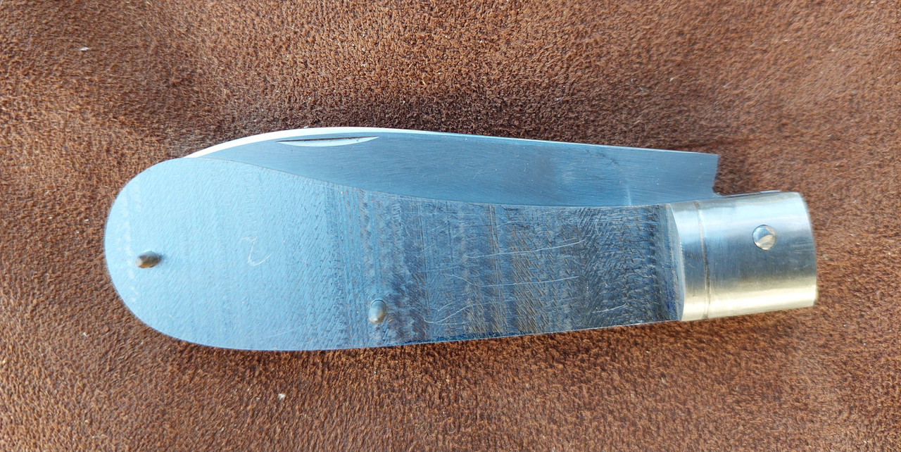

My grandmother used to say: "always stay humble, boy". And those words cross my mind a lot when I work on slipjoints.
The oak handled zulu is finished, but I'll start over again. The backspring is slightly bend causing gaps between the spring and liners.
That's a hard lesson to learn, but I proofed to myself that I can make a good looking oak zulu.
"Always stay humble"

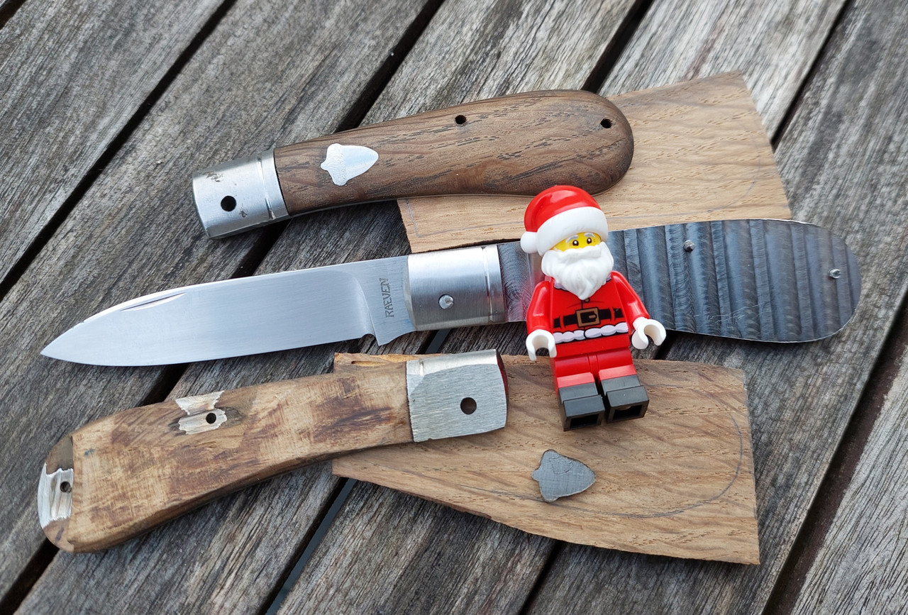

And I saved this one to work on while waiting on knives to come back from HT.

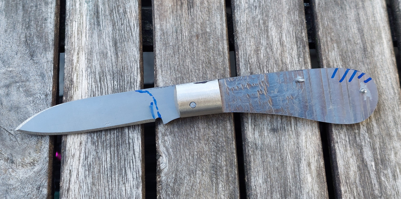

The white shape is how I imagined it before. That's a comfortable handle shape but maybe a bit to large compared to the blade. But I left some extra steel on the spring to be able to change the shape and I redid it more like a fat penny yesterday. I think it suits the knife better.
I also switched to plexiglass for templates and temporary handles. I like it way better then paper micarta.
So which version do you like better?
