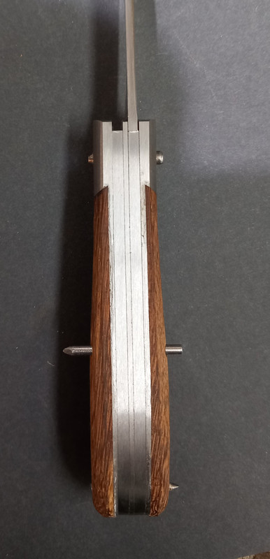

At the moment I prefer to have temporary paper micarta scales before I make the final ones, they help me see the final knife. Working with just the metal liners would do the same but this material is cheap and it works easely. I prefer to fine tune everything like this and then copy it in metal.

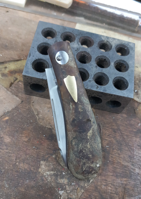

How do you like this marble wood?

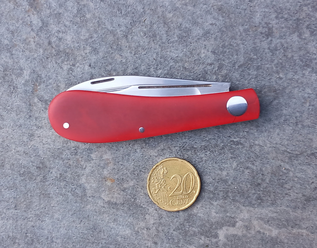

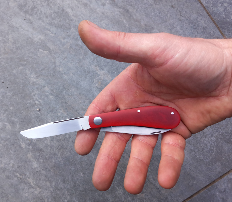

The scales are vintage red bakelite, and I like the colour.
What do you guys think of that material?

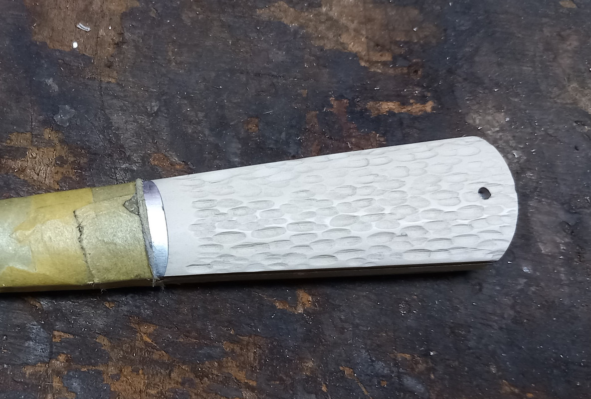

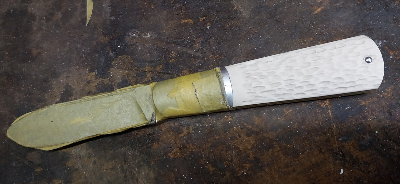

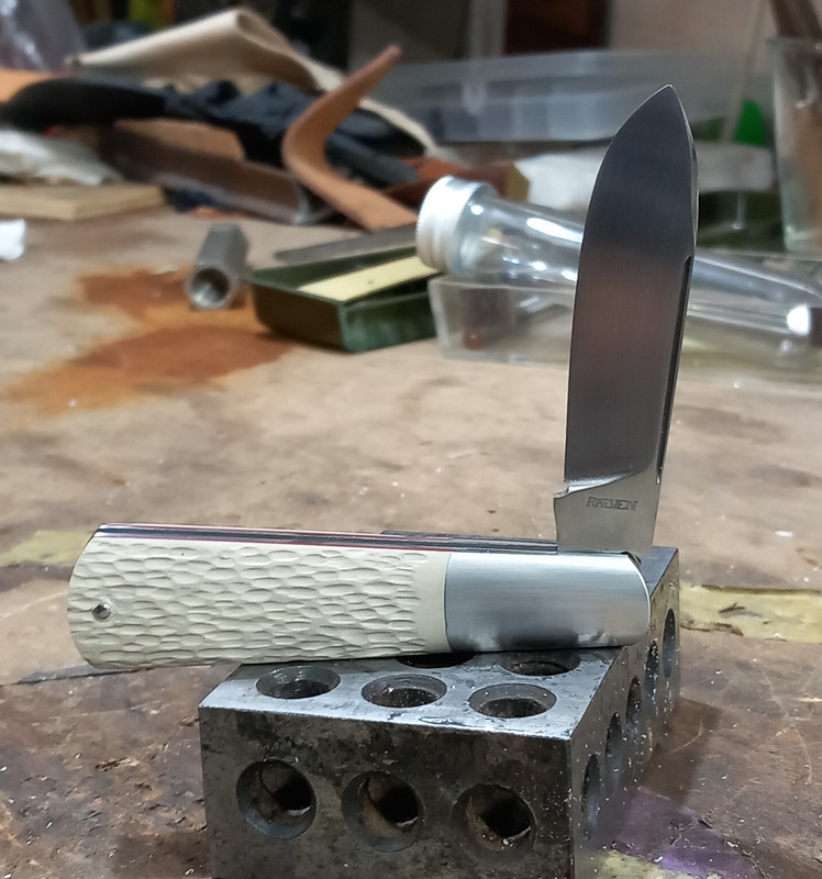

I started over and decided to go a completle different way. I had some white(ish) paper micarta and decided on proper barlow bolsters.
It has a 2 11/32" blade and is 3 5/32 overall.
Jigged paper micarta, hidden middle pin, domed back pin and dovetailed bolsters.
I'm learning how to make these sliojoints, I decided to have some fun :)

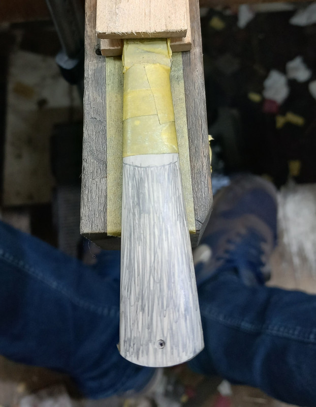

I have a nice workshop and a good grinder. I grind sitting down. I also have a pantograph machine that has multiple uses.
Inlay shields, mark/number blades and I use it for nail pulls/nicks.
I don't have a disksander, this is how I keep the sides straight

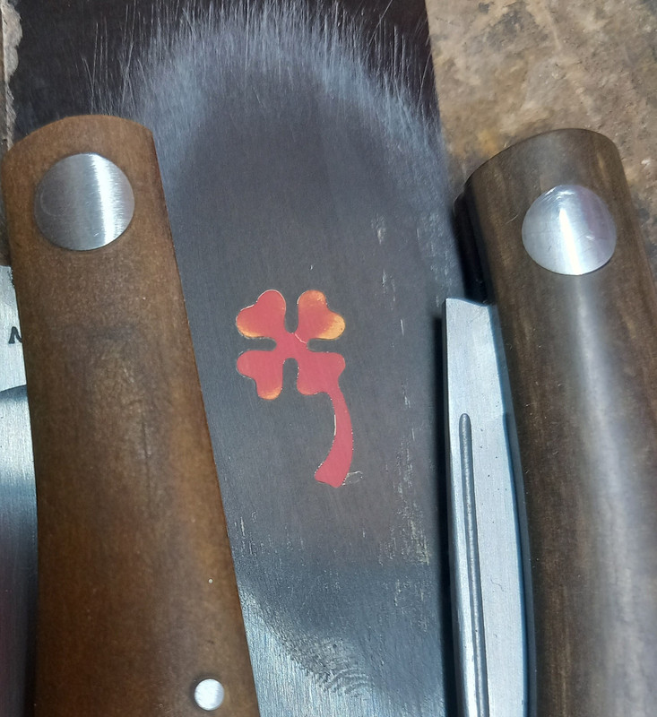

After a while I was able to let the pivot disappear in a shadow disk or bolster. And then out of nowhere they started to come back. All that work and this little ugly 3mm circle keeps looking at you!
I tried different techniques, different tools, but nothing helped!
It ended up being the pin stock. I have 3mm holes and 3mm pin stock is not exactly 3mm.
The stock that showed up in the bolsters is 2.94mm. I now have 2.97mm and I'm back in the game!!!
0.03mm ~ 12/1000" (twice the thickness of a human hair)
You guys can't imagin how relieved I am!
