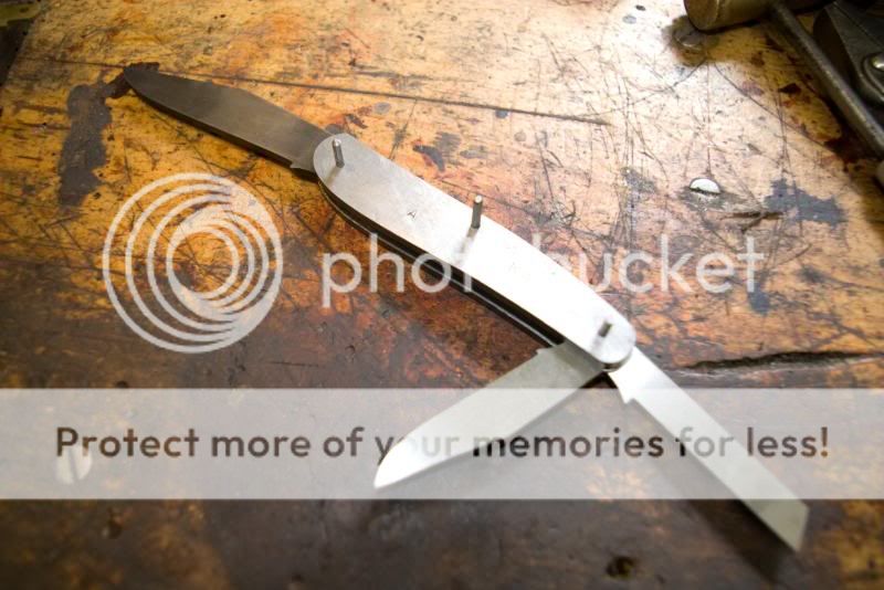

Let me start by saying that I hope you enjoy watching me struggle through building a couple of whittlers. Both of these knives are sold however I think you may find it interesting to watch the progression. This whittler is based on the Case 6380 , a three blade whittler that features a secondary clip blade along with a coping blade. I was sent an intact 6380 by a BF member which gave me the outside dimensions. I did not take the knife apart so what your seeing being built here is a working prototype. I will then use this pattern to cut the springs and blades. I hope to update in the evenings.
I am going to start a little bit into the knife as I needed the blades to be heat treated before making the springs. (remember that other slipjoint builders will do things different than I)

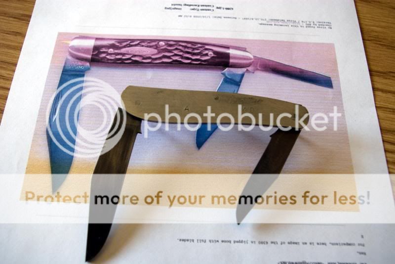

This shows the Case 6380 printed out with the frame , master and one secondary in frame.

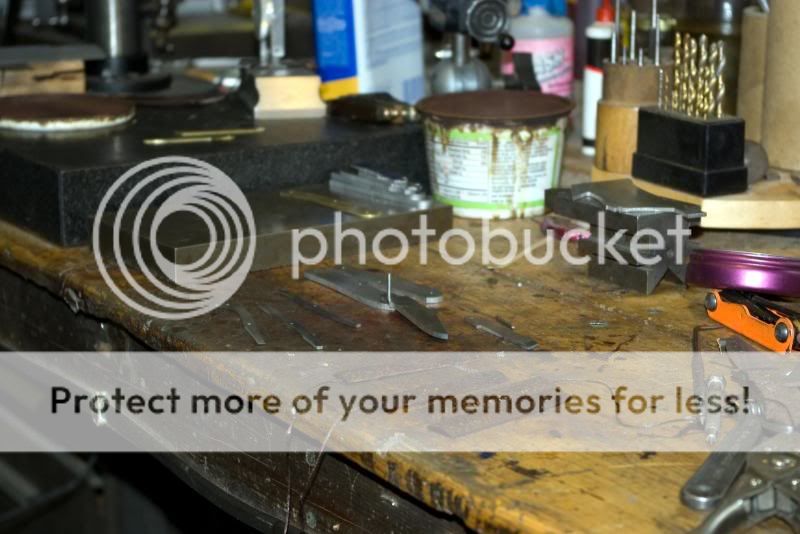

A few parts laid on the bench along with the scales. My jigged and dyed bone

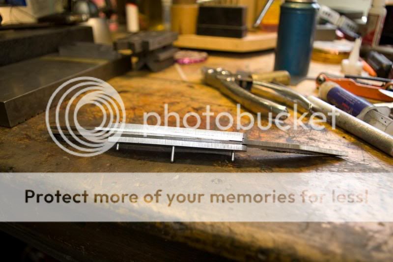

This shows the springs and secondary blades before they are ground to half the thickness as the master blade tang

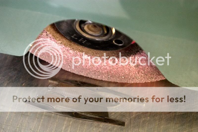

Getting ready to surface grind the secondary blades and springs

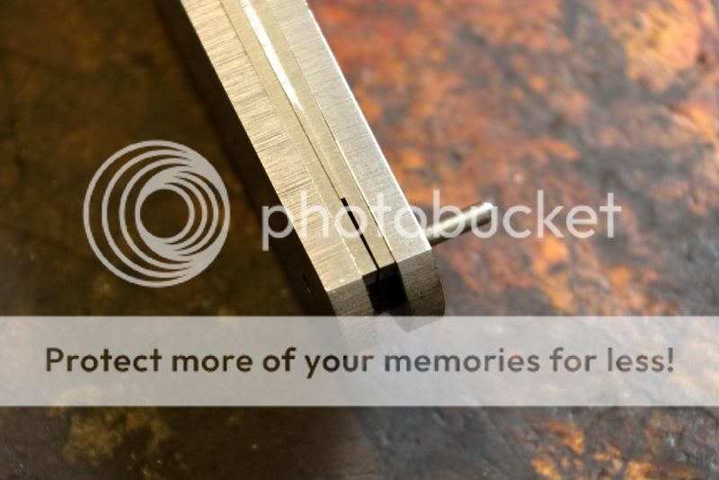

After grinding blades and springs. You can see that my center tapered spacer is too thick at this point. I want the tips of the springs to touch with no gap.
I have both springs and the three blades working in the frame. I have left most fitting points "proud" at this point.
Ken, to close the gap (so to speak) I take it you're grinding the springs and not the tapered spacer ?
Either way, not much wiggle room there. :eek:
