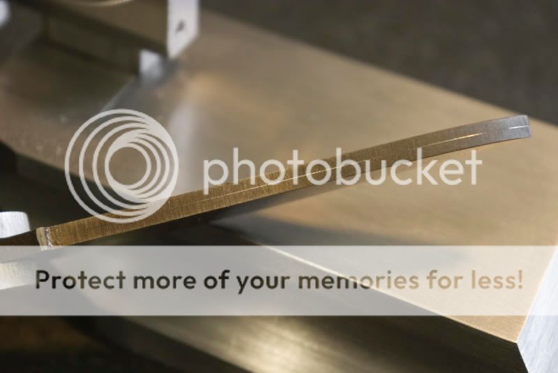

I grind the spacer down to about .010 or a tad less, gets like a knife but any thinner and you would have problems.

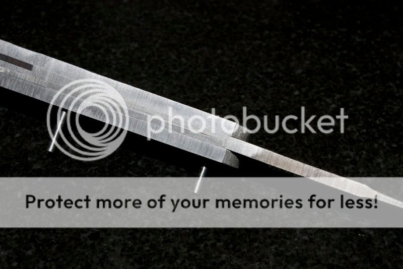

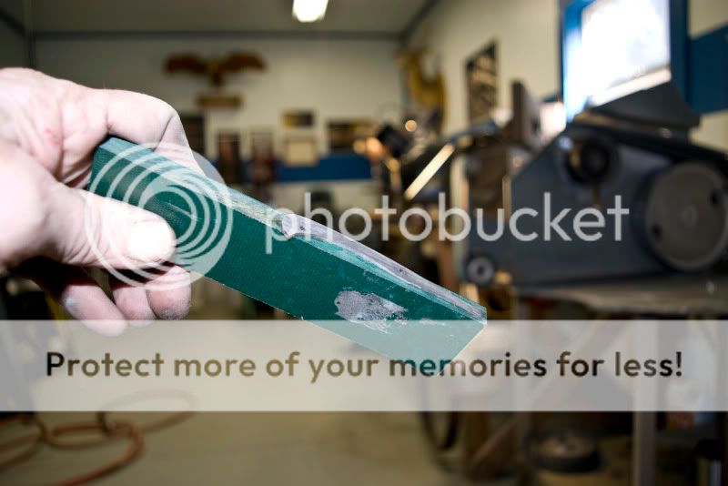

This is my spacer grinder! A piece of Micarta with the spacer super glued on.
This is real close on the spacer, you can see the gap is closed. It leaves a tiny triangle shaped void.

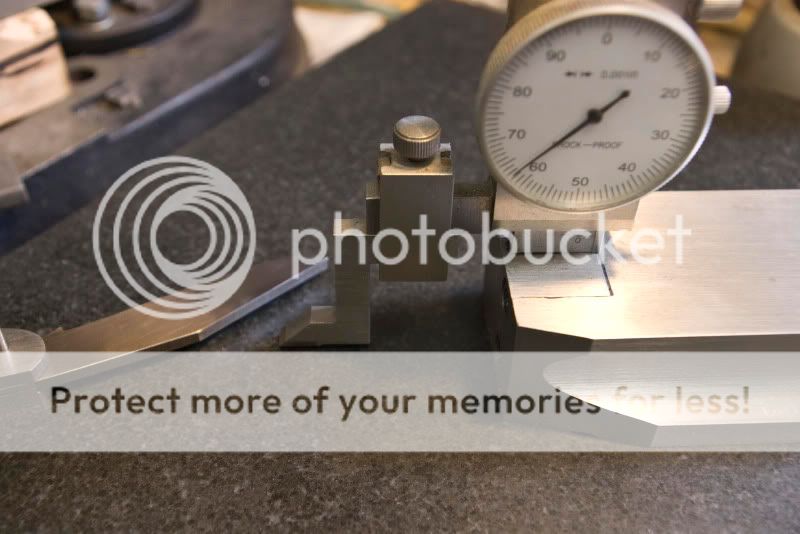

Its important both springs are the same especially on the master end were both springs rest on one tang..

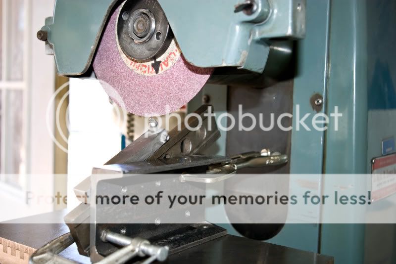

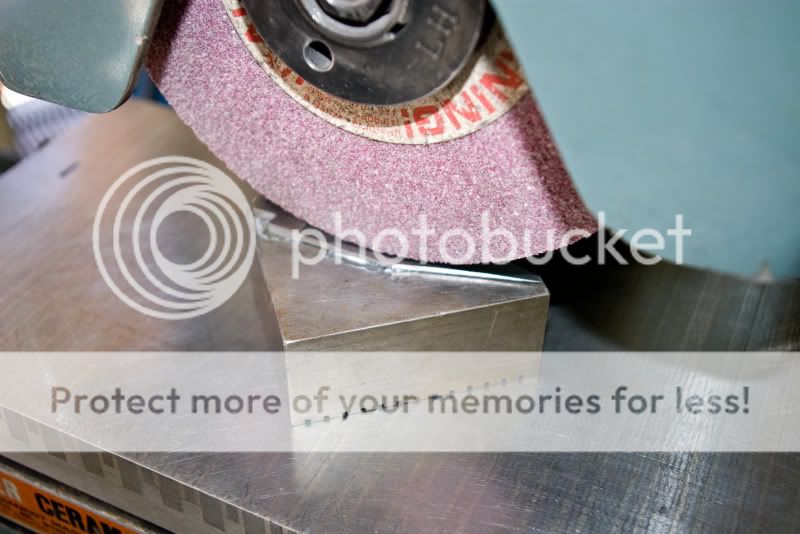

I use a surface plate and gauge to mark a center line before I start to grind.
The center line scribed ready to start grinding.
This is the very beginning of the grinding. You can see already the blades are starting to fit in the frame.

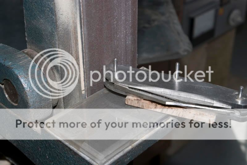

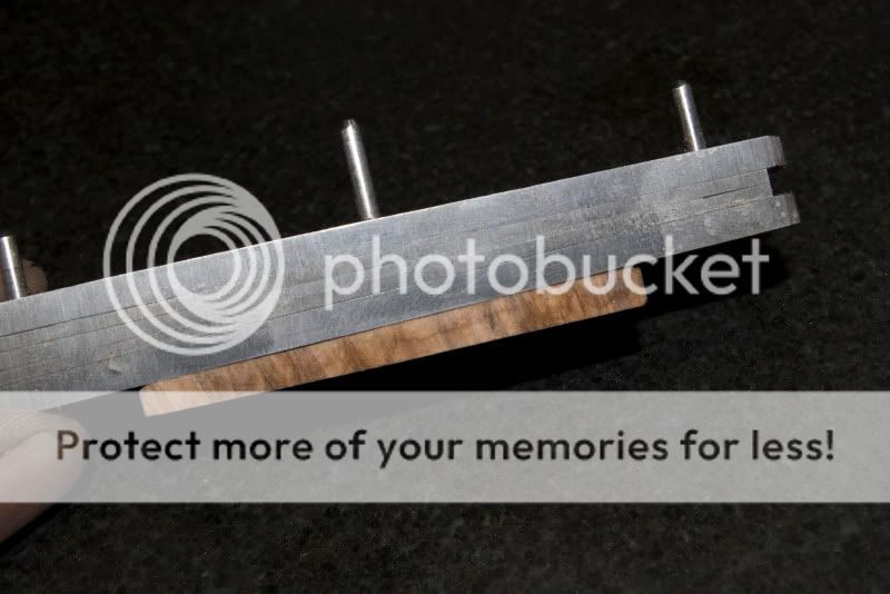

This picture shows a small wedge piece of hardwood super glued to one side of the frame. This allows me to square the ends of the knife up.
I use ceramic glass on my plattten and rest to keep things really square and flat

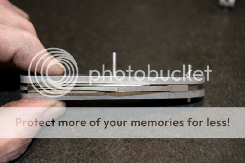

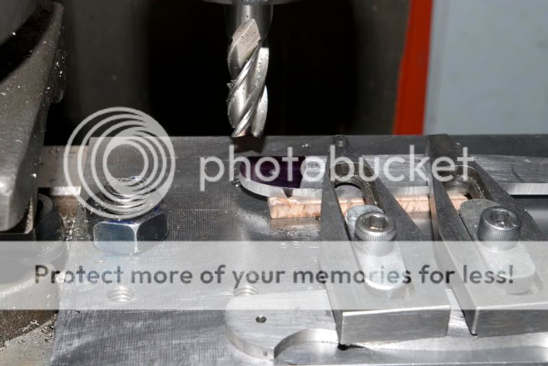

This is a extra step for this type of whittler. I am milling a matching angle from the front of the frame to a bit behind the pivot pin. This allows the master to be centered with good bearing when closed.
This is my rotary set up for milling the clearance for the tang.
This shows the milled frames , keeps the tangs from getting scratches.

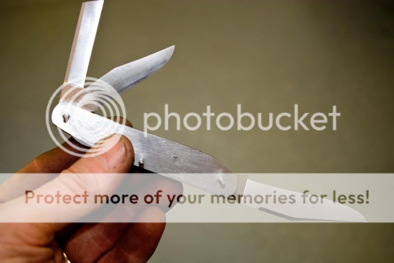

This shows the how the blades are starting to fit into the frame.
Things are progressing slow but steady at this point. I have all the tangs fit, rise and fall flush on the three blades. The next step will be to refine the grinds, cut swedges for clearance.

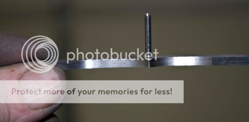

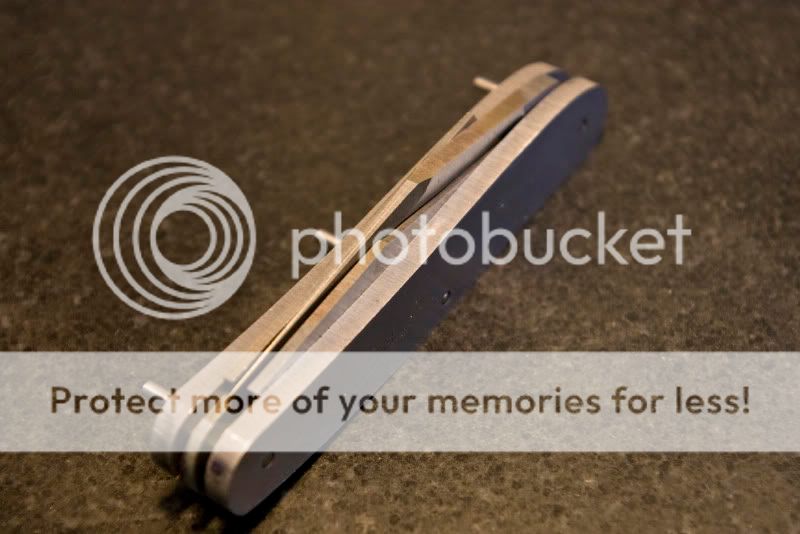

Ken, one question (excuse my complete greenhorn ignorance); in the photo of the milled frames, it looks as though a goodly amount was milled off, yet in the top down photo it isn't noticeable at all. Is it just the lighting that's causing it to look like a quarter of the thickness was shaved off, when in actuality it might be more like hundreths of an inch?
Great thread!!!
Eric
Great thread!!!
Eric
Eric,
Good question. It is the lighting. I mill .006 to.008, shooting for .007. I have found this to give best results. When I build a multi-blade with center liner being releived on both sides I end up with 1/2 the thickess as I normally use a .030 thick liner.

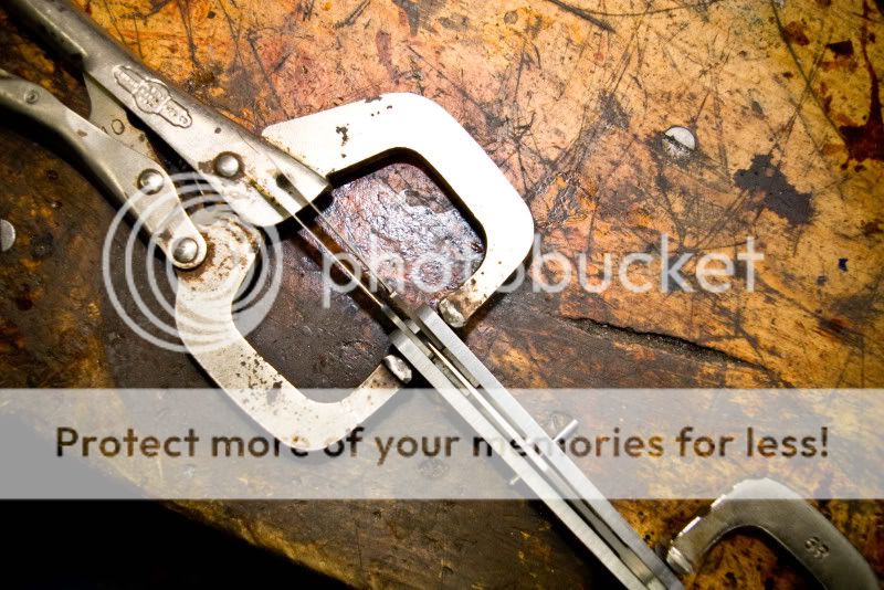

I just modified a set of Vice grip clamps to hold the frames under the same tension that the peened pins would have. I use hardened assembly pins(old 3/32 drill shanks) when I build a knife. I drilled a hole in each leg of the clamps that accept the pins. This way I can clamp right over the pin and adjust the tension. This helps me get the blade center right before I put the knife together for the last time.
You can see the grinds are really really close to be done.
