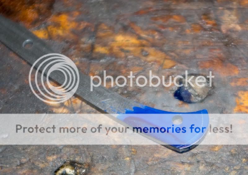

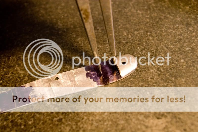

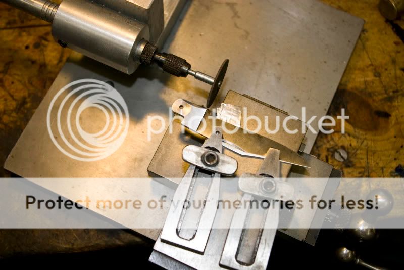

This shows how I cut my choils. I scrounged a little compound from the local used machinery guy and made this choil cutter. This allows me to cut consistent choils from blade to blade and knife to knife. Overkill some might say, but I like it.

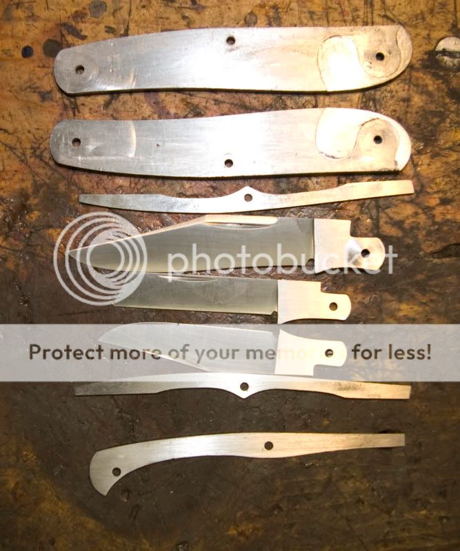

This is the layout of the parts with choils and nail pulls done

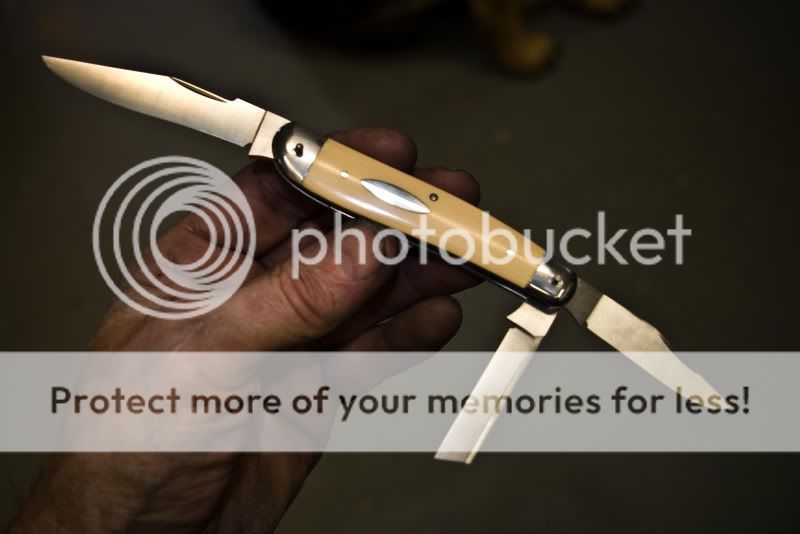

I made pretty good progress today on this knife. Tomorrow I will take it apart (again!) and make patterns for the next two. This step of making a prototype was a necessity for me. I will make subtle changes in blade shapes, run-ups, nail pulls etc.

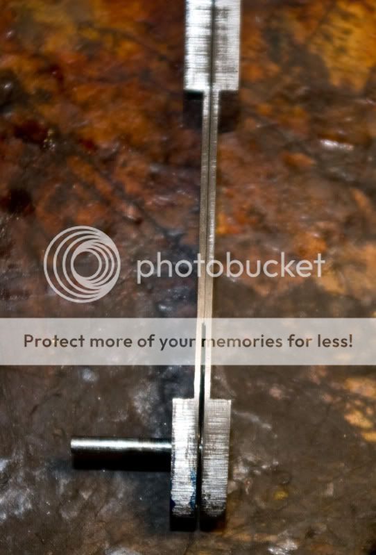

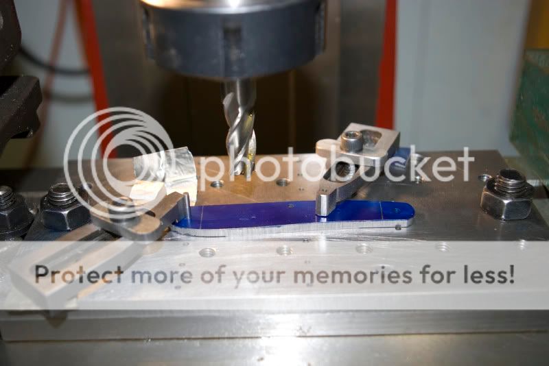

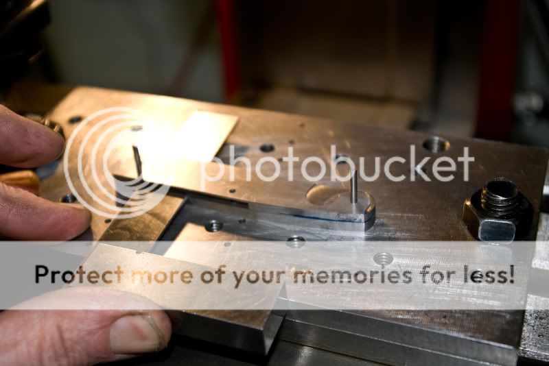

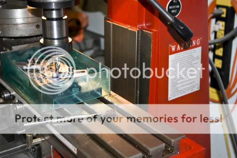

This next set of pictures shows how I get mirror frame/bolsters. Keep in mind that many makers will do this step differently than I. I am getting ready to mill the material away between the bolsters leaving .032 thickness
I have made a small lexan box to contain as many flying chips as possible. Not because I am a neat freak but keeps down on the flat tires
This shows 1/4 of the milling done.

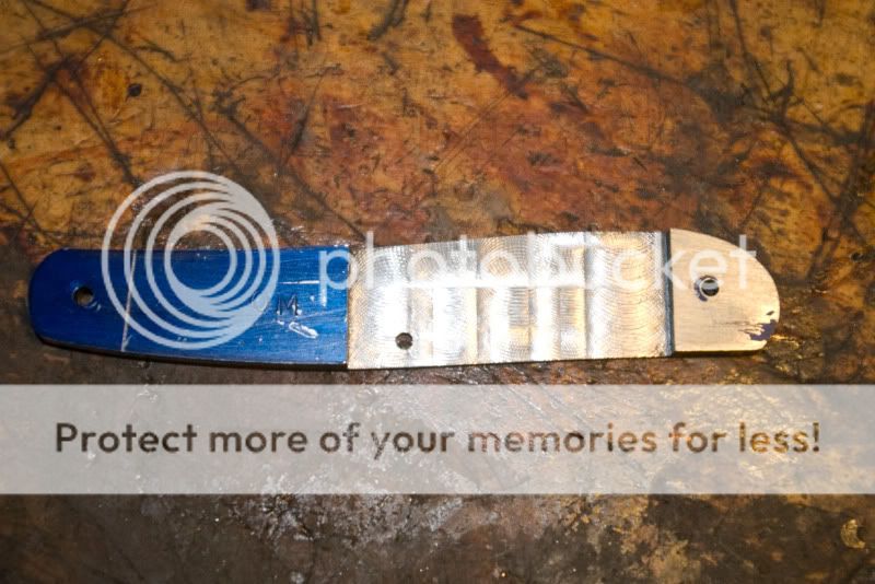

This is how I get a mirror , or matching pile side/mark side frame. You can see that I have the side needing milling down on my tooling plate with the already milled opposite frame on top. I use a square to pick up the bolster and square it with my tooling plate. Using the stops set on the milling table allows me to mill the new bolster to the right angle and length as the first.
After milling both sides and both ends, if I did my part, I end up with a true mirror mark and pile side.
I use a surface plate and scribe to mark the bolster before rounding.
This picture is staged as I was not able to hold the camera and hold the frame as I round the bolster with both hands.

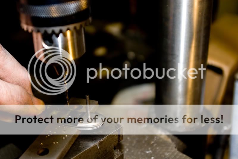

After rounding all four bolsters I mark the location of the holes for the scale pins

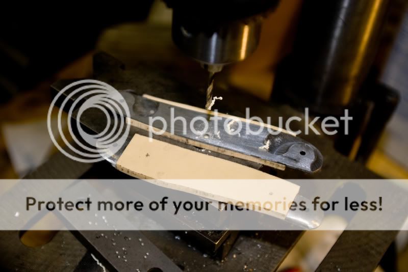

I use the first side as a template to drill the opposite side frame

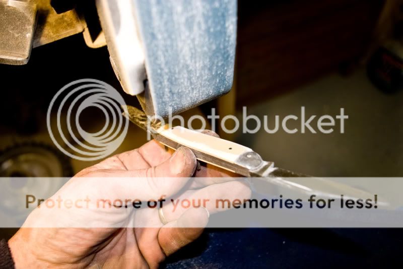

I have fit the Pre-ban elephant Ivory, RELAX guys, really antique Ivory Micarta on this prototype. :eek:
Shaping the Micarta on my belt grinder.
Starting to look like a knife!

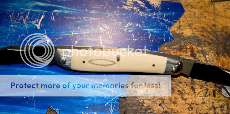

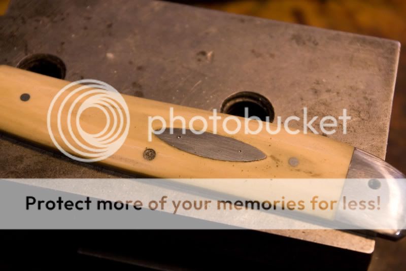

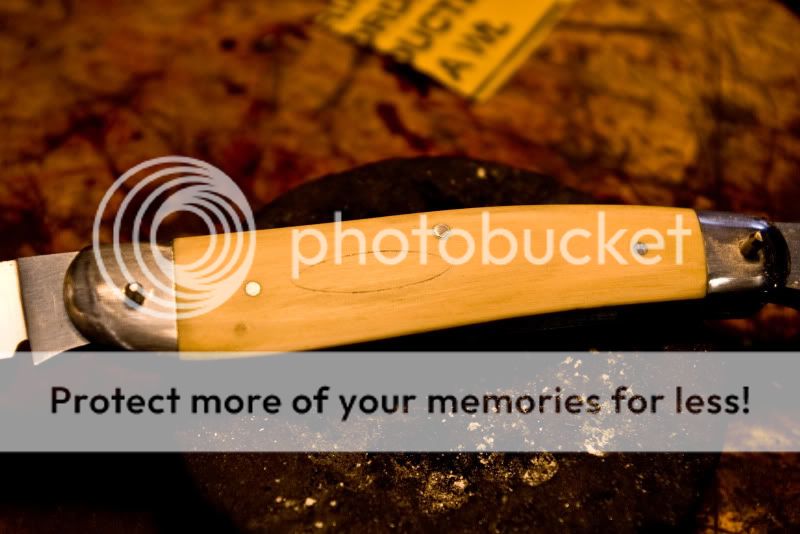

I will be insetting a oval shield in. Certain patterns lend themselves to certain shields and I think the flowing lines of a serpentine jack or whittler is a pattern that a oval shield fits. You can see that I just penciled in the shield
I use a porta-band saw for cutting all my parts, frames, blades,springs, and shields
I super glue the shield in place on the mark side then use a scribe that is really sharp(a needle would work also). I scribe around the shield carefully a few times to cut into the scale material.
This picture shows the scribed line ready to remove the material inside the lines to accept the shield

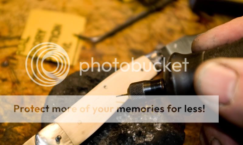

On this shield I am using a Dremel tool with a 1/32 dental burr. Again , many different ways of inletting a shield including the traditional parser plate and parser.
Provided I did not drink too much coffee this is what you should end up with. I have the two pin holes center punched. I will drill these with a 1/16 bit

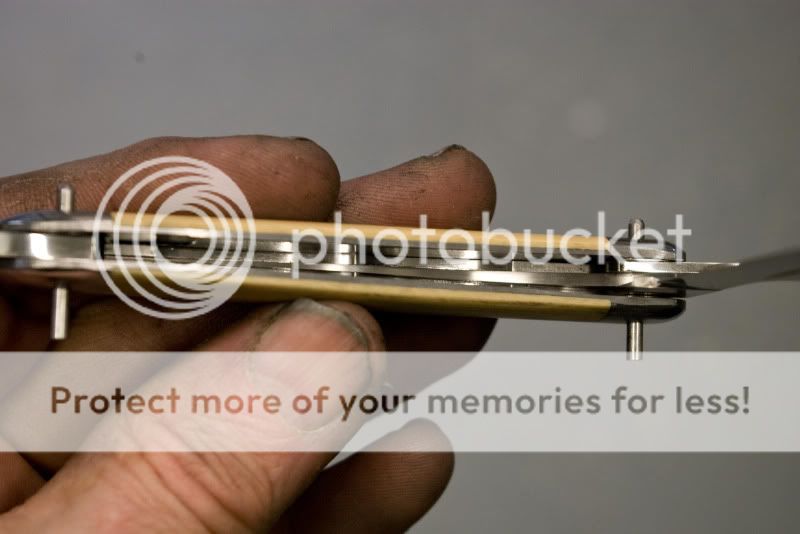

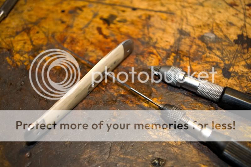

These are the two tools I use to set the pins. I use the long tapered reamer from the front side and the short tapered cutter from the back. The long reamer leaves a tapered hole that makes it easy to hide the pin.
I am at the point were I spend a lot of hand sanding time cleaning things up. I use various sticks, files and wet or dry paper to take the inside of the frames to about 600 grit. The mark side frame on top has been cleaned up a bit. You can see the pins for the scales and shield are pretty much hidden on the inside also.

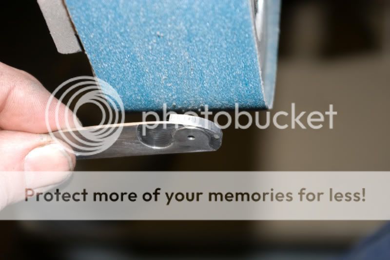

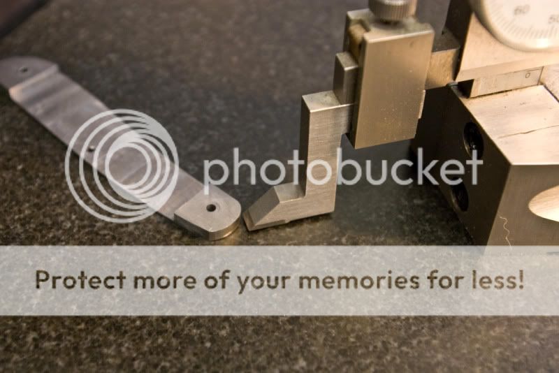

One of the items that has to be taken care of is to mark the center spacer and remove a bit of material to keep from the tangs being scratched. This would be difficult to hold and mill. I do it by hand on my belt sander

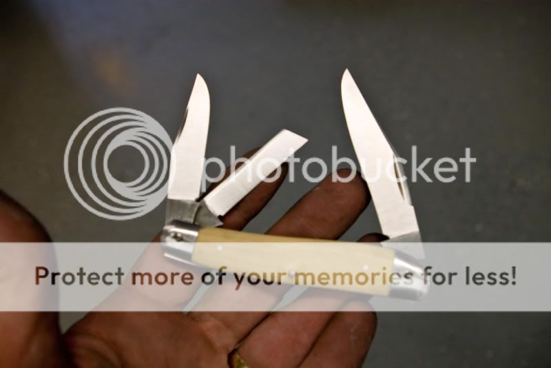

This shows what can be expected from the inside cleanup work. With a whittler or stockman the well is much more open than a single blade or jack with a center liner. This being the case its more important to get a better finish inside.
For the most part all that is left is lots of hand work. Finishing the inside, making sure the bolsters are nicely rounded.
I will have a few more pictures showing how I peen the pivot pins then a set of completed pictures along with a few notes on what will be done differently on the next two knives. I plan on also showing, noting the flaws in this knife so others, including myself , may learn from them.
