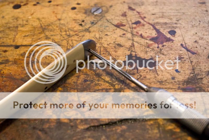

This shows the reamer I used before peening the pin. I ream about 1/16 deep.

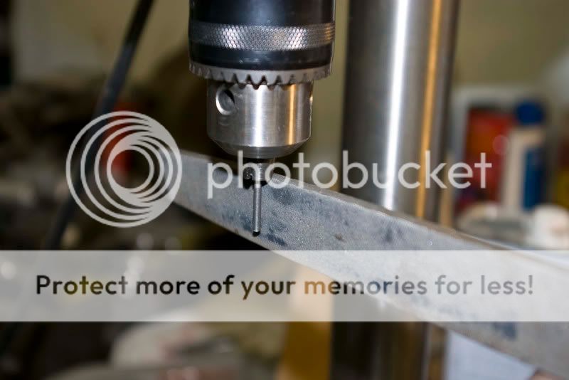

I prep the pins using my drill press and flat mill file. The pin stock comes a bit oversize. I like the pins to fit nicely in the bolsters and a bit loose in the tangs.

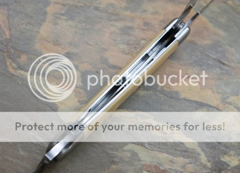

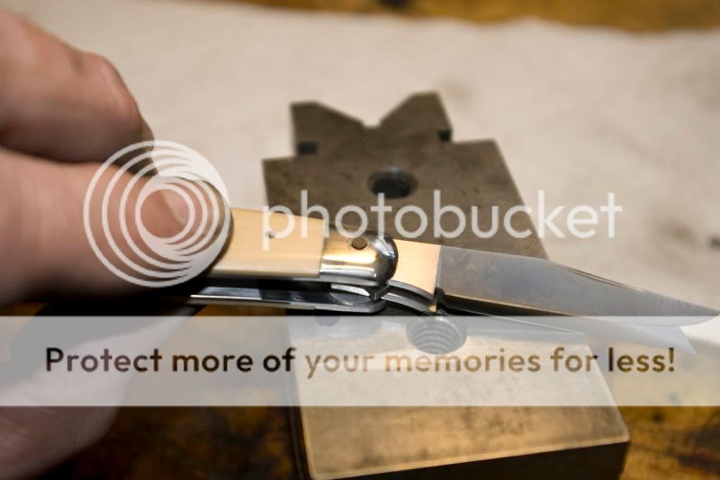

I leave the pins about .030 to .050 proud. The first couple of whacks are pretty hard as I want them to swell in the bolsters and grab hold. I continue this as I check the blades for free play. When all the free play is out I then tap much softer around the edge of the pin to fill the void left from the reamer

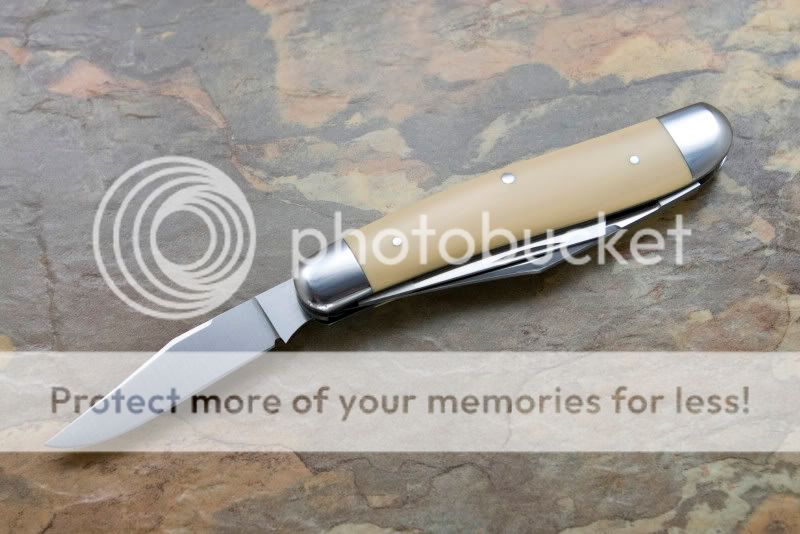

Ok, Here goes, the flaws:eek::grumpy:
The nail pull on the secondary clip is too close to the top edge of the blade.
The shape of the master for this pattern is a bit "off". The clip should be shorter or not so far from the tip to the spine. When I make the change it will allow me to run the nail pull farther from the tang giving a bit more leverage to open.

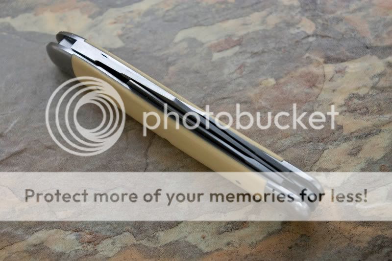

While all blades pass each other and close without guidance the secondary blades touch the sides of the frames. I know how to correct this in the next one.
Overall I am real pleased with this knife, the CPM154 blades sharpened up great, good walk and talk. This knife has a lot of blade in a thin frame, .470 at the widest point. 2 1/2 oz.
