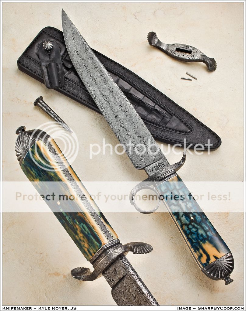

I do have one question. Did you guys ever consider using ivory? It would have looked just as good I think.
Hello David.
No, ivory was never really considered as I thought the dark color and rough texture of a nice bark amber stag would be a nice contrast to the more elegant look of the mirror polished stainless. But, I agree with you as a dark-high bark mammoth would have served the same purpose.
In addition, I have the Royer Bowie below with ivory scales so thought it would be nice to have one with stag.
Kyle did a WIP for that Bowie as well. http://www.bladeforums.com/forums/s...e-Progression?highlight=Kyle+Royer+Ring+Guard
I well remember the blue bowie Kyle made, Kevin, yet another marvelous work of art. I agree the amber stag looks superb, I was just curious about the ivory. I do believe you and Kyle made some superb material and design decisions, and the execution is about as flawless as I've seen.
