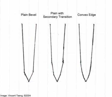

Sharpness - most people judge sharpness by things like shaving - however this is only a very shallow cut testing the actual edge only -
ah! I hear you cry but that's what makes a blade sharp!!!
Yes, and No.
the final edge is important - but the whole point of the WSKTS is that it puts a convex profile edge on the blade - shaving and shallow cut tests do not show any benefits of the convex edge - so all those tests saying it will shave or even cut free hanging hair etc - although are impressive - they show absolutely nothing in the convex edge benefit.
Unless one actually shaves with the blade - to me it more important that a blade cuts well (dUH!:rolleyes:) this normally means cutting through things - this is where the convex profile shows all the advantages - please look at the near legendary pdf article on sharpening (manually) - Sharpening a Knife - Information & tips from a veterinarian whose wife & meat cutting put him through college - by Dee Griffin, DVM - I posted the relevant page (4) in post #158 (link)
Or these:
A convex edge allows the blade to glide through material better than a plain V edge which basically wedges through material - one can see an edge with secondary transition bevel is an improvement - but the ultimate edge is one with a convex profile.....
so to summarize - this is why I use, and am impressed with the WSKTS.
