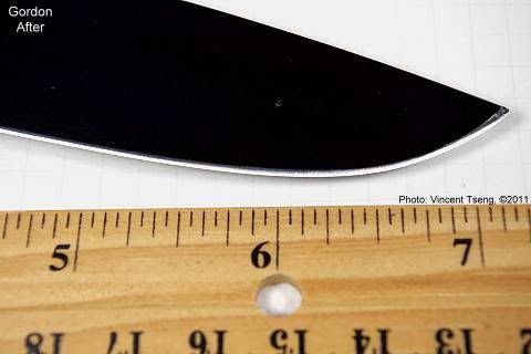

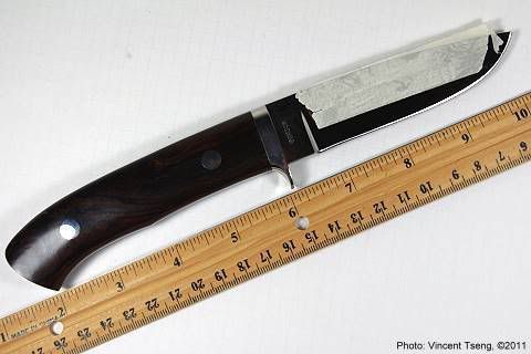

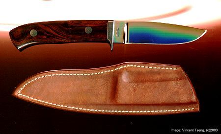

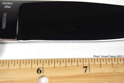

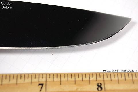

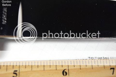

OK.....
for my next sharpening - I was really in trepidation
It is one of my most cherished knives -
a custom order ironwood drop-point hunter by the late Gordon DeFreest
I foolishly thought I could put a better edge on it years ago - and kind of regretted trying to do that - no matter how careful I was it just didn't look that good. With such a cherished knife not only had it to be functional - but it had to look good too (at least to me).
Don't get me wrong - I do know how to sharpen, so it is sharp....
just not so good looking edge....
So with the Work Sharp I thought I could at least get it to look good again too - and redeem myself...
but to be sure I did not have even a remote possibility of marring the finish -
I taped it up:
I held the blade straight/vertical to get a 20deg edge - but in the outdoor knife guide -
3 passes with the P220 I could feel a clear burr - then 6 passes each side for the 6000 grit
and yes I have now redeemed myself, phew! -
The edge now looks good too
and is probably better than it had at any time -
yes, it does cut through like crazy.
Pardon me while go calm myself down, and have a cup of tea......
Vincent
