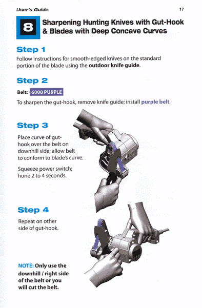

It is only if the curvature is very narrow like serrations that the 1/2" belt would not be "narrow" enough -
I want to clarify the Work Sharp does sharpen serrations -
not by getting into the curvature of the serrations - but by taking off metal from the flat side.
In the instruction manual they even show how to sharpen the narrow inside curve of a gut hook -
which shows how versatile this sharpener actually is.
