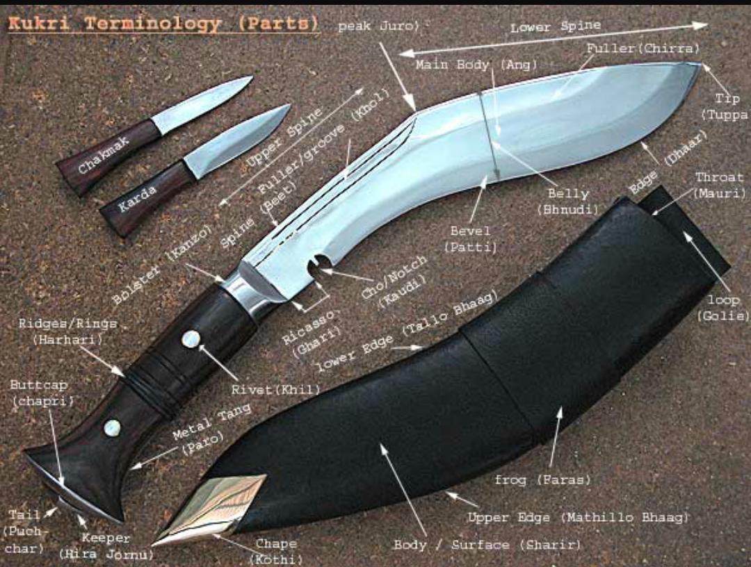

Are we talking about regular straight-ish blades or blades with any kind of curve, like a kukhri or some kind of Persian style blade or some kind of exaggerated trailing point? If we're talking about the latter, then I'd say forged because you can keep the grain running in line with the curves of the blade.

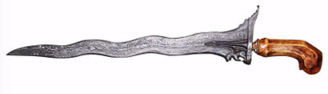

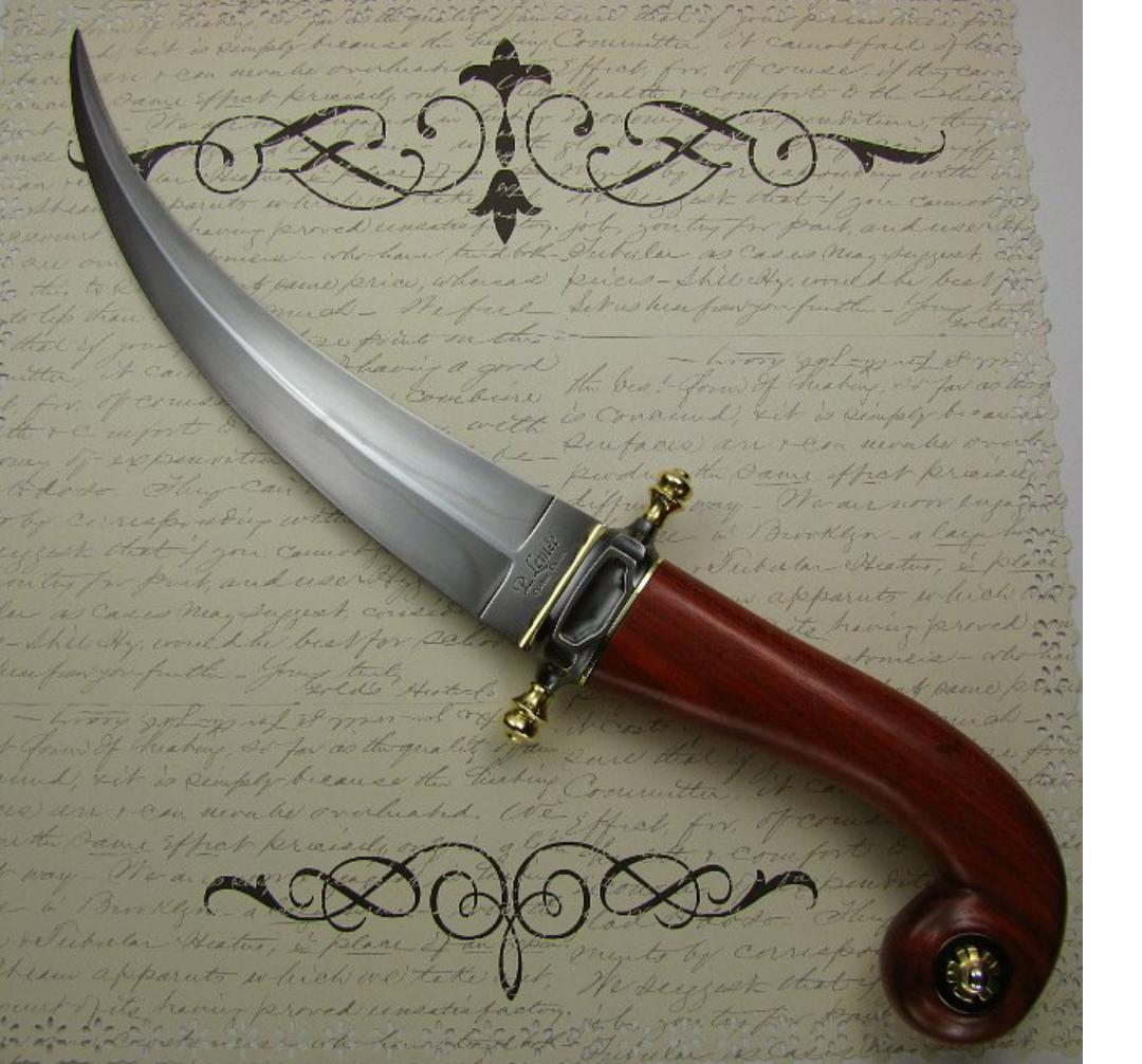

A kris type knife is a pretty obvious example of where forging over stock removal should be utilized. The reason forging a kris is beneficial is the same reason forging any curved blade would be beneficial. Not to say it can't be done with stock removal, but forging is better for certain applications. There are whole industries dedicated to this. Industries don't form out of thin air and without good reason.
Traditional Indonesian kris:
Kukri:
Persian dagger:
All of those examples would benefit from having the grain follow the curve for structural strength. Production companies use high shock/ high lateral strength steels that try to make up for the inherent weakness of stock removal. When you forge those same steels then you will see an increase in strength due to the shaping of the grain flow within the blade.

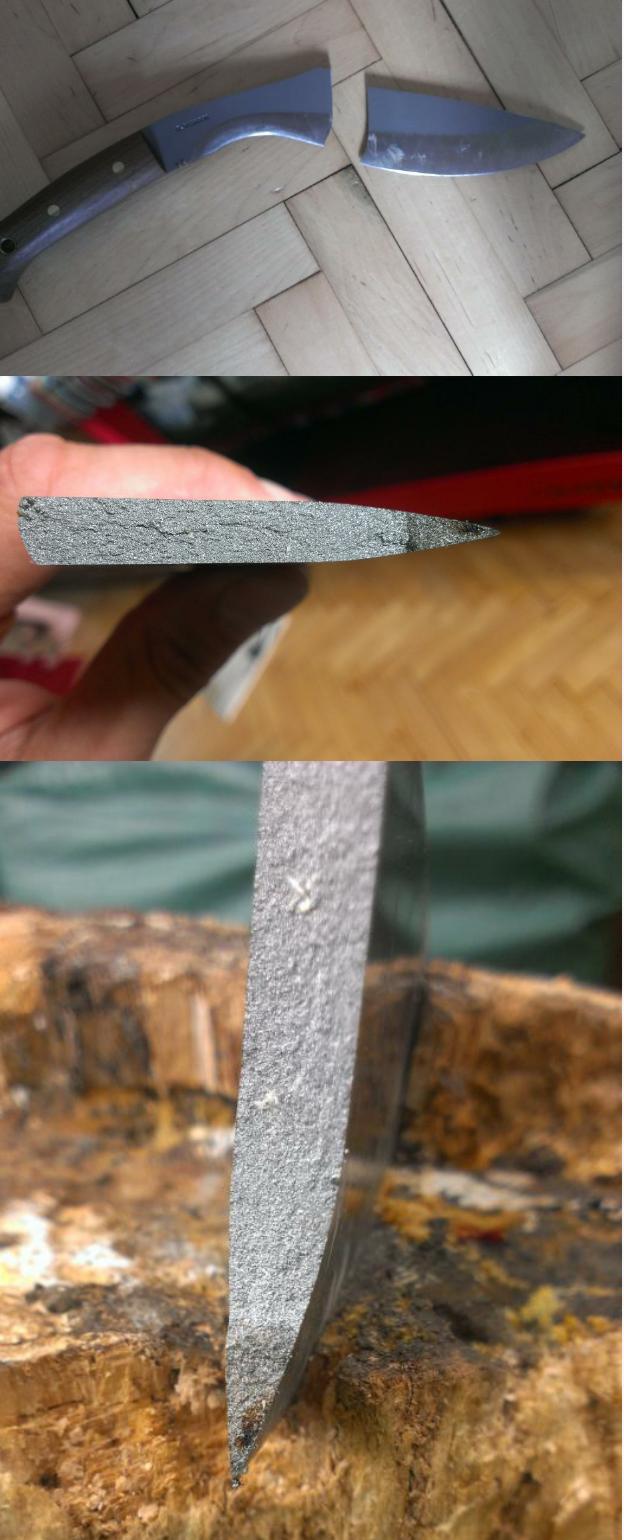

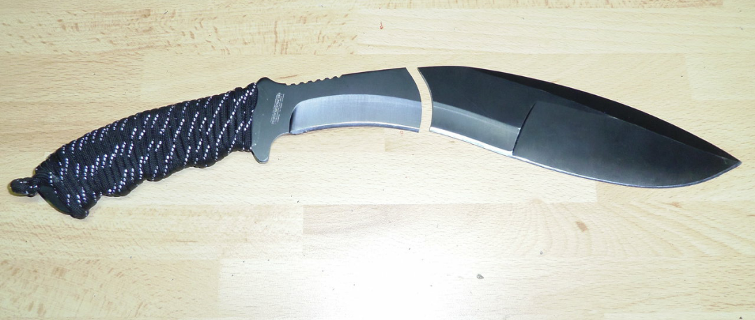

http://www.bladeforums.com/forums/s...-failure-on-8mm-thick-Condor-Heavy-Duty-Kukri!
Now obviously there's some other stuff going on with that blade, but take a look at where it snapped. It's right where the heavy impact meets the wrong grain pattern. In that case I don't think forging would've helped much because I think they blew the heat treat but it shows where the real weakness is in that kind of blade and how forging would reduce the weakness.
And another one, note that it's in the same location, right where the grain should start to follow the curve but doesn't.

Bodog, there is some more bad going on with that last knife, lol.
Anyway, I agree with what you say and I wonder how many companies even consider steel grain direction when they do stock removal. If they cut out their basic shapes with grain lengthwise but to tip or if they cut it transverse, spine to edge. This will also explain a lot of fractures. Still, properly manufactured, a stock removal blade will be easily as strong if done right. Which brings us to CPM, which has no grain direction and is like particle board(in idea not strength). But if you want real strong forged, then you go folded like this. Tripple folded 15 times for 1 million layers.:D
Thank you bodog for this picture and the other information. Pretty impressive how the grain flows there.

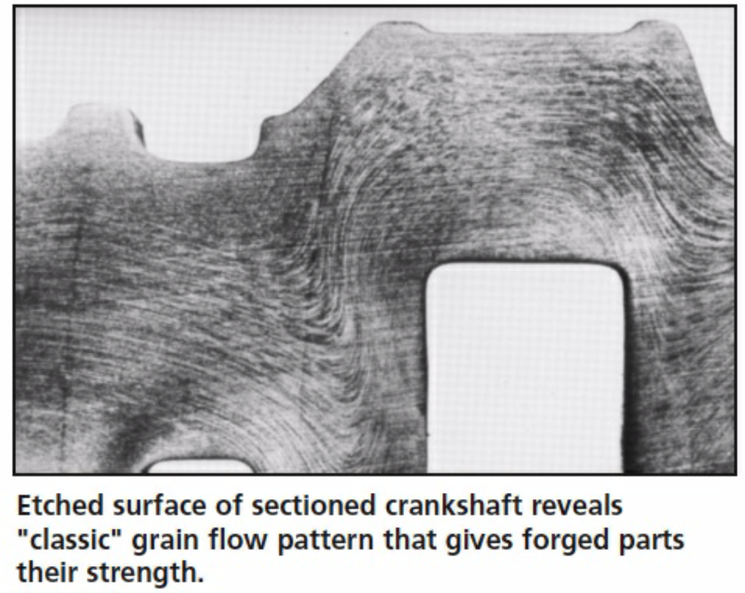

Grain flow is one of the major benefits cited for the use of forgings. Unfortunately, there are misconceptions on the topic, which include the underlying causes of grain flow, the benefits that can be accrued from grain flow and how to achieve an optimum grain flow. In the best case, grain flow results in a delighted customer and aforging that thrives in a critical service application.
To begin, let us provide a definition of grain flow in forgings. Grain flow is a directional orientation of metal grains and any inclusions that have been deformed by forging. Individual grains are elongated in the direction of the metal flow or plastic deformation. More importantly, nonmetallic inclusions, particles and other imperfections inherited from the casting process are elongated in the direction of grain flow. It should be noted that grain flow occurs to some degree in all metal-forming processes, not just forging...
Effect on Mechanical Properties
The important implication about grain flow is that some mechanical properties vary with respect to orientation relative to grain flow. This fact is one of the major benefits ascribed to forgings. This variation in mechanical properties can be exploited so that the actual product has superior properties in a critical direction relative to those expected from the alloy composition itself.
However, we should be clear that not all of the mechanical properties will vary significantly with the grain flow. For example, strength and hardness are primarily controlled by the alloy chemistry and the heat treatment that is given to the forging. Grain flow will not have a major effect on the strength or the hardness of the alloy. In contrast, desirable properties associated with retarding crack propagation can see significant differences depending on the grain flow and the direction of the moving crack. So, properties like fatigue strength, impact toughness and ductility, which are measures of a material’s resistance to cracking (measured after fracture), can be significantly improved if the crack propagation direction and the grain flow are properly aligned. The optimum alignment occurs when the maximum principal stress (perpendicular to a potential crack or fracture) is aligned with the grain-flow lines...

Going against the grain
One undeniable aspect of forging things to shape, that we can get out of the way immediately, deals with the directional structure of steel from the aforementioned milling process. This condition is the result of the elongation of impurities, voids and inclusions in the direction of the rolling operation resulting in a wood grain type effect, such that the material will have slightly different properties in one direction than in another.
In order to avoid a very common confusion, it must be heavily stressed that the term “grain” in this case has nothing to do with the crystalline structure of the metal, such as an “austenite grain,” but instead refers to this directional property, as in “going against the grain,” and is not affected by annealing and other heat treatments. The condition where a property of a material is different in one direction than it is in another is known as “anisotropy,” and we will examine it again later in this discussion.
The quickest and easiest way to demonstrate how forging can affect the properties of a tool via this directional nature is in the classic crank shaft example

A crankshaft is a complex shape, modeled in three dimensions and subjected to a variety of loads.
A blade is not a complex shape, however curved it might be.
