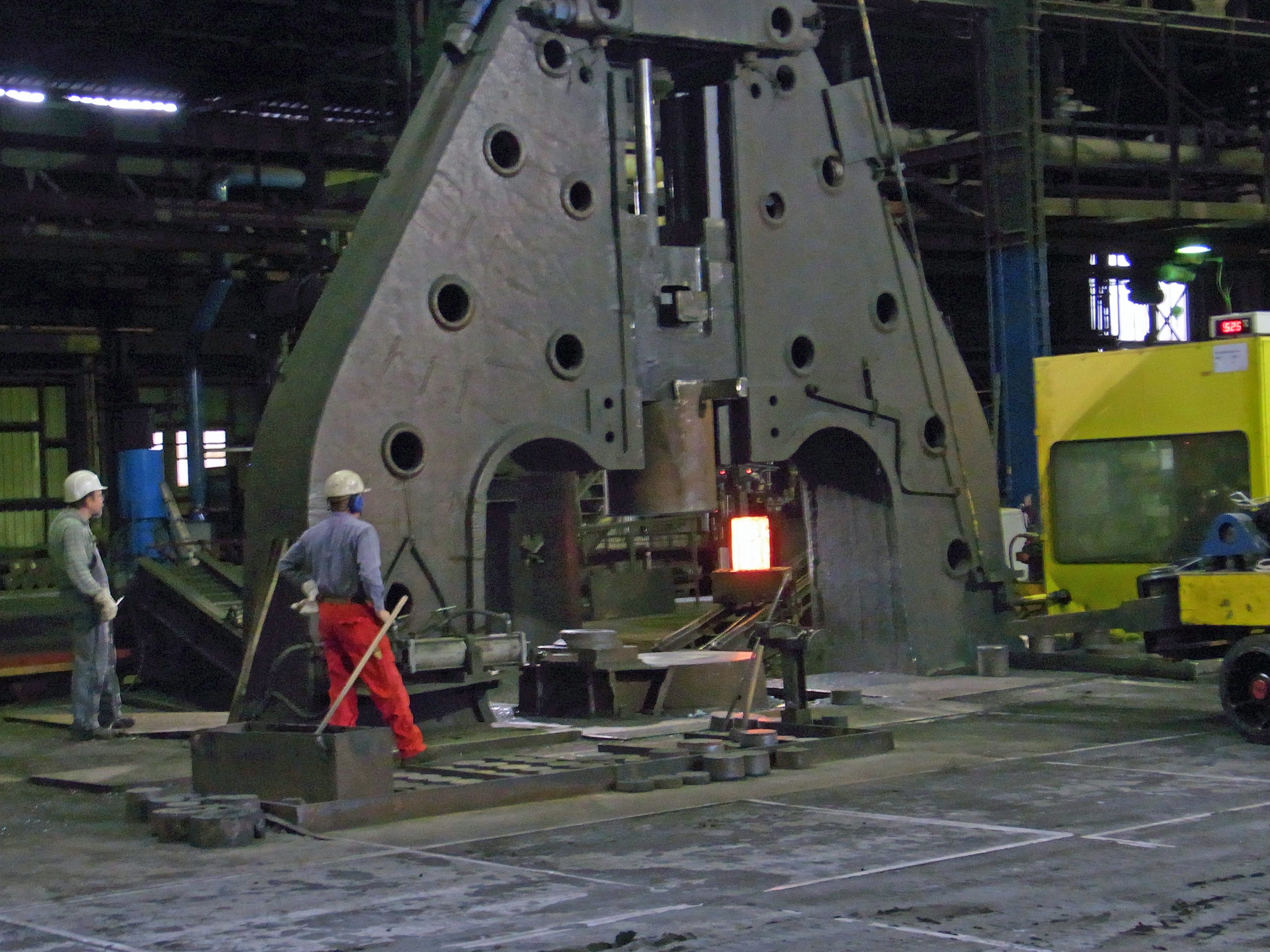

bodog, the entire point of the cashen article is that in something as simple as a knife forging is not making much of a difference in steel of high quality that came hot or cold rolled.
As for the articles you posted, I have seen the forges used to make hi cyclic rate parts. These forges are massive, 25 tons force. There is no knife maker that has a forge like that. These forges shake the building when they hammer. A big building. Again, the forging articles discuss massively large forges. The positive effects from the small forges used in knifemaking will not make that much of a difference in an already high quality hot/cold rolled steel. IMO.

Really, with a 10 lb hammer over a fire? Doubtful. As I said in my previous post. You will not find a knife maker with a forge that equals the forges from the article you quoted. Those forges are used to make parts that withstand millions of hi load cycles, like a crankshaft or a crank rod. Those forges are in the order of high tonnage. No knife maker has that forge in their shop. You are comparing apples(aerospace forges) to oranges(knife maker forge). Your article does not make a case for forged knives.

you pick it. Any article talking about aerospace or automotive forging is not comparable to knife forging. Show me what knife maker has a forge like this(the forge that does engine crankshafts and rods)?

Youre only presenting straw arguments. I've provided several references. Just because one article MAY be discussing the advantages of forged steel in a setting outside of knife making does not preclude the fact that it can also help those in the knife industry. And just because they are operating on a massive scale with massive pieces of steel does not mean a knife forger cannot properly forge a knife, nor does it mean it's not beneficial.
It's hard to debate when the other side says " the aerospace industry uses huge hammers therefore forging a knife is useless" and sticks to it.
No one said forging a knife is useless. The point is that forging a knife to assure that any inclusions or voids in the steel are not there is a good thing. The mechanical advantages over quality rolled steel are non existent. Which is the question listed above. A quality rolled stock steel blade with excellent heat treat will not be any less tough than a hammer forged knife, plain and simple. Quality steel and quality heat treat is the most important factor. Now a laminated steel or folded steel blade can be tougher and those are hammer forged. But now we are talking about a whole different process. My 2 cents anyway.
