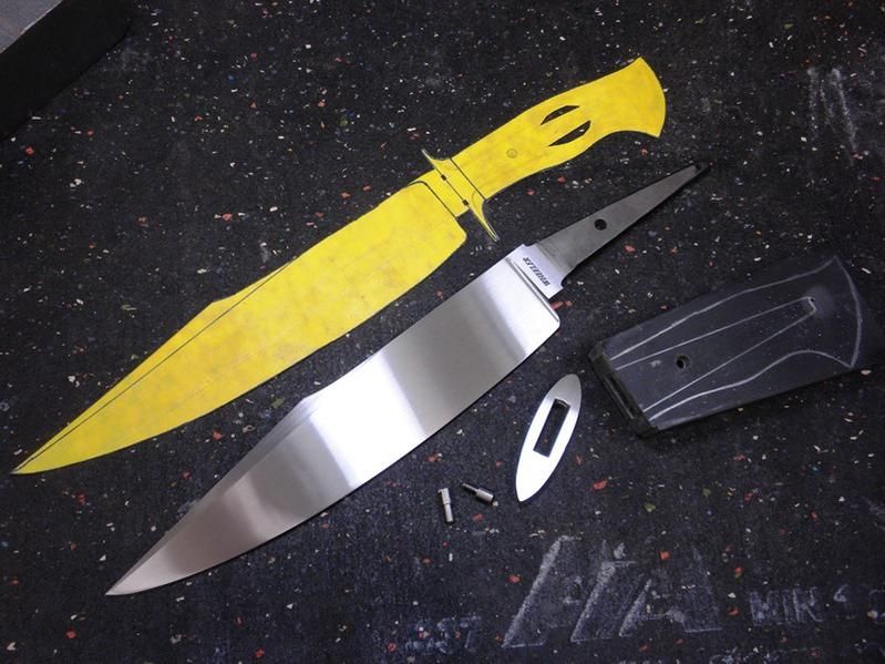

This knife exhibits radical distal taper
We are talking .35 at the guard dropping down to like .27 at the start of the clip
You guys ain't grinding that in :)

But why do you think that distal tapering of the blade can't be ground in like that?
Stop by and I'll show you how I distal taper my knives at about the same differences.
Oh really? Are you absolutely sure about that?
Are you even sure a mastersmith didn't use a *gasp* belt grinder to clean up/bring that blade to its final shape (I'll bet you lunch he or she did - and I'm not basing that on blind speculation, I'm basing it on several years and many hours of conversations with some of the best bladesmiths on the planet today).

Joey, even the 5" kwaikens I make start around .260" at the flat, and taper to .040" just behind the tip.
None of them are forged. Or, at least, very few.
If they're made of a steel that requires a differential temper in order to achieve useable strength at the spine in relation to the edge, then they're differentially tempered. There ARE modern too steels, however, that render this unnecessary, such as JT's favorite CPM-3v. At its target hardness for edge retention, and with proper heat treatment, it will exhibit edge holding characteristics (for certain materials) far superior to 1084, while also being stronger than same - even when 1084 has had a spring tempered spine.

I'm sure you guys can grind in any amount that you want but my point is and many of you have mentioned the same it is easier to forge in that kind of distal taper than it is to grind
So yes I was kidding when I said You guys ain't grinding in that kind of taper
Yes nick grinded on these knives
But I'd say he forged a lot of it in
Like I said I see no differences in the strength of forged vs stock removal and that the only differences I see is that normally stock removal knives do not exibit this kind of distal taper
