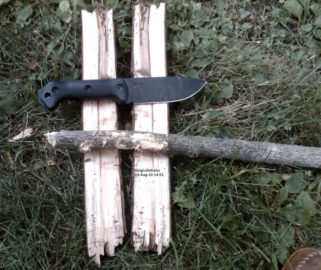

Apparently I'm playing. Decided to try to make my first wooden spoon ... with my Becker BK-2. So here it is in excruciating detail. The spoon isn't pretty but it is functional and the only tools used were:
* Becker BK-2
* Beatin' stick
* Flat chunk o' stump for anvil
* Sand paper

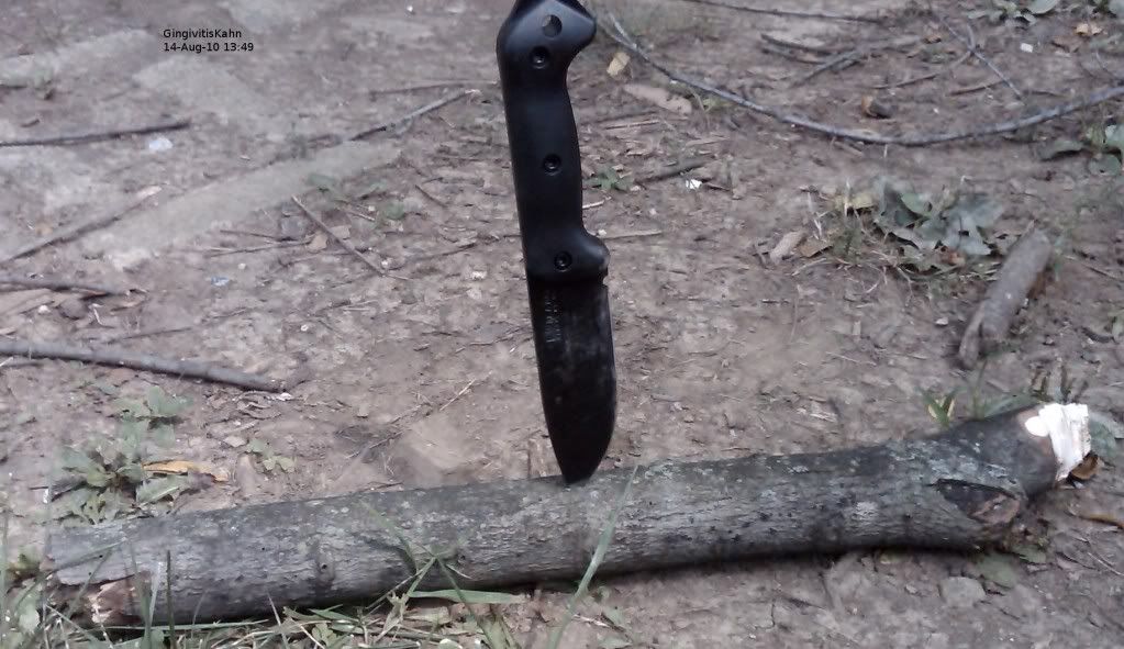

Started by chopping this bit of dead silver maple out of my stick pile. I had a bad angle on it so that's why the chopped end looks as though crazed beavers have been gnawing on it.
Scored above the knot.

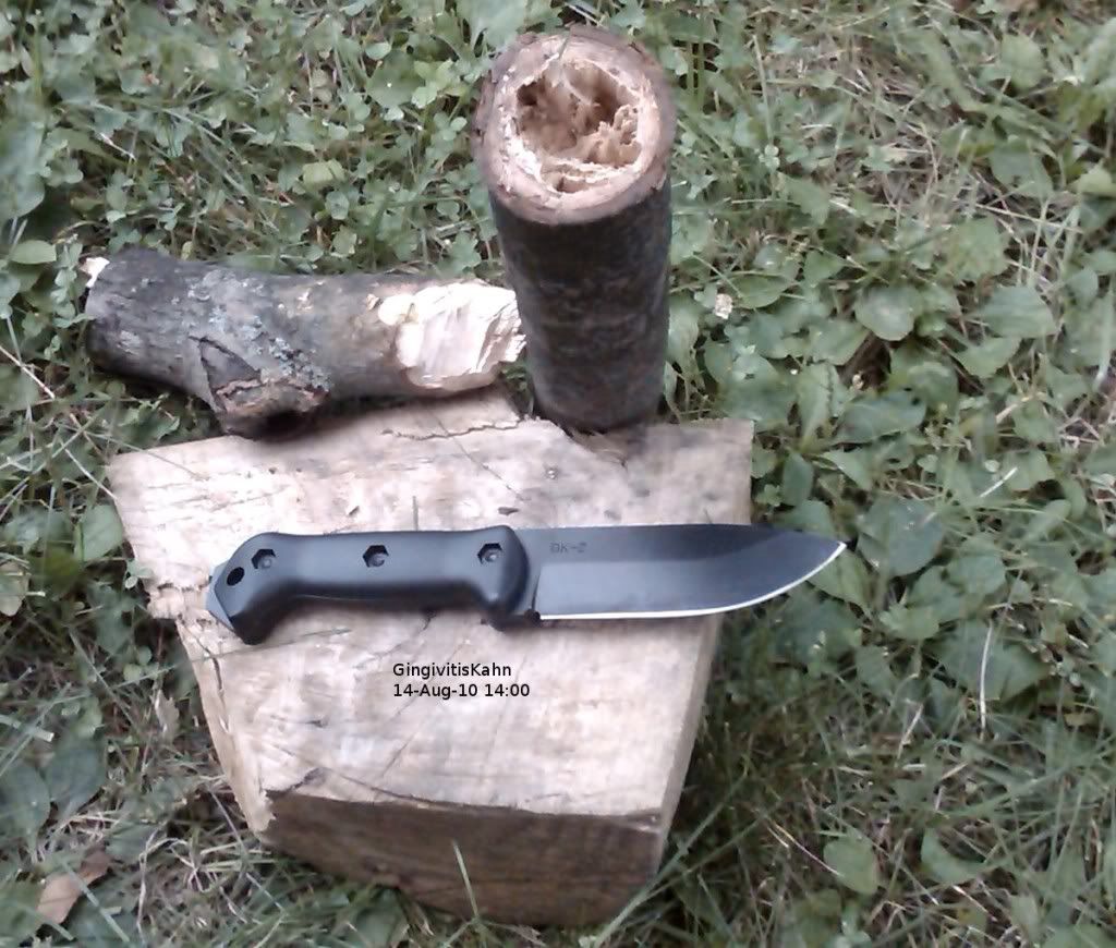

Ruh roh. Now I know why the branch died. Looks like the worms have had their way with this one. Continue or no... Ah what the heck.

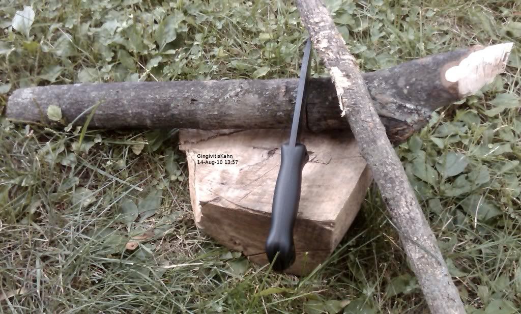

Batonned the branch into mangeagable sections.

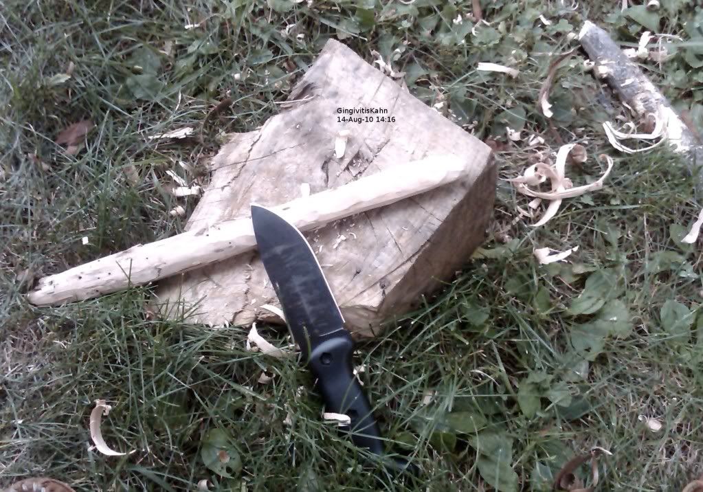

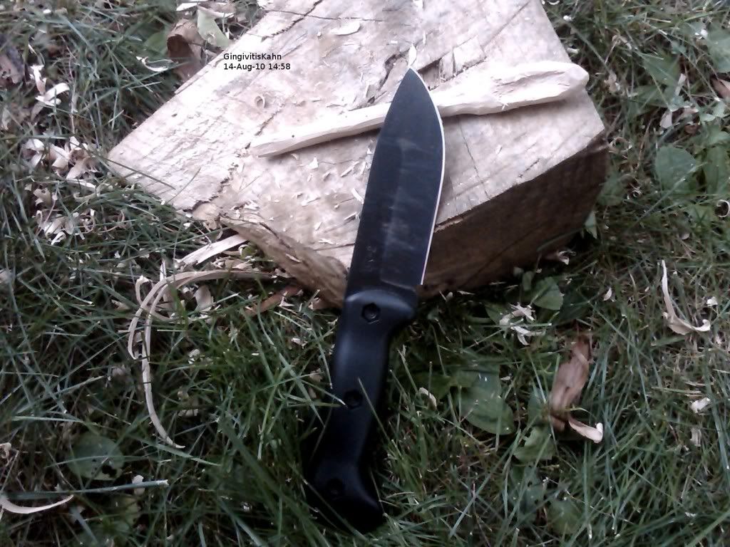

Debarked and roughed what was left.
A bit closer to the final shape...
Tried to figure out how to make the spoony bit. Getting there...

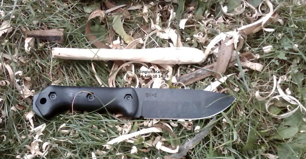

Top down of final product. Wow - my camera is not good.
Slightly better picture of the final product. Had to go back and clean up some weird spots and take a marginally better picture.
Ok - this is not a potential beauty contest winner. Maybe it's a ... character piece. Yeah that's it.
Lessons learned:
1. Leave more wood on the end for a handle and don't trim down to the final shape until the piece is more nearly done.
2. I've got woodworking blades but the BK-2 is fine for detail work (even if my details kind of suck :p ).
3. Ants like wood shavings.
4. My camera really stinks.

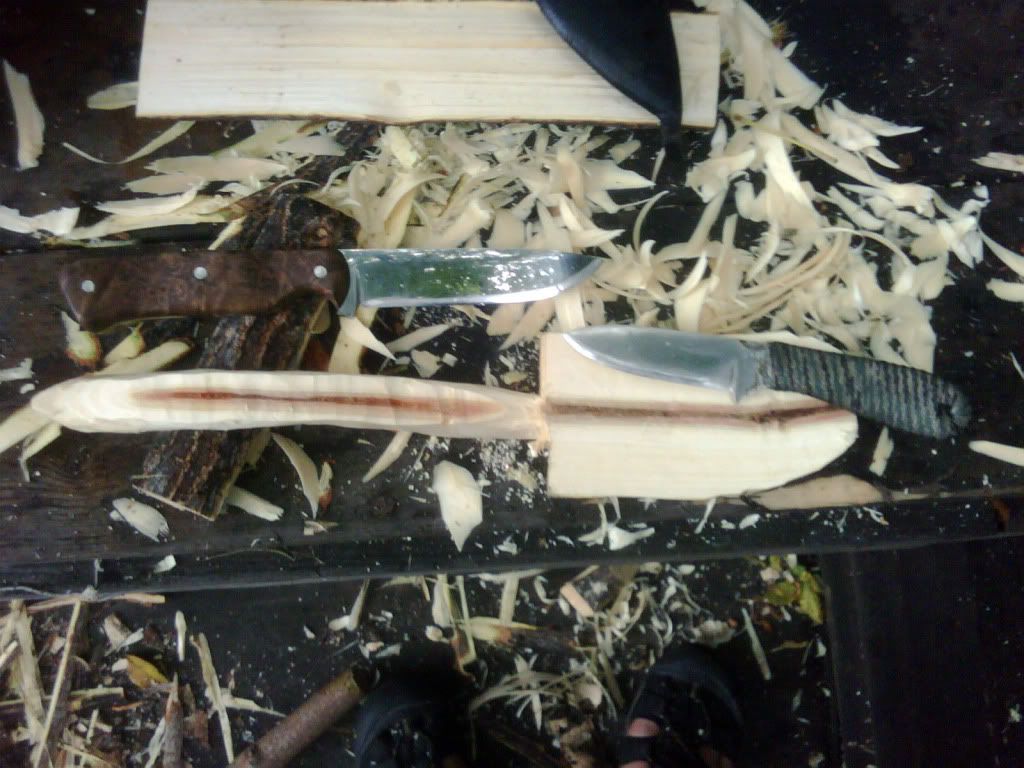

Ok I have started my contest spoon, and its big. I have plans but I am not divulging them till its done. I will add to this post as I go, but I have less then a week to finish it up.
Here are my starting pictures
the piece of nice wood broke so I cut down one of the small box elder trees beside the house that are crushing the eve trough.

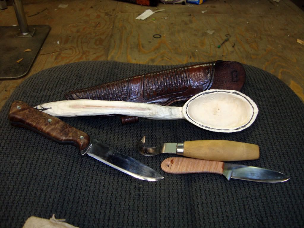

Tools
Cheap folding saw
My KH Khukhuri
My homemade bushcraft knife
A little EDC fixed blade I made
Not in picture
Lee Valley Hook Knife
assorted sandpaper
3/16 drill bit
Bow for drill bit
With a little work

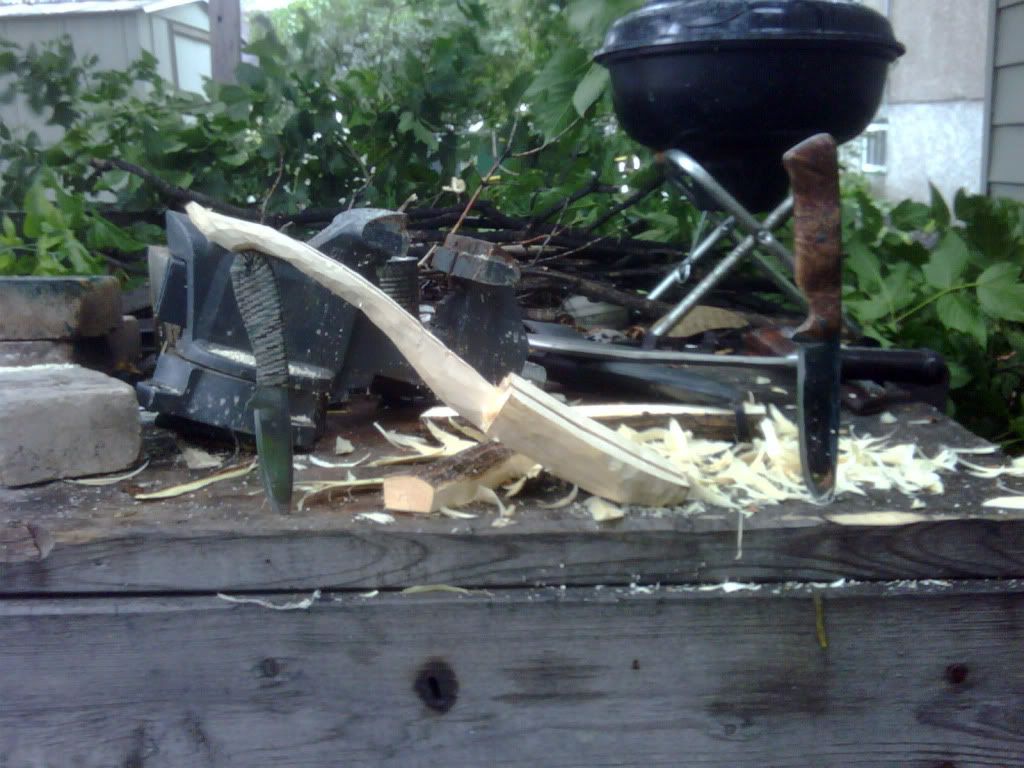

I have a fair amount of shaping to do yet but I got rained out so I wont be back at it till tomorrow. As for tonight I am wrapping the handles on both the khukhuri and EDC in leather.

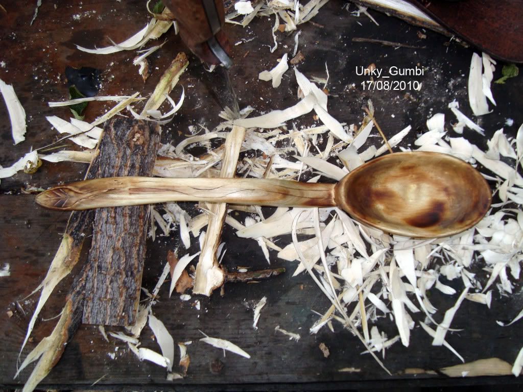

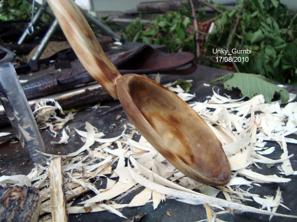

So my spoon is done, with 3 days to spare before surgery. I went with a large spoon at 12.5" long and a 4" bowl. I was going to make it a slotted spoon, but my drill bit and bow idea just wasn't working out so I skipped it. My carving up the handle didn't work out to well either, but I do like the leaf at the end of the handle. Is it good enough to win? I doubt it, but I had fun making it so that was more than worth the price of admission. Finish is a combination of lots of sanding, soaking in strong tea, a bit of scorching over a fire, tung oil and beeswax. Now to make a matching salad fork:p
