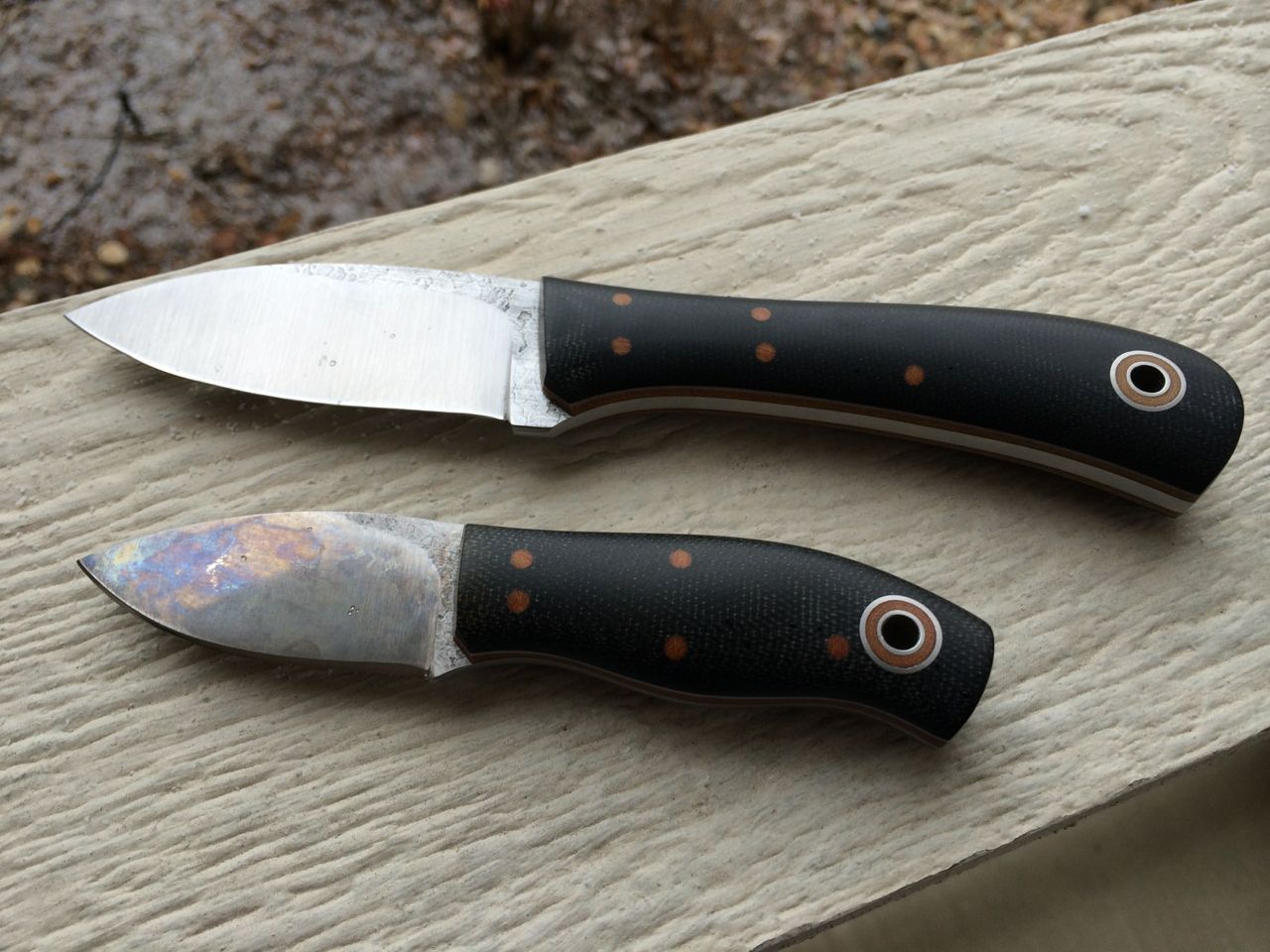

This Runt for example is primarily from apples and oranges. The oranges give the nice blue.

Exactly; make a nice fruit salad. Your patina although pretty will also help protect the blade from additional corrosion.

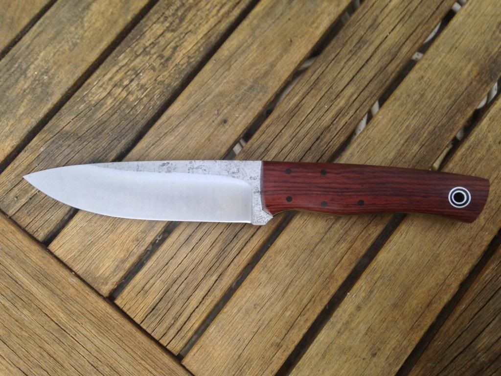

Here's my first. I feel like it's impossible to have only one Fiddleback...they're addictive.
