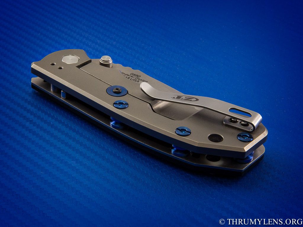

I spruced up my 0550 with some new hardware:
Looks great! I was thinking of ordering some for myself. Do the screws sit flush tho? From the picture it looks like they stick up a bit. Wouldn't be a deal breaker for me, just curious.
Looks like they're not quite flush.
