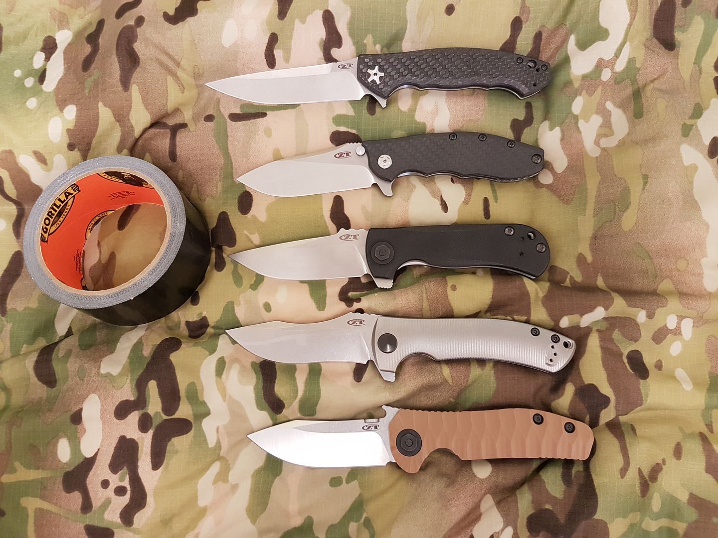

Follow up...so I beat on the spine of the opened blade while holding in my hand like a normal person. The only one I was concerned about was the ZT 0630. I used a roll of 100mph tape and beat on it as hard as the video. No failure (thank goodness). I even did a couple "accidental" whacks on the underside of the table in my room.
So, I call B.S. on the pansy method of testing lock failure. Limp wristing isn't a valid testing method. I will say that the flipper knives do offer an extra measure of security by using your finger to secure the blade open even if "whacked" on the spine disengages the liner/frame lock. I think many are really over-analyzing the failure without addressing actual application.
