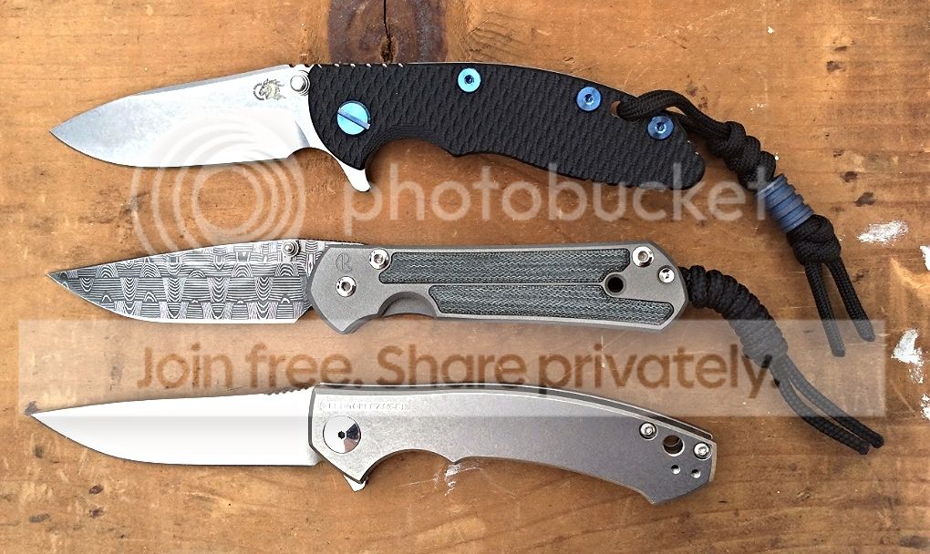

(And yes, I love my 0450.) Here's a family photo w/ that clip installed:
