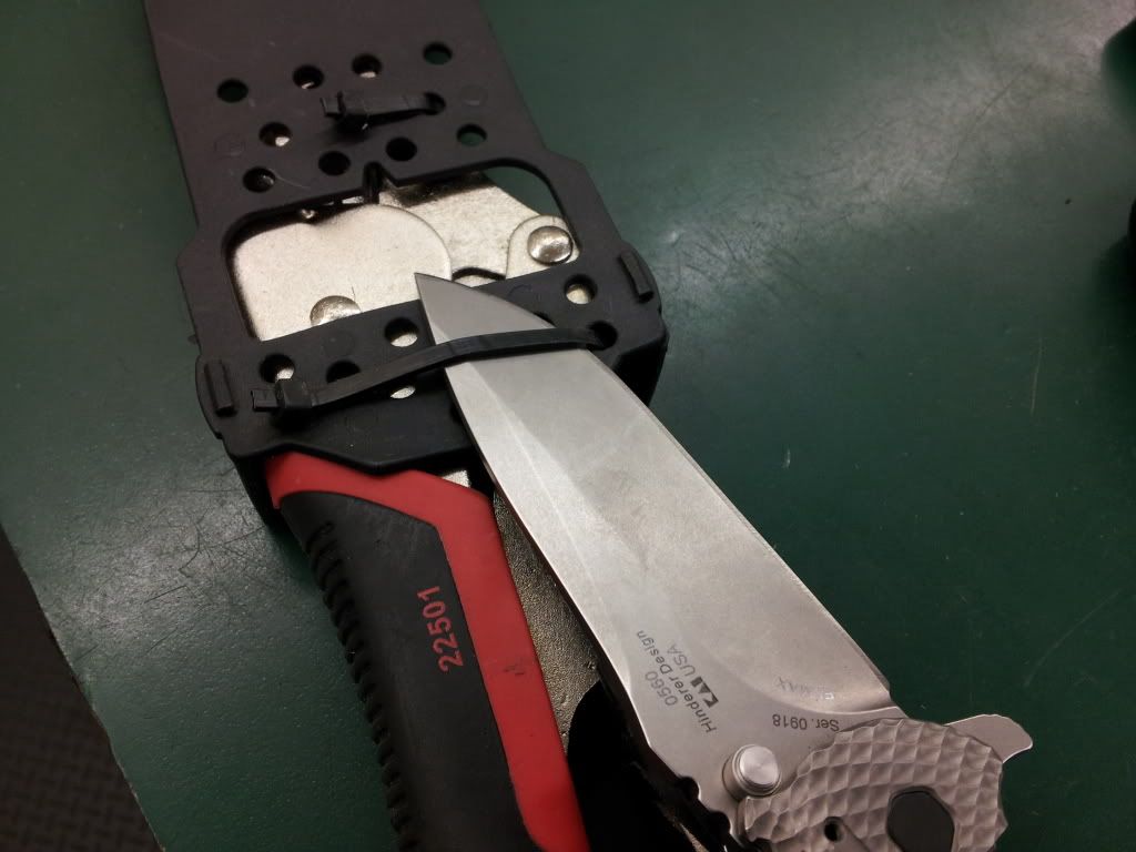

ZT0560 edge DESTROYED by plastic zip tie
Zip ties are easy to slice thru, but a lot of times I've watched people slide the end of the knife under the tie then apply a little sideways motion as well as forward motion. This puts a lot of stress on a small section of the blade edge. I've done it myself.

Looks to me like OP tried to twist his knife into position so that he could then cut the zip tie and chipped the end of his blade in doing so....I've chipped/snapped a handful of blades this way. I would bet a nickel this is what he did.

When cutting a zip tie, you're knife makes a small slot just as you start applying pressure - and the pressure pinches the slot together - it compresses like a pair of pliers. The amount of force pinching your knife edge is INCREDIBLE! Add to that the malleability of the material - it actually conforms to the surface of the knife edge and holds tight - making it even harder to push through.
Only three ways out:
1) Reverse the motion - back up and save your blade. Use something else instead.
2) break on through and perhaps break your knife edge at the same time
3) Release the pressure by TWISTING your knife and DEFINITELY chip your knife edge all to hell.
It only takes a couple of attempts before we all swear to go with #1 forever and ever. :)

It is far too easy to damage the edge when cutting large zip ties (when I say large, I am talking about any that are more than about 1/8" wide max). Mitigate the risk and just use the right tool for the job.
This is the exact kind of zip tie and way I cut it. Yes I was twisting as well to "pop" the zip tie. Done it 1000s of times.
Yeah, that'll chip out a blade. Think about it, you're applying a levered force to only the edge of your blade. It'd be the same as putting your cutting edge against that counter and twisting into it as hard as you can. Honestly, 1000's of popping zip ties... I'd say that ELMAX held up like a champ.
If you're gonna use it like a prybar.... get a prybar.
If you put a little more of the blade through and rotated the knife counter clockwise (so the tip is resting against the fastener end and you slice through the tie on the right) you'll be using the blade edge in the way it's designed for.
