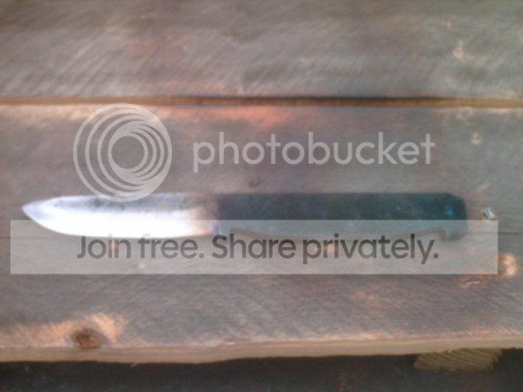

$0.75 Start to finish bushcraft knife in less time then it takes to get a pizza.
This was my first knife. I made the handle and pin materials. I heat treated it in a small forge that I built.
The tang is tapered and it has white liners.
I used a hf 1x30, files and lots of sandpaper. Took far longer than most makers take to make 10 knives, but though it's not perfect, I tried to keep quality a priority. It has held a fantastic edge. 1084 really surprised me as I thought it would be a fair bit lower in edge retention than 1095,but I haven't seen any significant difference. The edge is super acute. Can't baton with it though! ;)

Thanks, it's just burlap, dye and resin. My only point was that you can turn out good work for little investment, just takes some time and tenacity.
A lot of bushcraft knives are 1/8"-5/32". If I can break 1/8" I'm doing it wrong. I like to play with knives on the rare occasions when I can break away from town. I have a beater 1/4" survival type knife and it's fun, but far from practical.

A2, O1, 52100, 1095, 15N20, who cares, pick one. Forget about heat treating it yourself. You have more important things, like ergonomics and geometry to worry about first.
Any known blade steel is going to make a decent knife, given proper heat treat and geometry.
Personally, I like all the steels I listed. I've been using A2 and 52100 most though. CPM20CV or S35VN for stainless.

I was thinking of doing stainless blades if I were to suggest actually buying materials for knife making. Is it any different to work with besides not rusting? Any more heat issues I would have to deal with? Do I leave all knives dull before heat treating? Sorry for asking questions still looking through the information Count posted in my off time.

You will have to send stainless off for heat treat as it requires specific controls and I believe cryo. I've done several in stainless. Very easy to work with pre heat treat. I took my all the way to a nearly ready to sharpen edge. After heat treat, they just needed to scale removal and sharpening.

Okey figured out my main issue with the knife besides lack of knowledge. I never annealed the file at all it was still rock hard which also explains why it was hard to work with and did not bend. I annealed the handle portion of the knife and I am now working on shaping it. I am probably going to do a hardwood handle pinned on it.
