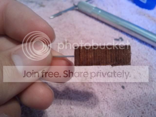

Working on the stacked leather handle now. Doing a dry run before I glue it up or to my fingers with the CA. I will post pics in a bit.
Time to turn the record over and pour another Cuba Libra!
-Xander
Well here it is all glued up and just about the right length! Hopfully I can carve and turn it down to final shape easily.

Ryan, it is already off the mandrel and I started truing up the sides to prepare for turning it down closer to shape. It fits perfectly onto the tang of my knife. I polished the mandrel and the two plates with some car polish to act as a release agent, that and a bit of heat from a Bic lighter I was able to pull it right off. The CA didn't penetrate as deeply as I hoped so its sand and add more glue, sand and add more glue. We'll see if everything works out in my favor, so far so good.

Yeah next time I am going to start the stack much closer to final size, sanding this has been actually rather difficult. I am going to cut the grooves into this handle like the original but will do so after final fitting to the tang because the stack is getting quite delicate the thinner it gets.
