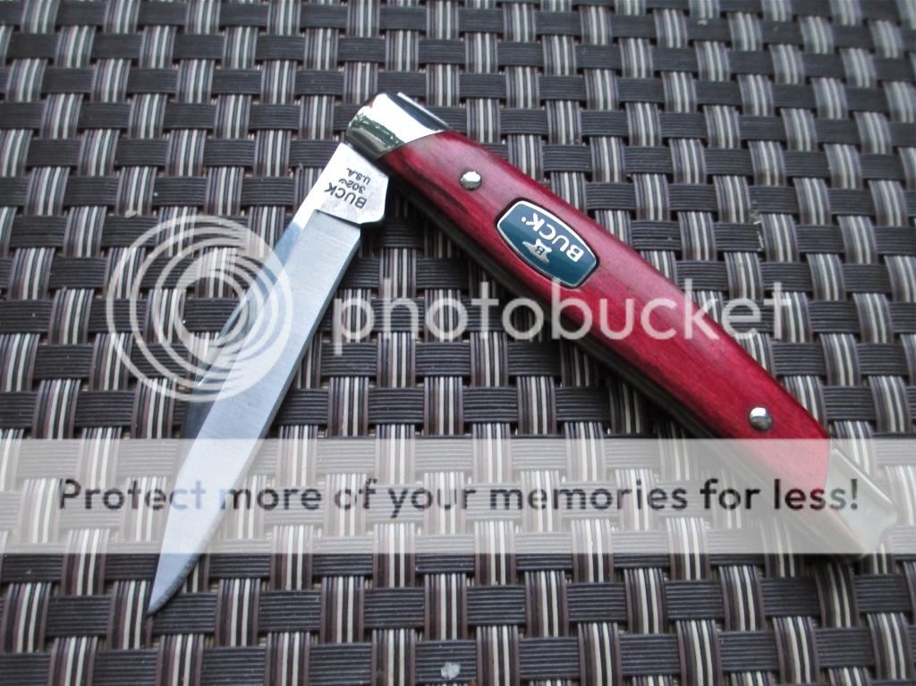

The knife below is full flat ground with a slight swedge.
IMG_2871.jpg~original
Though a nice knife, this is not a full flat grind. This is a flat saber grind.
I find these tend to crack apples, wedge in wood, feather curls can crack easier and other small annoyances that are alleviated by the omission of the flats.
This omission also can result in a blade that is thinner Behind the edge, which slices better.
Thanks. Yes I agree, not the best for tackling food prep etc but I included it as an example of a Buck Solitaire I like and as it has the same frame as a 301 I believe? It was sold to me as a second from the US but I really cannot find anything wrong with the construction, especially for the 22 USD I paid for it ;) I'd prefer non sabre myself but I will say that even Buck's 'modest' 420 is very nice working steel and very keen, their better stainless must be a treat:) I have a fixed Buck 5 Gen Skinner that's flat ground, incredibly thin and just a great all round compact outdoors knife, fishing, food prep, hunting if you do,firesticks- would never part with it:cool:
