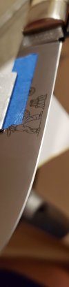

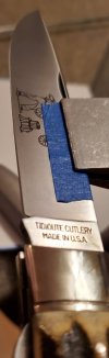

After sharpening Kiteman72 's 23 that he held his give away with, 25 seems a little steep. Members here felt that my going to 20 dps would be fine. I've found that 20 dps isn't too shallow at all. The only place along the blade that im really having to remove material is at the tip and the first 1/4" from the tip. I have a 17 dps slot on my jig. And I could have gone with that in my opinion. When I'm done with all 7 progressions, ill try and capture a picture and post it here. Re:gecs edge. Not sure, but I've watched it done, 3 different times. They are put on by hand on an 18 or so diameter wheel. So it probably can vary. The gecs are so thin behind the edge that at 20 dps, the bevel doesn't stand out as being too shallow, if that makes sense. The pic will help clarify what im trying to say. When I'm done of course.....the lansky is not a fast system, but it works for dummies like me and its affordable.

Really hard to capture, but here is 4 progressions of diamond stones at 20dps on the 23. Extra coarse to fine. I have 3 Arkansas lanskies yet. This is about 2 500 strokes.
I’m able to zoom in on your pics, you do nice clean work. Usually with a new knife I don’t use extra coarse but if you’re changing the angle some I guess it’s needed. I was finally able to buy a 23L and can’t wait for it to arrive. I’m hoping I can compare your work to the factory edge but if I can’t no big deal. Thanks for sharing your sharpening skills and if the pull is not to bad on my 23L I’ll keep it and try your technique to sharpen.
