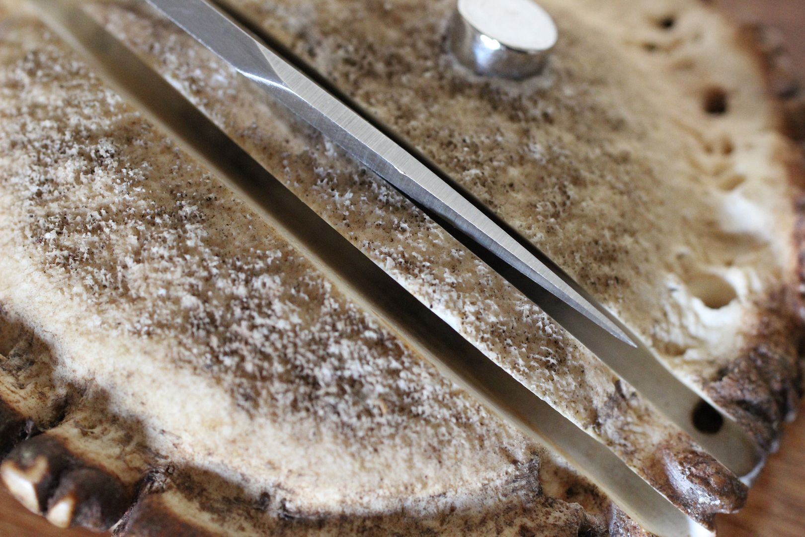

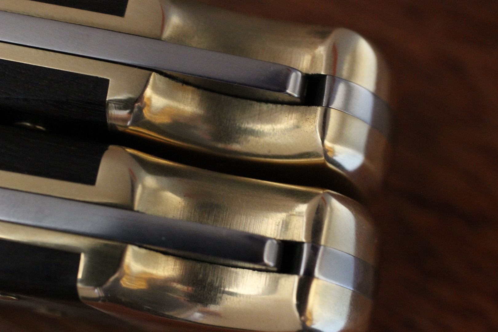

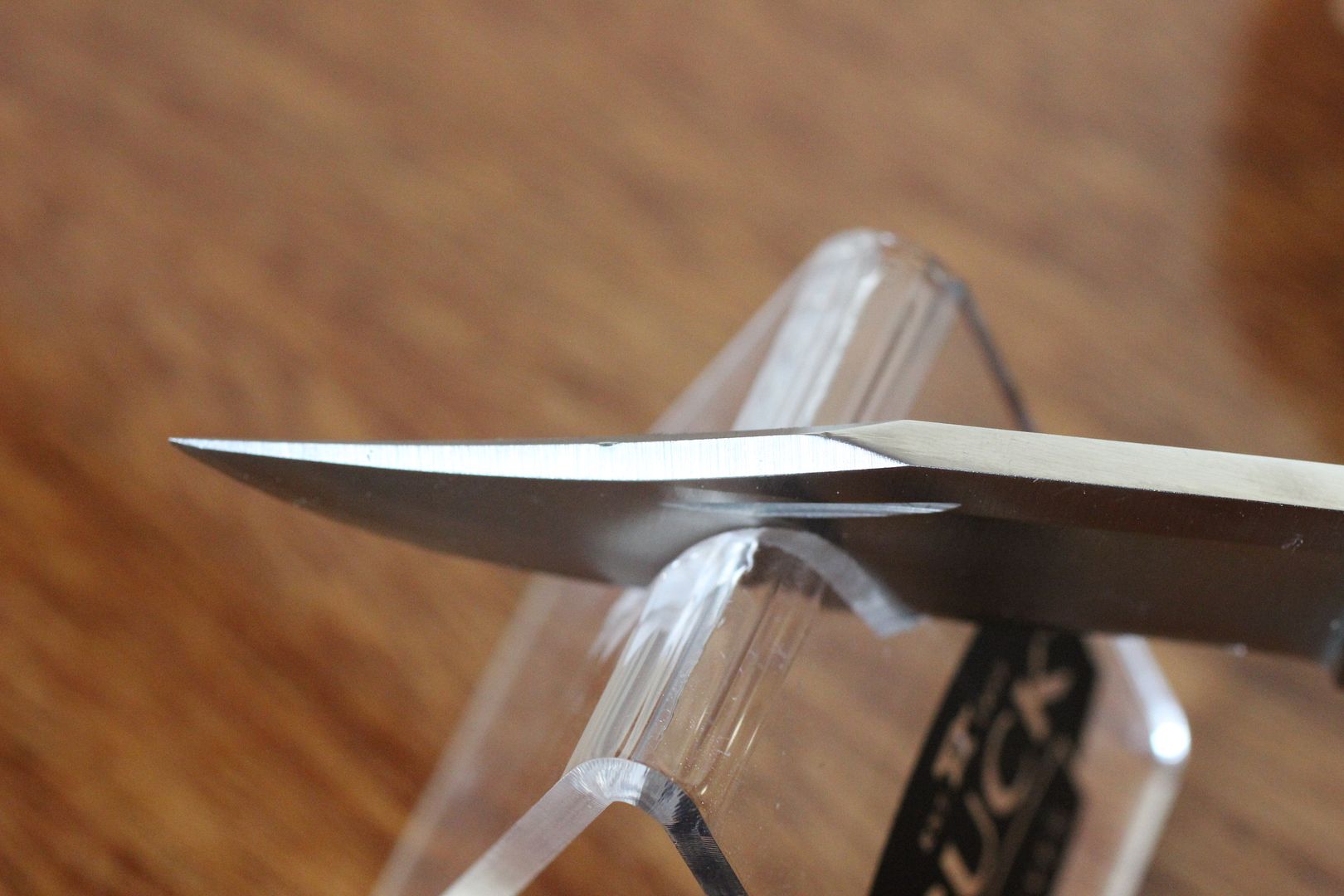

Flush it out with some warm soapy water, and work the blade open and closed, a lot. Put a little pressure to the left side while you work it. The blade should find its way toward center at the pivot which should solve the closed centering issue.
There's a bronze bushing insert in the blade pivot. The blade should be turning on the bronze insert, not the brass pivot pin so the blade should walk over to center.
If it doesn't right itself, send it back.
At the (low) risk of scuffing the blade, while working it open/closed, you could put a .003 or .005 feeler gauge blade between the frame and blade on the tight side to move it over as well.
Piece of cake, and won't cost you time and postage.
