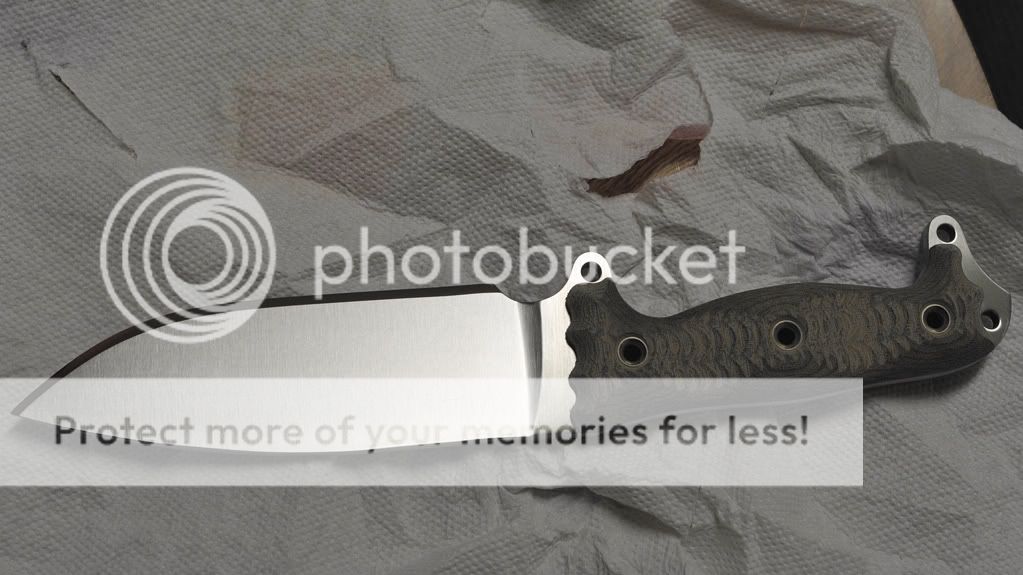

Well, i went ahead and got started on my TGLB. So far, the reprofile has been INSANELY hard. Taking a 40 degree convex down to a 30 degree flat edge is just about the hardest sharpening i've ever done.
it already looks very nice, and i haven't even gotten to the polishing stages yet.
I am starting to wish i'd gone with 40 degree inclusive just because of the massive effort it has taken to remove that much steel. I have a feeling it's going to cut like a laser when it's done though

Okay, i can tell ya this... DO NOT sharpen the tip on the TGLB to 30 degrees
More info to come perhaps, pending reply to an email
Thats not good news :(

I am REALLY sorry this test did not work out for you. There was a reason back then that I thickened the edge towards the tip.
Kevin
On the happy side, Busse service has once again proven to be absolutely top notch.
Got my email from Lexi this morning. She didn't even call me a dumbass :p
This is my fault, and i make no excuses for it, but the Busse family is standing behind their product.
Yeah, there is pretty much no reason to thin the tip. I like the tip thick for prying and I only thin the edges. When I sharpen, for every pass I do on the tip edge, I do probably 6 passes on the edge.
